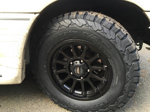

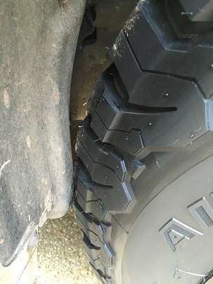

3) New Tires and Wheels. Wheels: Moto Metal MO971. Tires: BFG KO2 275/70R18. I wanted tires that would stick out the wheel well about 1/2" - 1" and this setup did that. But I get some rub. After reading many posts I did not expect any rub, but I think this could be due to the wheel offset. Pictures of the rub below when doing a 90 degree turn. They also rubbed when on the freeway and I went over a small bump in the road.
Since I have less than 10 miles on the tires - should I swap for smaller tires, or try to make them work? Not sure what would be needed to make them work though.

Couple more pictures of the wheel/tire combo if anyone is interested.
I just reformed the plastic with a heat gun, which someone on the boards referenced somewhere in here. At least it looks like your tire is rubbing on the plastic fender liner like it was on mine.
Thanks! Since you did that have you ever had a problem with rubbing, or when going over speed bumps, etc?
Just a tiny bit at full lock, but nothing like it did prior - I just flattened the plastic as much as possible, it no longer has that hump shown in your pic where you rub, and it doesn't rub on the little bit of metal at the bottom, it only rubbed on the plastic. I had the heat gun a little too hot and melted a small portion but nobody really looks in the wheel wells anyway.....

I still get a bit of rub when I hit a dip in the road, but I set the strut stiffness on 'sport' or the setting just short of sport and I have not yet had fender rub (less than a week though), but I likely would on a big pot hole since the suspension on these travels quite a bit compared to other vehicles.
