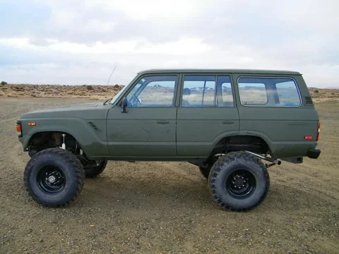

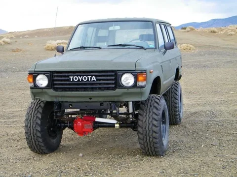

As requested, here is my wagon. I have had it for about 3 years. I have always liked FJ40's and (forgive me) CJ7's. But there was never enough room for the family. After an aweful trip down to the Hammers where I broke everything from my frame down on my Jeep. Literally had to winch it out and ontoa trailer. I decided to get a new rig rather than spend to upgrade. So I searched and found a totally straight rust free FJ55 in Bonners Ferry, ID. After getting it home and driving it around I just couldn't bring myself to wheel it. It had new paint and the interior was almost new. It was just too nice to go out and beat up. So I sold it. Made money on the whole deal. The guy who bought it, wanted it before I got it, he just didn't want to travel all that way to get it. So I took the proceeds and bought the 60. Its been 3 years of sitting in the driveway in different stages of build. Some trips to Deans for axle and driveline help. A couple of trips to Rynobuilt for suspension and finally a trip over to Hollars for the shake down. It was way more of a project than I wanted to get into. Its hard to stop once the ball gets rolling. One thing always leads to another. But most the hard stuff is done. I had a lot of help. So here are some pictures. Cruiser 030.webp

Since this last work has been done. The dirt you see in the picture has been the only dirt its been on. Yeh I need to get out. Its been too long since I have been wheeling.

Did you move the front axle forward?
What is the running gear that youve got in it?

Thanks.I didn't move the axle. The springs are OME. I have a Chevy 350, TH400, Dana 300 case with AA and gears, Dana 60 front, and Dana 60 rear. Both ends have ARB's. I can get some pictures of the exhaust. I would love to get a SOLIDOFFROAD rear bumper with tire carrier. The guy who is MUD from CO. I love his rear bumpers. The front bumper will be home made because I want to do something a little different. Tubing with a winch plate that stays below the head lights. I saw one on a rig a few years back and gleaned it off of the site. I might go up to Blazen Offroad for the sliders. I think another local 60 guy had them do his and they looked pretty nice. With the economy the way it is, its all a ways off though.
