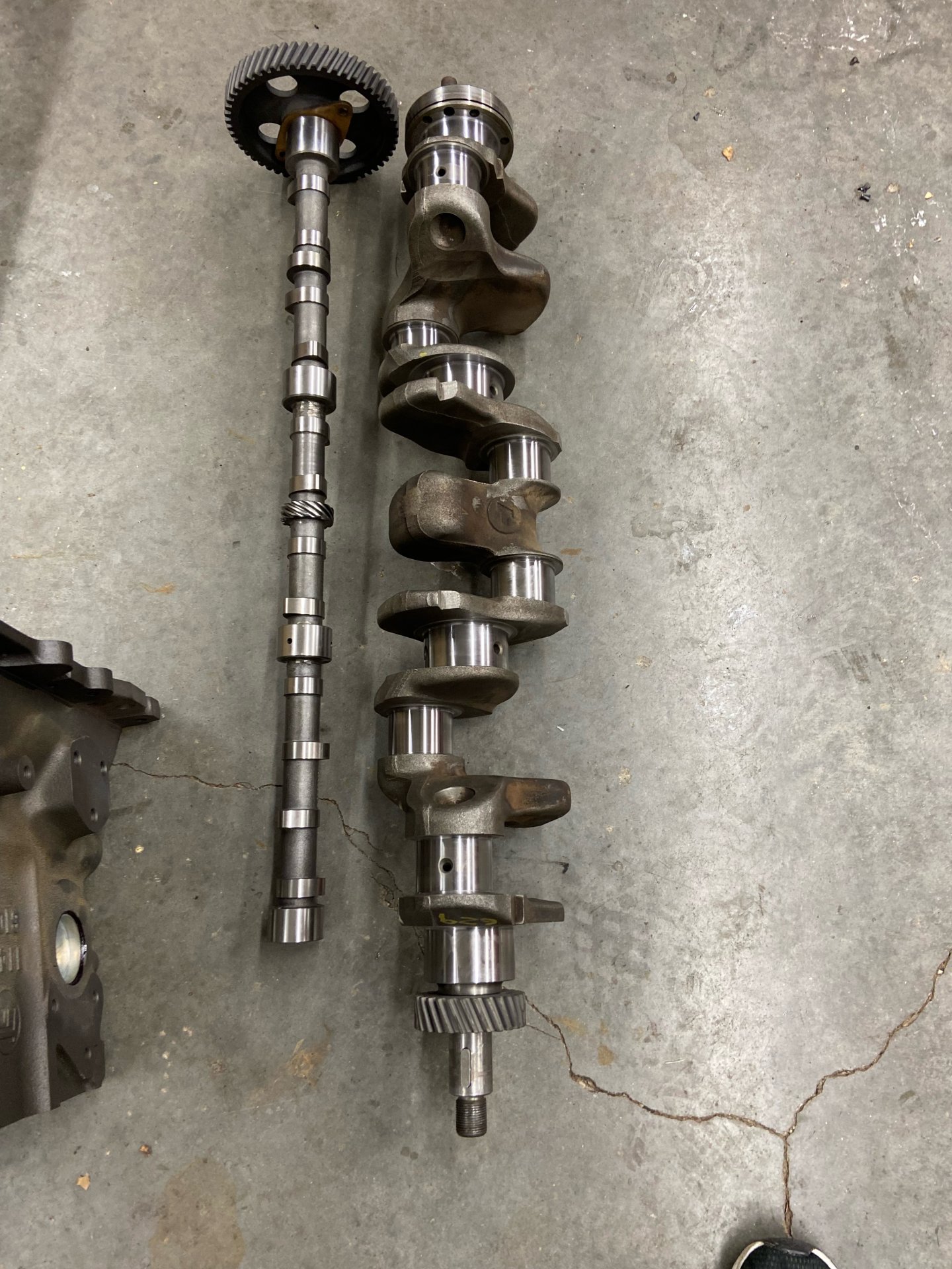

The main bearings have oversized thrusts. So get right ones and should be putting Humpty Dumpty back together.

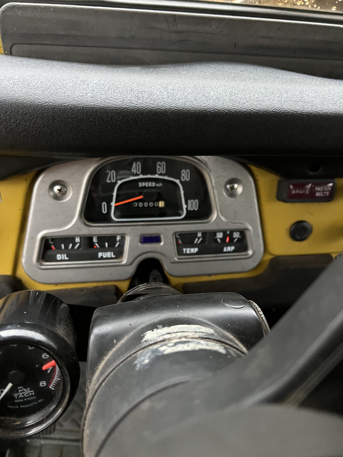

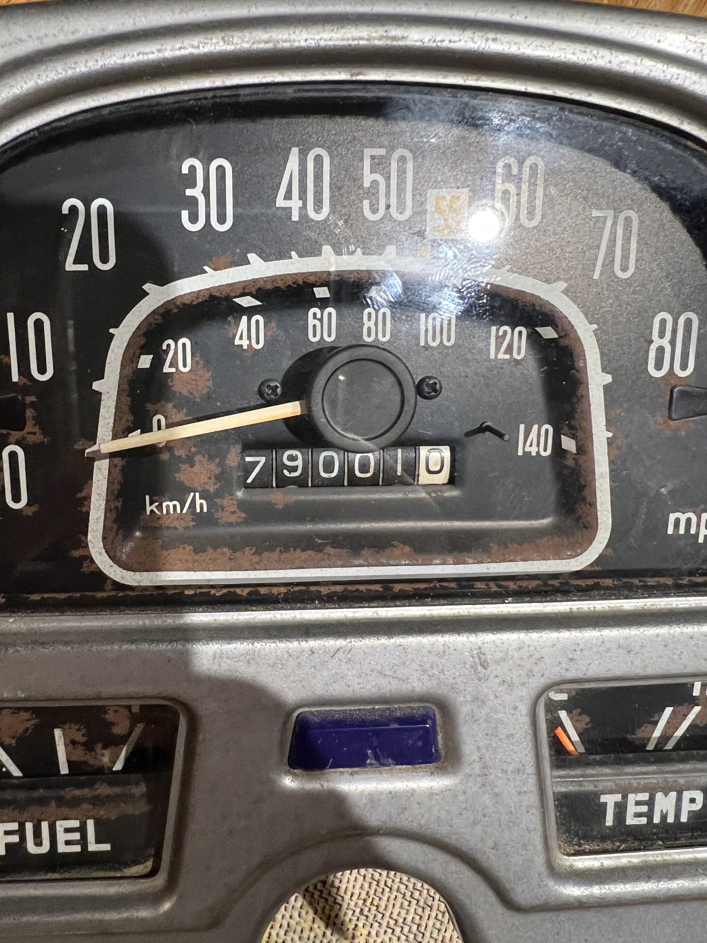

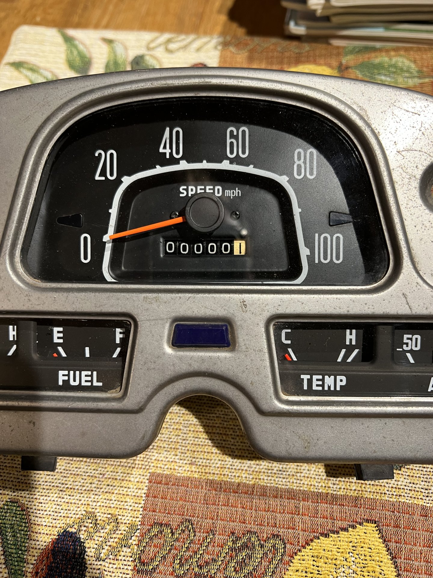

Got the meter back and odometer fixed, gages checked and cleaned up connections. Odometer set to zero to match miles on engine. Different plate too with less rust. Will referb the old one at some point (like the 55 mph marker one the original) , but the donor one looks better with less rust for now. Was quoted close to 800 to have someone clean it up. Pass.
Engine should go in end of March/First of April. Lifters were a pain to secure. Engine was .05 over bore and crank was .025.

(Pictures before/after referb and fixing odometer etc)

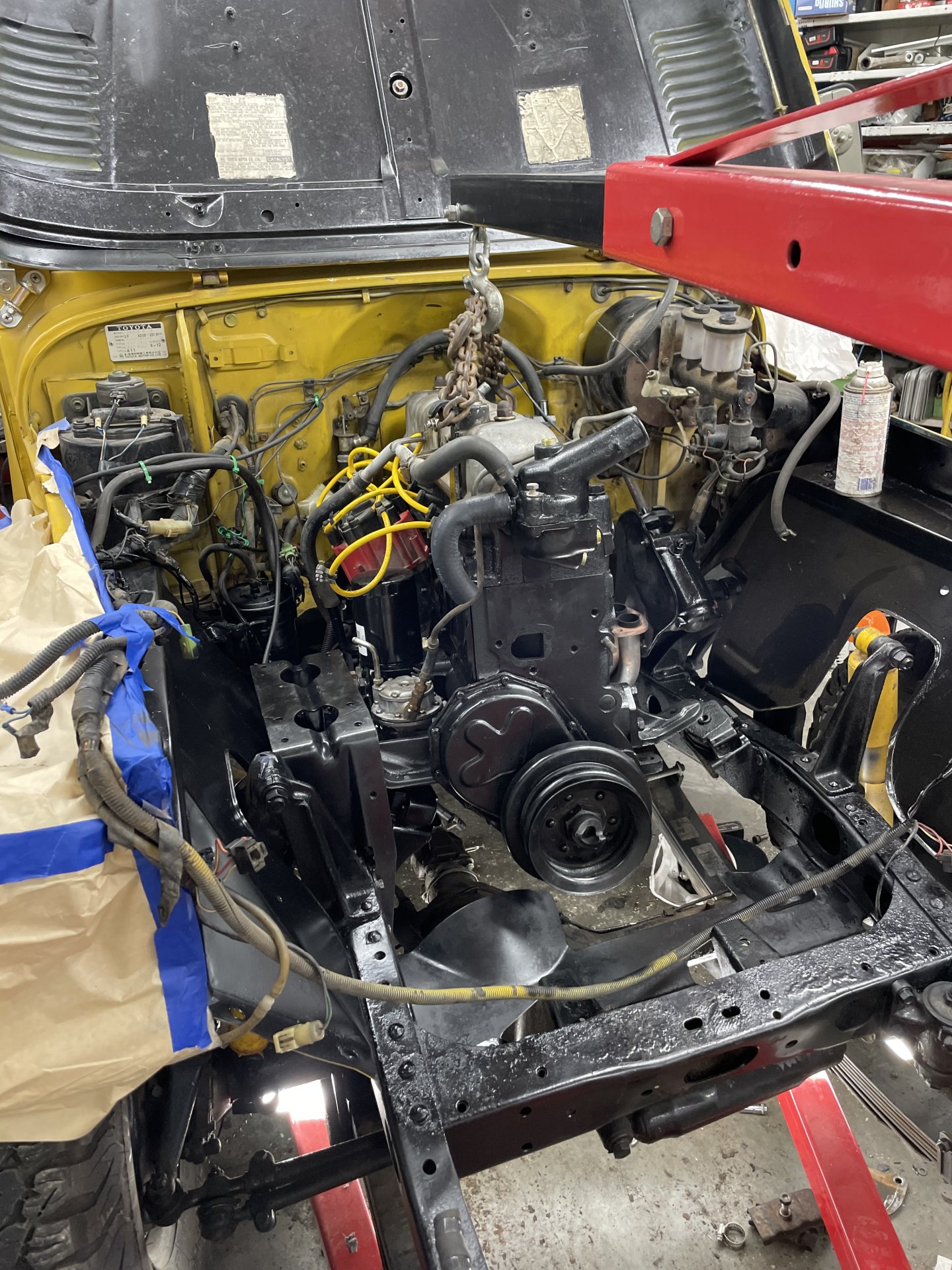

Finally, yesterday was the day for the engine removal - some bolts would not come easy. All and all about 3.75 hours to remove the engine. Panning for goodies too (not really ... did find nuggets in the oil pan - just a fan of sarcasm).

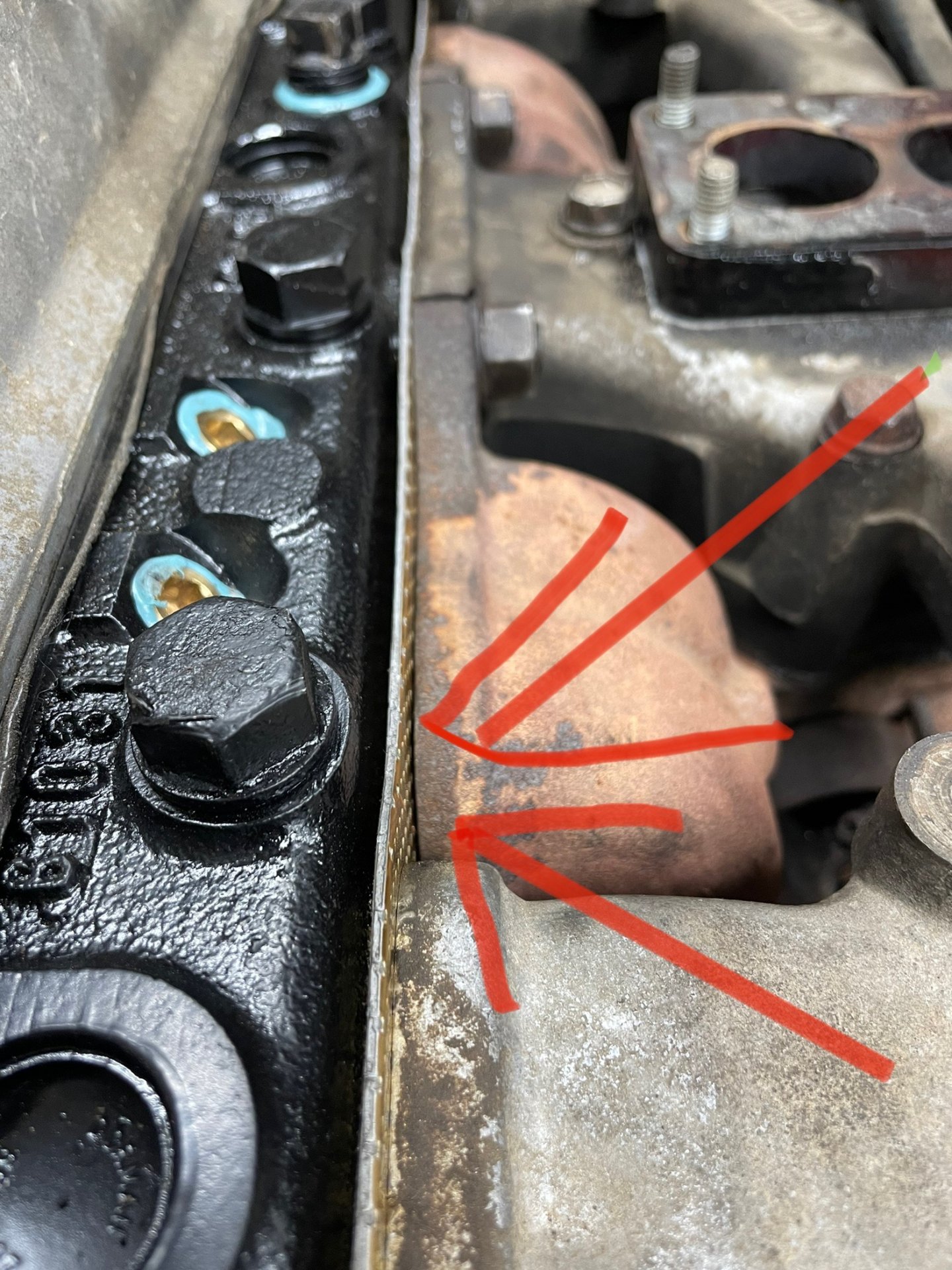

Well a few weeks later...Installed rebuilt 2f engine along with clutch stuff (master/slave cylinders, etc). waiting for the water pump etc. PO installed weber carb and threw the accelerator linkage away (weber uses cable link) - chasing parts to get so can return to original carb. Will put cleaned-up valve cover on once done chasing rabbits down the holes.
Discovered manifold warped. Also re-discovered, I like beer in these moments.
