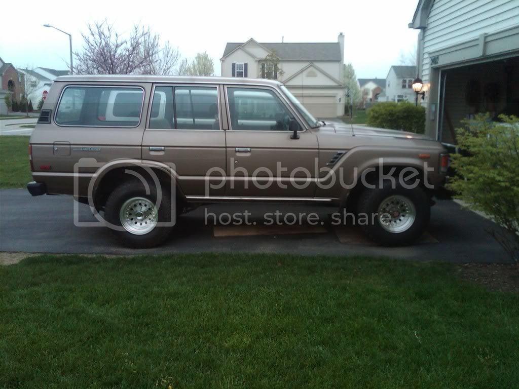

Over the winter I installed a Hell Creek Suspension lift on the 60. I got a good deal on it, it was under a grand shipped. Below are before and after pictures.

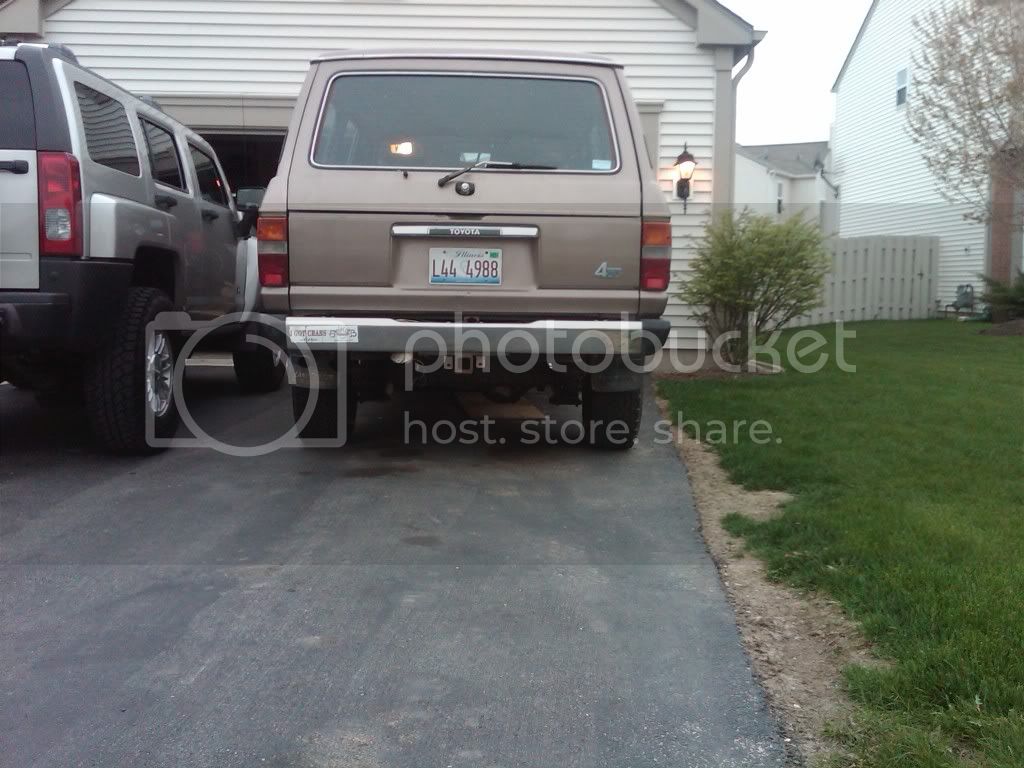

Before lift nicely sagged, front pretty much sitting on the bumpstops.

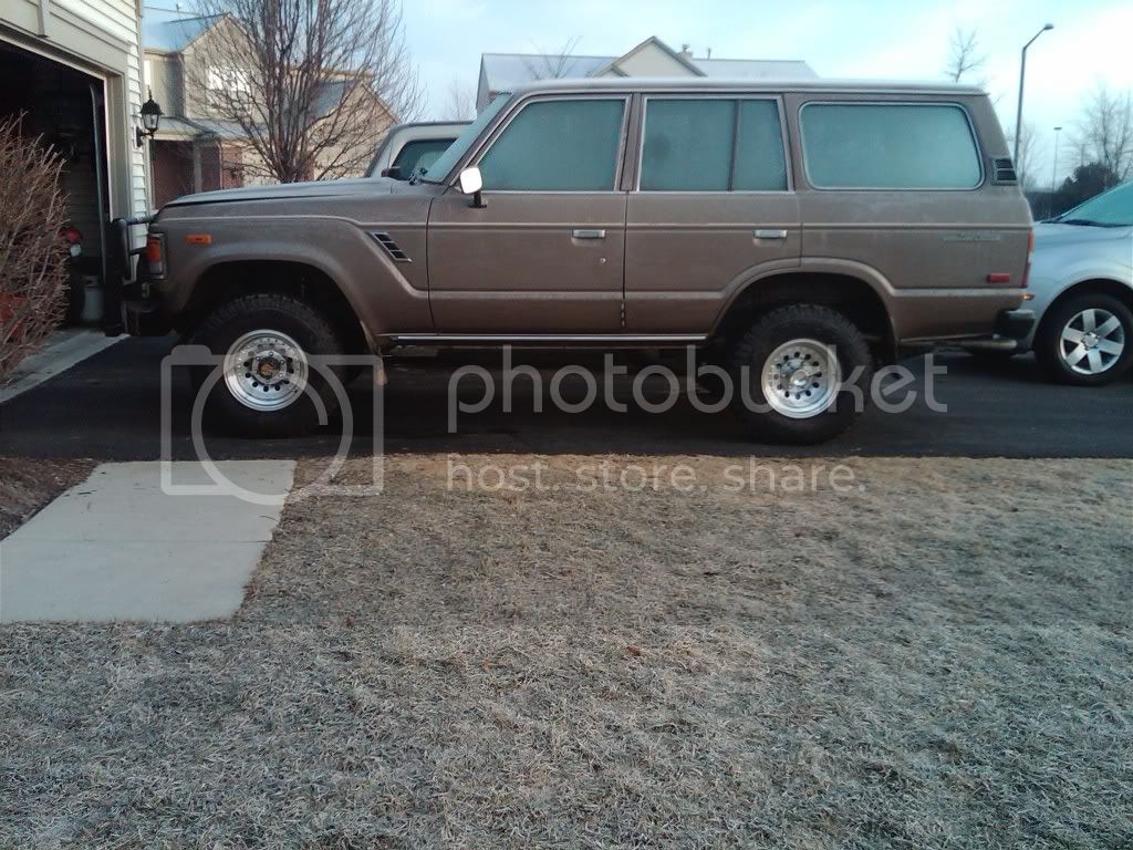

Here it is after the lift but before it settled in a bit.
I need to take a current picture but the front setttled a bit more than the back. The truck sits level from a side to side standpoint and is just a tad higher in the back than in the front.
Lift height: I'm happy with the lift height. It's about what I was after. The lift introduced minimal bumpsteer and I do not have driveline vibes.

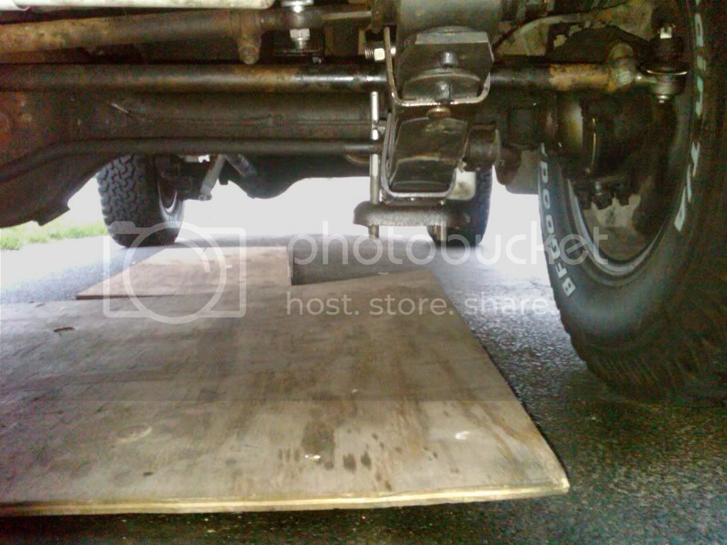

Lift components: All seem great except the u-bolts. The kit comes with standard u-bolts and I'm not crazy about needing two sets of tools to work on the truck. Plus, the stock u-bolts will work fine with the kit and the studs don't stick down nearly as far. I reused the stockers on the rear axle adn will be replacing the new u-bolts with the stockers on the front before I wheel and bend up the studs on the new ones. I suppose if you order the kit see if you can get it without the u-bolts and save a buck.

Here is how it sits today. As I said it's a nice amount of lift and shouldn't sag under load.
No cruiser lean...

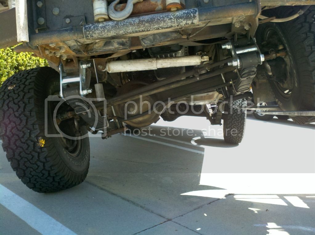

This shows the front u-bolts.

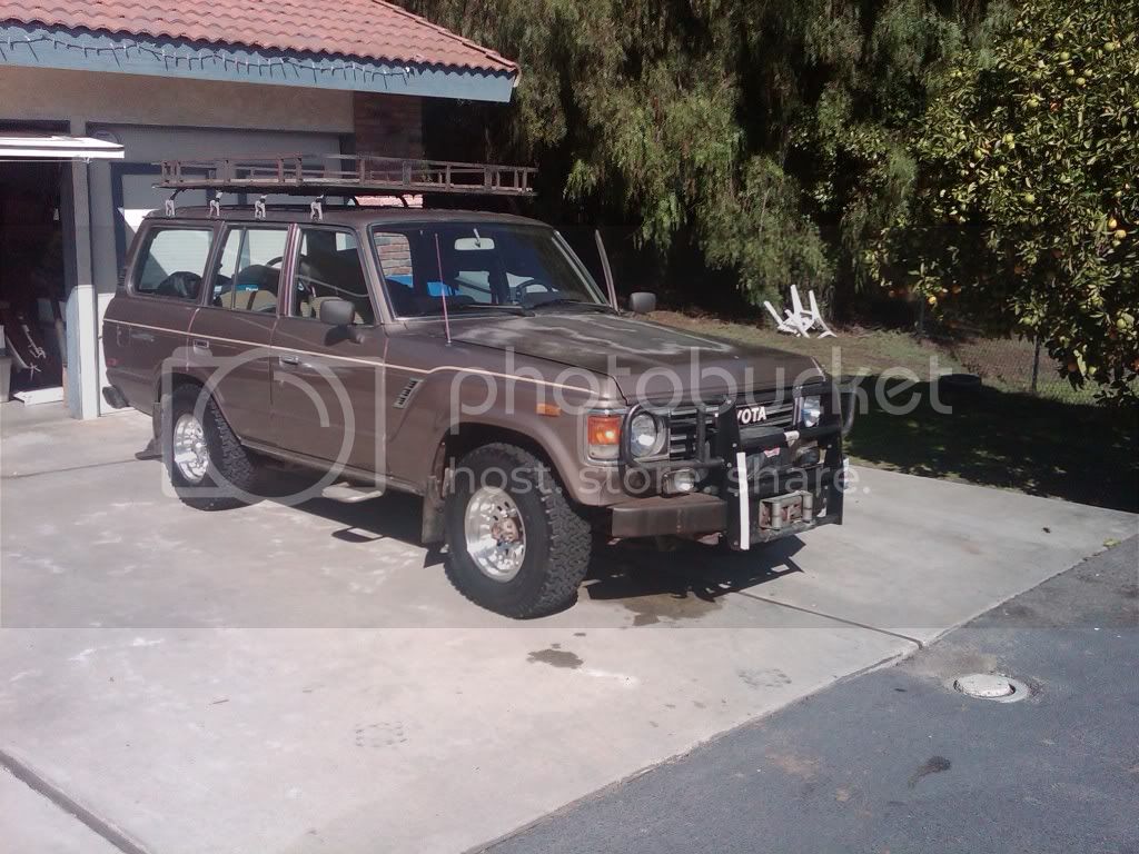

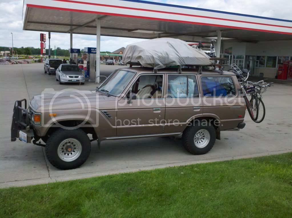

Just a quick update. Here is a picture of the truck loaded .. well probably overloaded driving from IL to San Diego.
The suspension is excellent under load. We had head winds that turned to cross winds averaging about 40 MPH. The truck rocked very little even with all that stuff on the roof.
I'm now totally stoked on this kit. It costs much less than the OME, is US built, and works very well. I would recommend it.

This sits just a touch stink bug unladen but as you can see with this much weight it sags in the back.

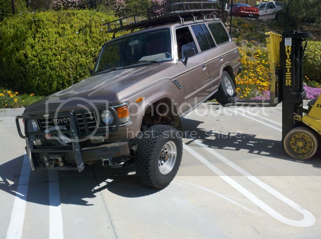

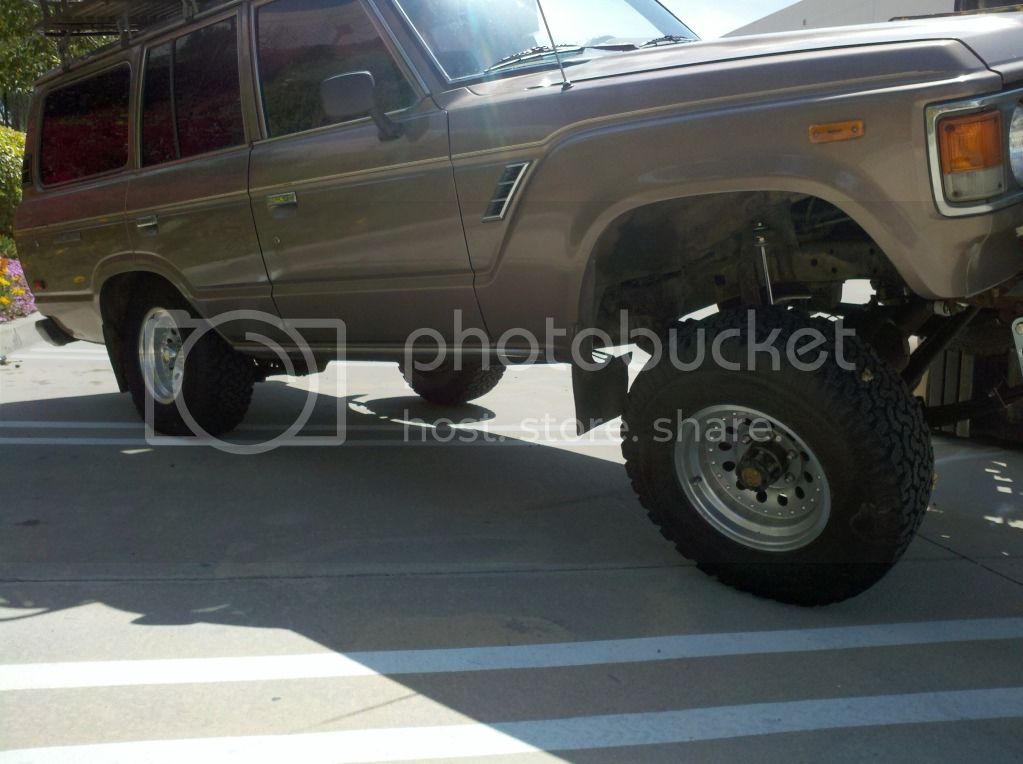

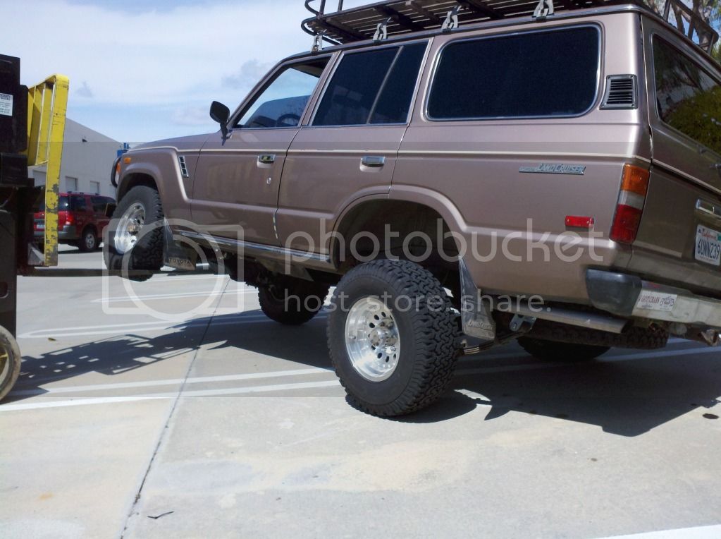

I figured I'd update this thread with some current pics for those searching for information.
I had an issue with the front springs which Hell Creek warrantied promptly free of cost. They have very good customer service. During discussions I got the go ahead from them to run run some longer shackles. Here is the truck with Daystar +1" shackles, everything else as the kit was when it arrived. I really like the kit even more now. In fact I think these shackles complete the package. I would say it has to have 3" of lift. It's always hard to judge when you are comparing to 27 year old flattened out springs but it's come some clearance under it now. It rides better with these shackles and flexes really well. I could get a little more out of it with longer shocks but I'm in no rush. I'm a happy customer.
Total cost was $960 for the kit and an additional $150 for the shackles. Best part is it's all made in the USA.
