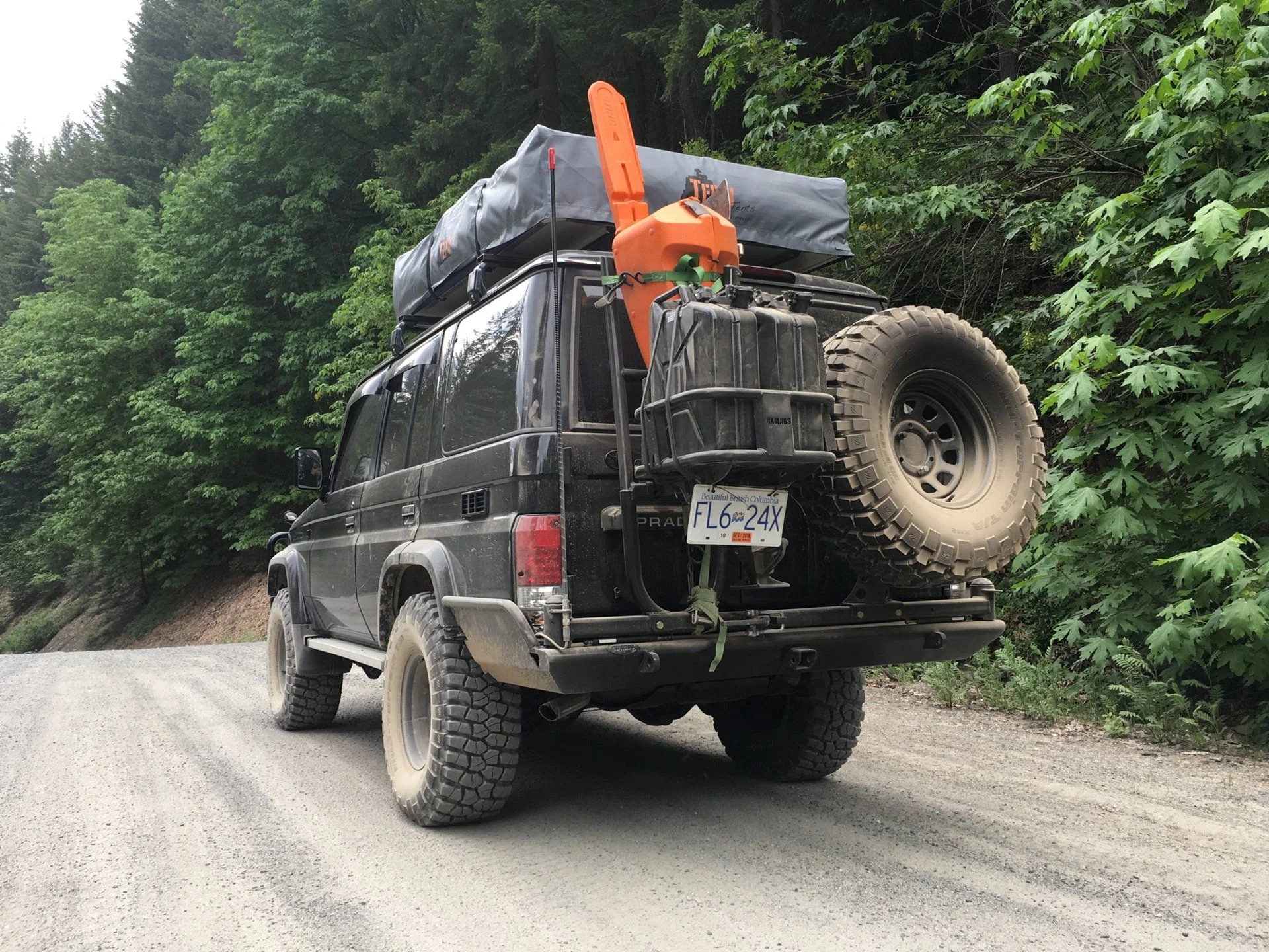

Hey All,
I am looking for a little guidance in beefing up my rear suspension. I have added a lot of weight and it bottoms out over a grocery store parking lot speed bumps.
Does anyone here have experience with air bags on a 78 series? I am considering the type that sit inside the spring coils and since I have an ARB compressor already I figured I'd put it to use.
Thoughts?
Adam

Your idea of going with heavier springs did cross my mind but I might still risk going for the airbags that fit inside the springs. The bags are cheap and the installation is easy and I am hoping to be able to adjust the stiffness between loads. If it doesn't work I haven't really changed that much and I could just scrap them. In fact I've ordered the bags and installing in 2 weeks. I went from knowing nothing at the beginning of my thread to thinking I know it all.
