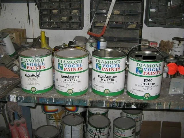

I did my gray fj62 with 2-component equipment urethane and plan on doing my 40 (mustard, kinda like new cat yellow) with this same product. Not all equipment paints are created equal, but if you can get your hands on this, it has a superior gloss retention, which means no clear coat.

Your best bet is to go to an auto place(which I did) and get a sample. Cost you about $8. Take it to D.V. , have em' match that sample and you will be golden, I mean mustard....
They did tweek my sample and it is "dead nuts on". Just make sure you get the pinnacle 415 which is not a high gloss, but a nice gloss.
