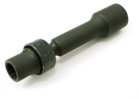

I was shopping for impact sockets and to my surprise I saw they came in 2 versions: 12 points and 6 points. So what am I missing here? Why would anyone want a 12 pt impact socket? It's not like you have to worry about not having room to turn your impact wrench I imagine...
ah. I thought those were a different size standard. Good to know.
Those typically look like this
