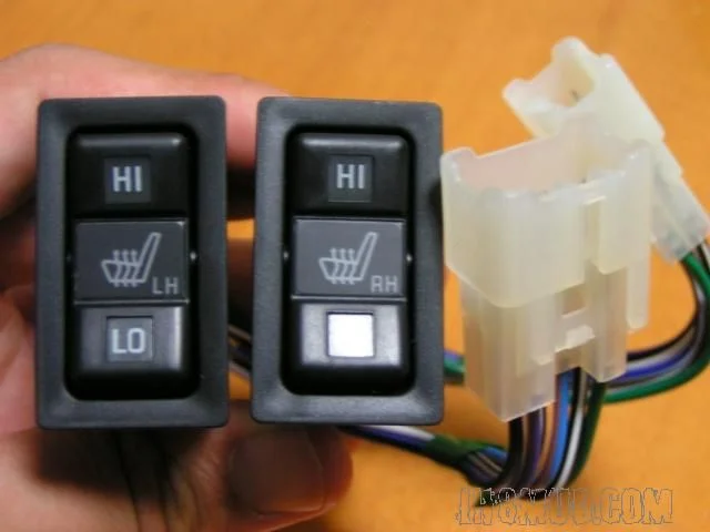

I used a pair of switches out of an older Lexus sedan (92-96 ES300?) They are the same colour as my interior and fit perfectly in the lower to coin holder slots. I have a fuse block mounted to the side of the rear heater unit (as seen on the Slee website) that I pulled the power from and I made my own harness with some Toyota relays and connectors. The relays are triggered by one of the connectors under the centre console so the seats can only come on when the key is ON, and the switch backlights are hooked up so they come on and shut off with the rest of the lights. I didn't see a mtaching pair of plugs that would have worked for the switches as part of the OEM wiring though :confused:

These are the two that are in my 96 Landcruiser. The connector on the back of my Lexus switches was the same as the rear heater switch connector.
I used a pair of switches out of an older Lexus sedan (92-96 ES400?)
HTH!
I am stunned at how smooth these look! Did you stumble upon these or did I miss a thread somewhere? Order the switches or did you pull from a yard? Very Nice!
They came from ebay, and I saw a Mudder selling a pair in the classifieds last week. I just checked my email records and they were out of a 92-96 Lexus ES300 according to the ebay listing.

I can confirm that the pigtails on the MOT switches plug directly into the OEM connectors under the console. Even before running the pins from the connector under the seat to the elements, they are live, no other wires to be run! Everything is waiting in the below-seat plugs. My system has been up and running using a similar wire diagram to the aftermarket seat elements provided by AATLAS1X. Heat works well and looks 100% OEM.

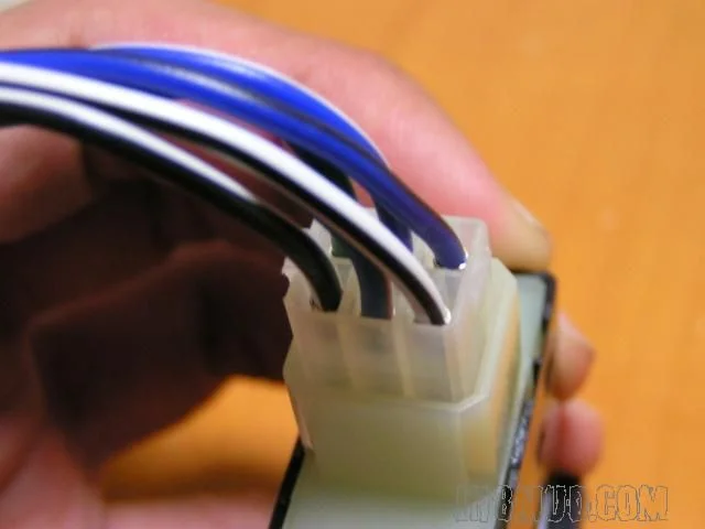

Ok, here are the wires in the plug under the seat that feed the aftermarket elements. Of course it is best that you test to be sure that they are giving the right signals, as your truck may vary from mine.
White with black trace = Ground - you will need to tap into this one, as it is also used for the powered seats.
Blue with black trace = +12v when you have the OEM/JDM switch in the Lo position
Blue with orange trace = +12v when you have the OEM/JDM switch in the Hi position.
Essentially the two "blue" wires go to a relay (supplied with the heated seat kit) which controls how much voltage is fed into the seat cushion elements. Mine work flawlessly, and I checked the OEM setup voltage 10x over as compared to the supplied switches before cutting into/wiring anything; advise that you do the same as the penalty for screwing up is a burnt out element, or wiring harness. Be careful!
