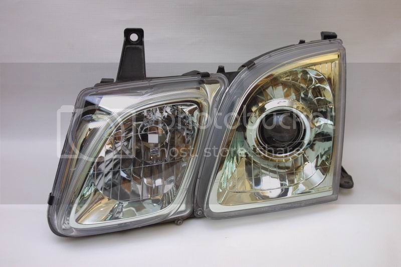

Not really, just google LX470 headlight and you'll see what he's referencing. One mounting tab shown below, other two are on the bottom.

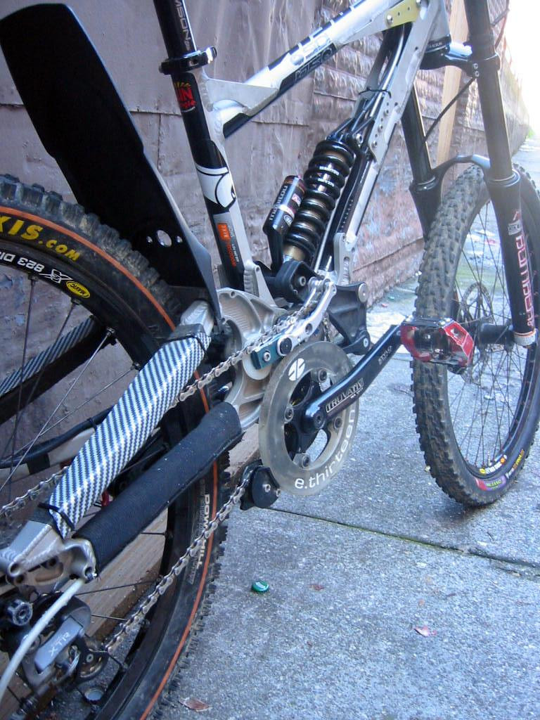

This is a very obscure material that sincerely I don't have a way to trace, I wish I did (Inline skate racing boots use a similar resin so the shoe can be reshape to the feet..
The one I have is a fiberglass/carbon blend, but is not a "Thermoset/Thermostable" resin is a made with a thermoplastic resin aka that it can be bend and form with heat (and reheat and re-heat again and again)
Hand thermoform seatstays protectors for my Nicolai M-pire downhill bicycle.
Never mind the fender, that was a really stupid idea.
In any case, this is maybe the Holy grail of repair bandaids, since you can bend it with just a heatgun so it totally fit the shape you are reinforcing/repairing/bracing and then use epoxy resin to bond it too the part, (very fast process, not messy, no glue spills.
