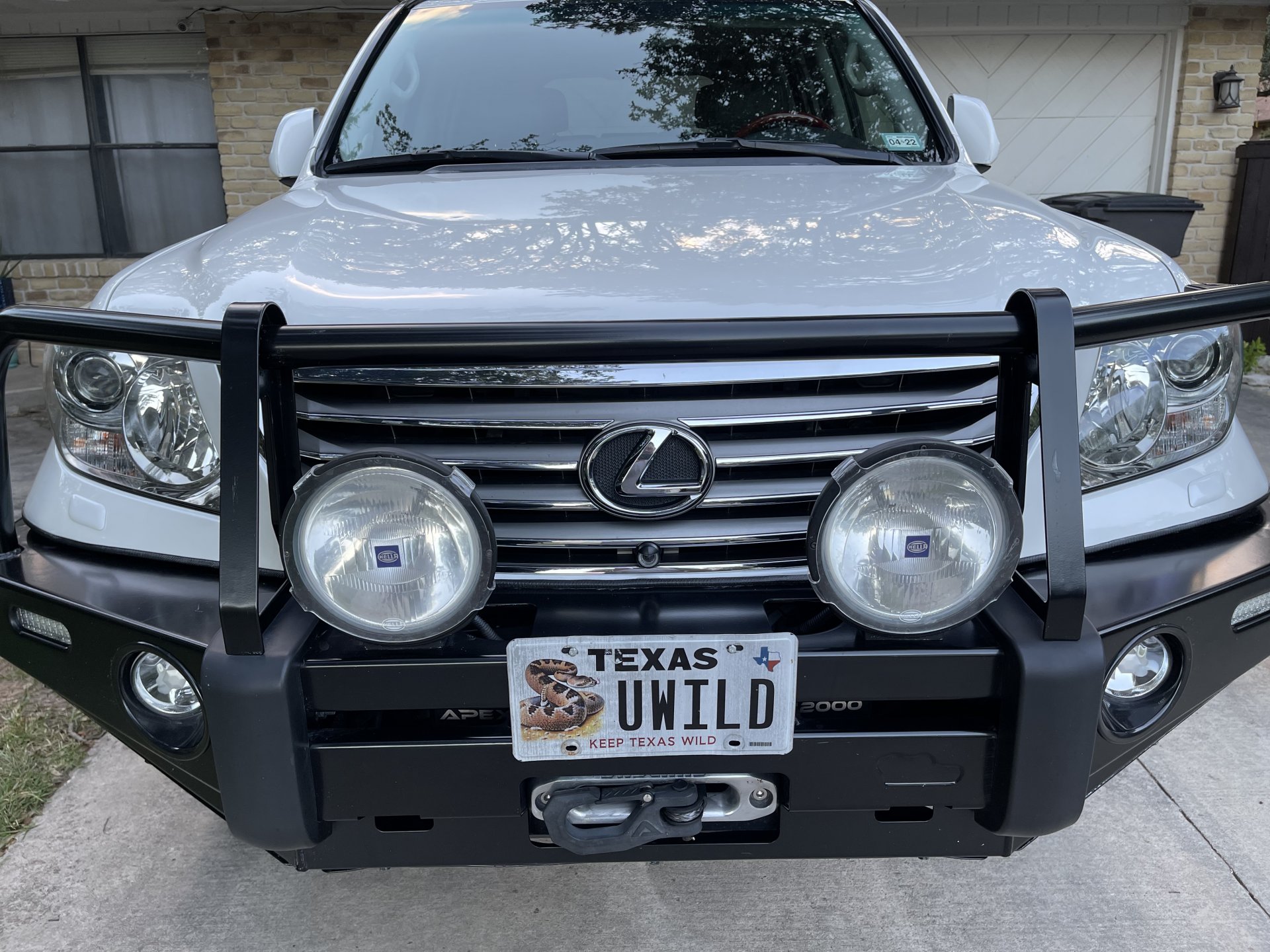

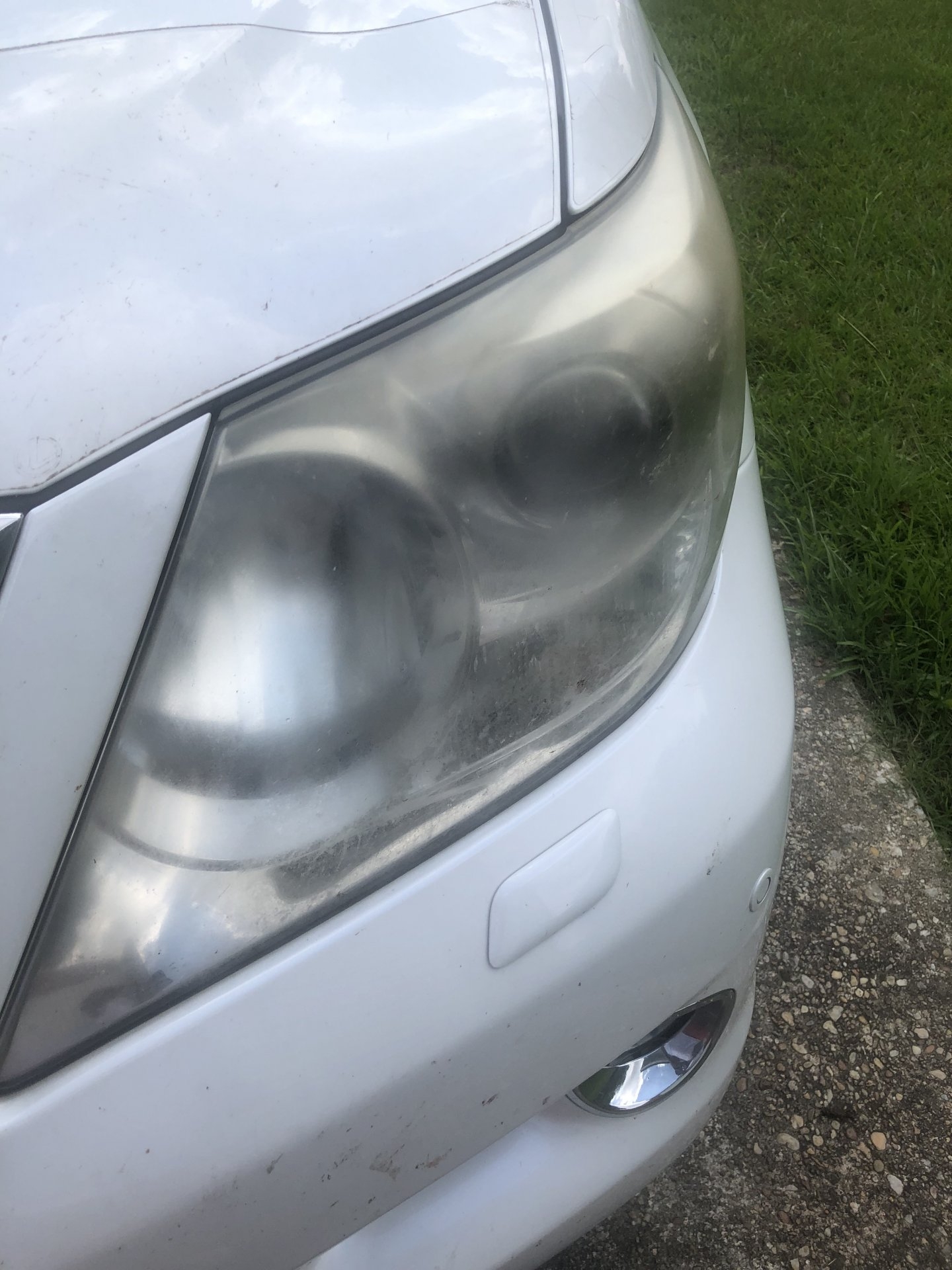

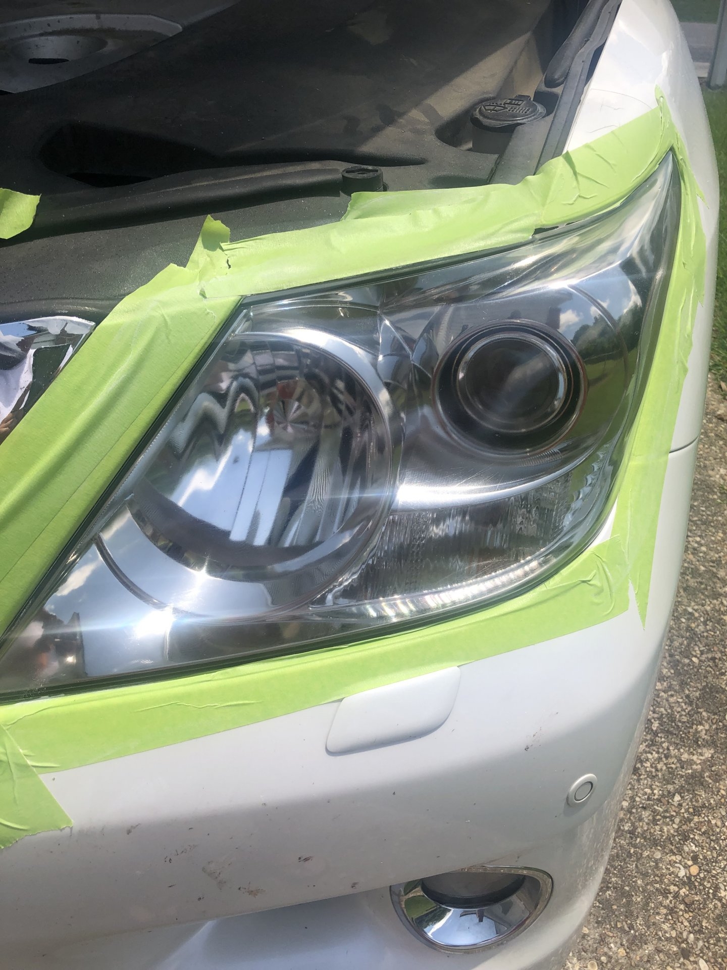

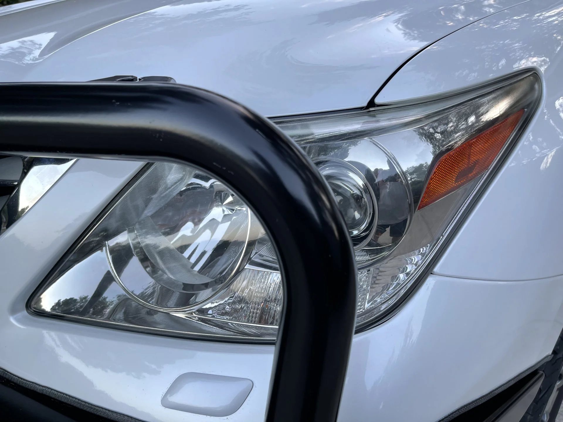

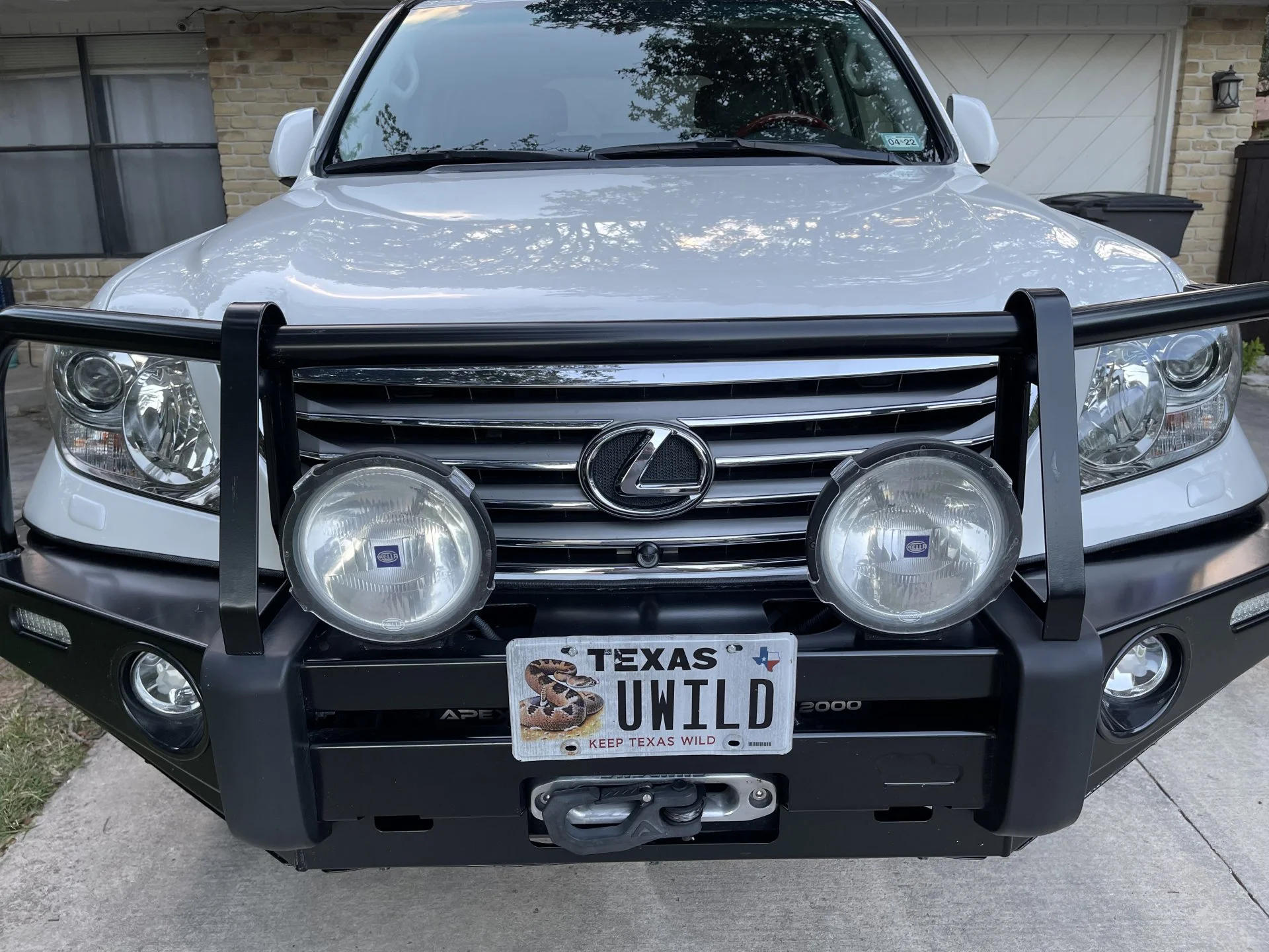

Great product ! Got my headlights looking like new. No sandpaper involved

Cheap porter cable orbiter with a white lake country pad .. I did abt 4 passes on each headlight
Hope this helps .. I have to do my 14 rx350 an 2500 Chevy soon . They aren’t near as bad as the lx was. Lx took a bit of pressure to get good results
