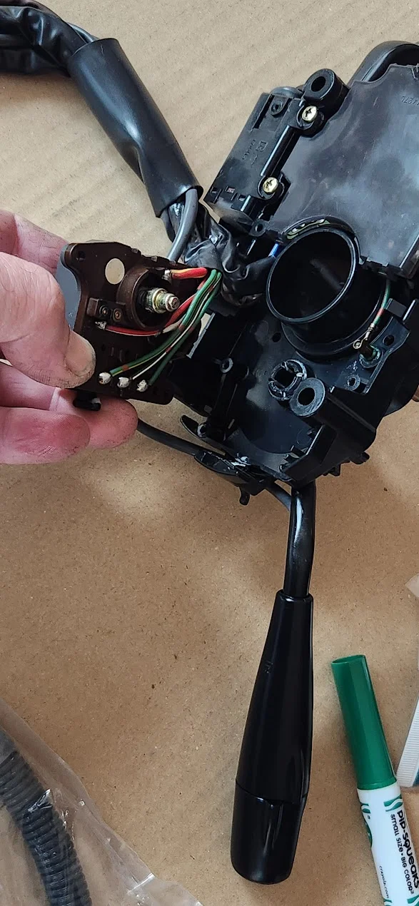

So now low beans work but no highs. Loose plugs fixed, but not sure why high beams don’t work still. New bulbs, checked grounds, maybe switch in steering column?
If your headlamp stalk switch doesn't click forward and back as it should, the problem is in the bracket, spring, and bearing indicated by the red arrow in this pic.
If your headlamp stalk switch clicks forward and back as it should and you don't have high beams, check the headlamp dimmer switch as described in the post I linked above. The image below shows the headlamp dimmer switch being removed from the back of the switch assembly. The plunger goes into that hole, and presses up against the underside of the stalk switch.
If you can short the headlamp dimmer terminals as I did in the other post, and it activates your brights, you know it's the headlamp dimmer switch.
