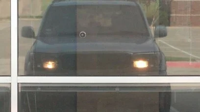

Photo says it all. Output is weak, one side is dimmer than other.
I realize there are threads about this, but what are my best options?
Greatly appreciate all suggestions, so feel free to chime in..

Based on that one photo, it looks like they are just misaligned.

The picture shows the daytime running lights (DRLs), which are the highbeam bulbs at half power.
My DRLs and headlights looked like that too: dim and uneven.
Because I am cheap, I just replaced the bulbs with a new set from AutoZone.
The highbeams are 9005 and the lowbeams are 9006.
Both pairs of new bulbs cost about $50 total and my lights work much better now.
There are better and more complicated solutions, but replacing the bulbs is the simplest and least expensive way to get brighter more even output. You could also try re-aligning the lights to get a better beam pattern.

Those are your DRL's.
+1 those are DRL's...also know as high beams running at half power.
The LC headlights are weak so looking into an upgrade is a good thing but your photo is not representative.
As mentioned HIR for upgrade. HID projectors for overhaul.
That's a good summation, but yeah, the headlights in general suck too, but the DRL's are fairly accurate representation of the situation as a whole. I pulled up to a building at night and turned on my lights and was unimpressed.
