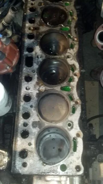

1.Leak down test had no leaks on #4, 5, or 6, but definitely #2. I stopped there.

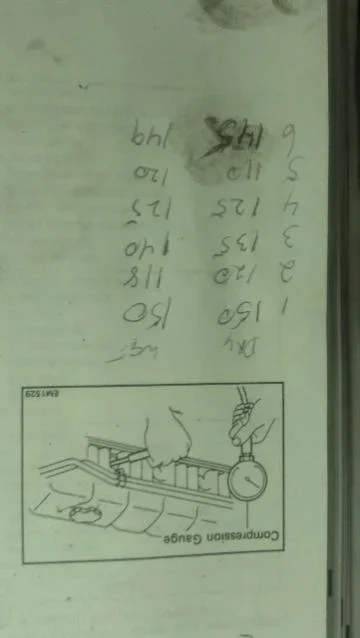

2.Compression numbers are all over the place (see pic), but wet compression numbers are not significantly higher, so I don't think it's the rings. Cylinder walls still have great looking hash marks without any unwanted scoring.

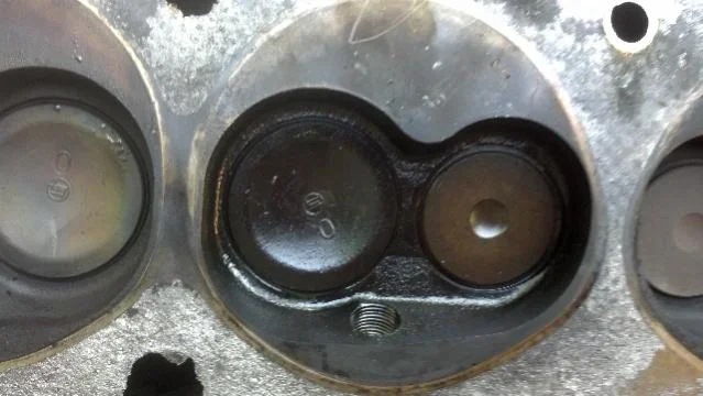

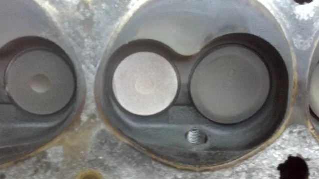

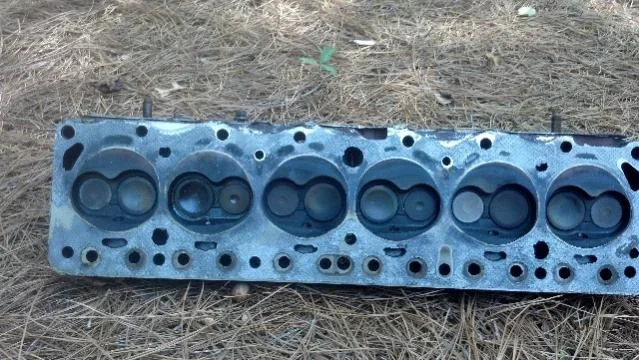

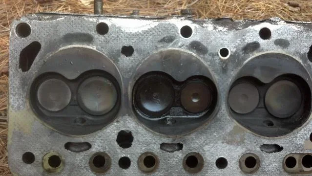

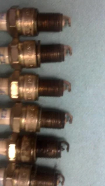

3. Plugs 4, 5, & 6 are all white and the bottom of the valves are as well. See pic
4. Plugs 1, 2 & 3 are dark and cruddy with #2 definitely having coolant on it.
5. Until a day or so before pulling the head apart, i was having no power issues, but i was running hot and had no leaks, so i knew that the gasket was going/ gone.

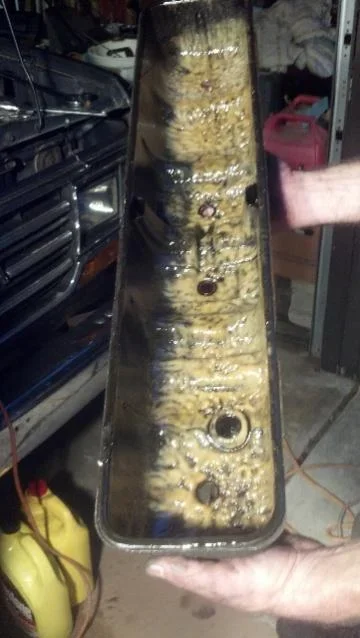

5. Am i missing anything that the pics are showing?
