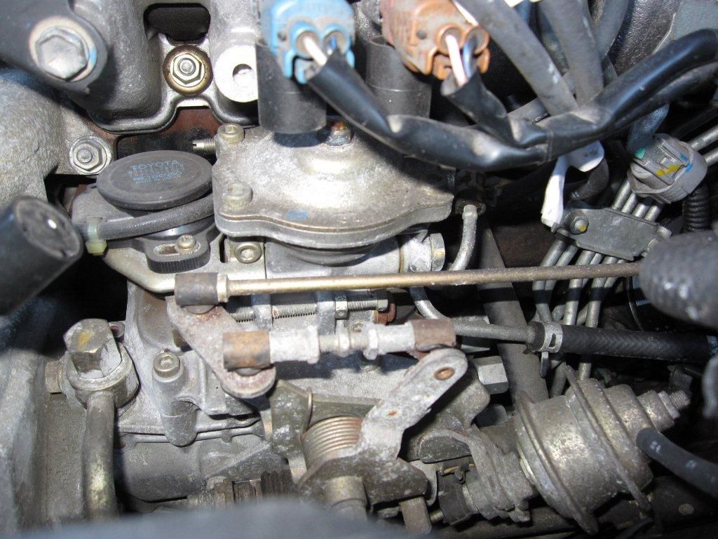

You can adjust your AC idle too. 17 mm if I remember correct, at the bottom right of the picture.
I finally got to working on the 80 and the idle adjustment screw is gone!. Not sure when or how but I need a new one. I have looked in my parts guide, FSMs ect and cannot find the part number for the screw or its size/thread. Anyone know the part number or size. Thanks
