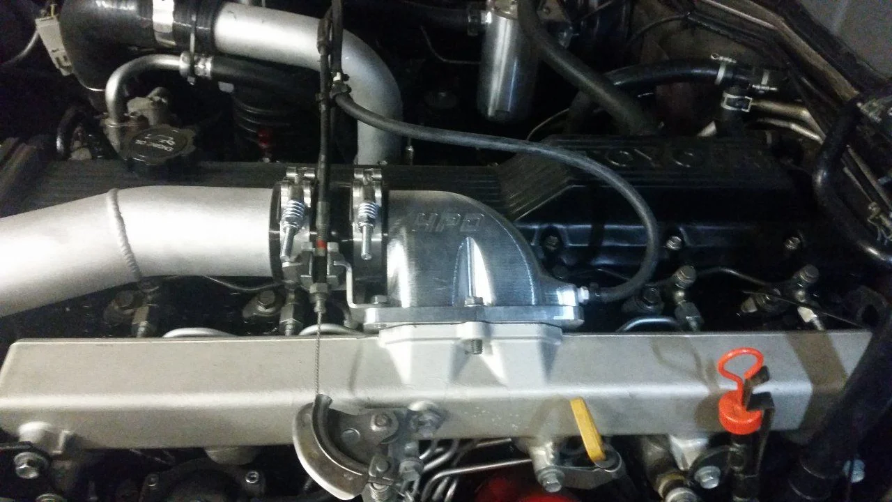

Will you please take a picture of your setup for where you run to test for boost? Unless I'm mistaken, the billet adaptor removed the location I was pulling from and also creating the vacuum for my exhaust brake.
Boost is taken from the back of the billet adaptor and Tees off to the boost compensator before running back to the pressure sensors

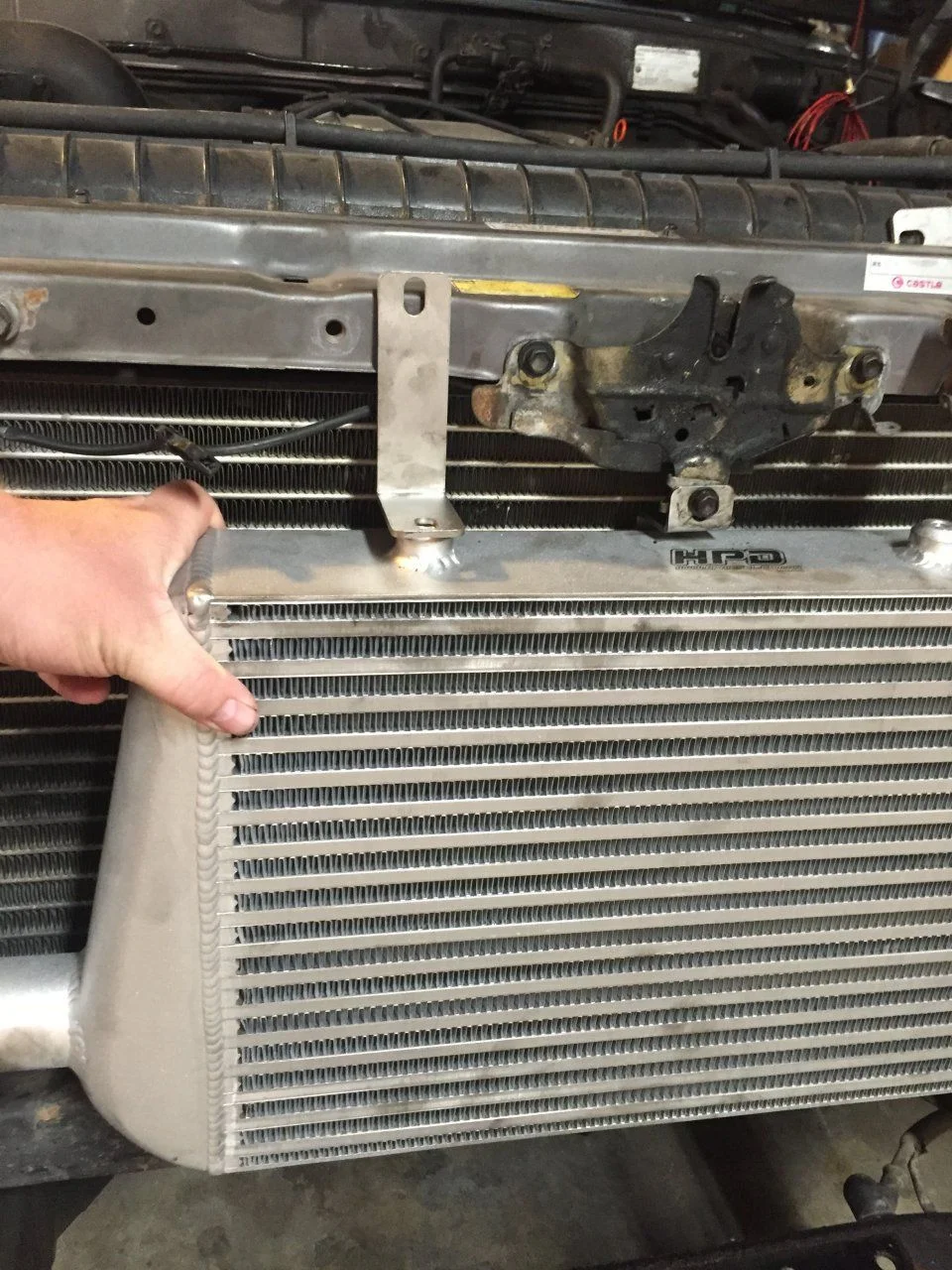

Hi all, just wanted to give a heads up that this kit will NOT work with the factory winch without modification. Figuring this out the hard way at the moment. Hoping i can move the whole unit up about 1/2 inch and get some clearance. I *think* the intercooler will fit, but it will likely require welding/tapping/cutting of various brackets, and hopefully nothing more. Will post updates when I figure it out.

Ugh!! Thats not good. Moving the intercooler up is going to cause lots of issues with the routing of the piping. As it it the clearance under the battery boxes is extremely tight and your also going to have clearance issues with the A/C lines to the condenser.
I'm not familiar with the mounting of the factory winch but wondering if it might be easier to move it??
Yeah that's what I was worried about. Hoping I can get some flexibility out of the silicone hoses, possibly drill the holes in the same spot but angle the pipes downward from the intercooler. Worried about rubbing/rattling though. Was it 100% necessary to remove the A/C lines in your case?
Factory winch is the biggest I've seen on a street rig and is bolted at multiple locations in the frame, and has its own crossmember underneath. No way I'm moving that thing, it's a beast!

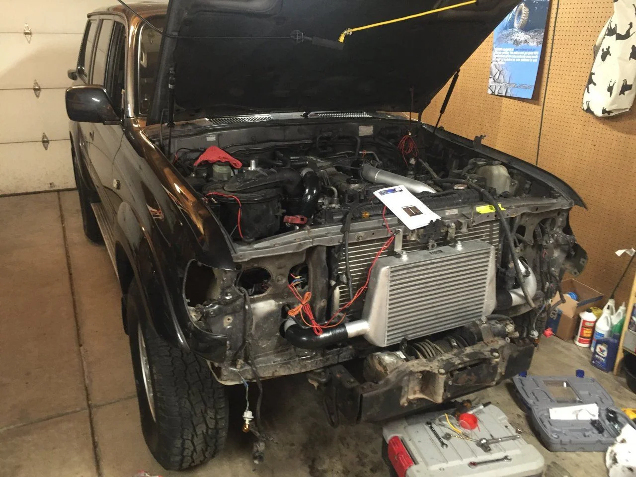

There is hope... Upper brackets shortened, and drilled and tapped bottom brackets in to body. Definitely not as sturdy as drilling all the way through with the provided sleeves, but hoping locktite will keep them together. Would have welded them to the body, but brackets are stainless. Feels solid. Did not use cut factory center crossmember at all, just attached new crossmember directly to latch mechanism. Intercooler rests directly on winch electronics box, and Im hoping the contact will not cause issues. Will have to relocate winch solenoid doohickey that was below the passenger battery box. Will know more as I start to put it back together.
Any of you guys have trouble with the hex head bolt? Is the adapter threaded or smoothe on yours? My bolt is way too short to bolt onto the enginr
I made it work with the original bot. Not too hard to get a wrench in there so long as you don't have the charge pipe connected.
