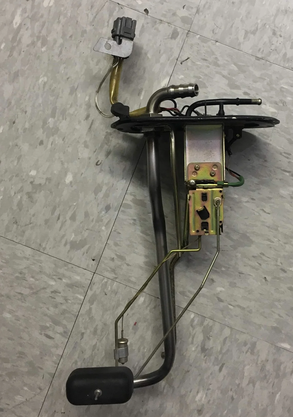

Looking for a complete fuel tank pickup assembly for my 1993 HDJ80. Bracket and all:

Is it the same unit was in a fzj80?

It is not the same unit. It is different because there is no fuel pump in the fuel tank in a Toyota diesel.
But I betcha you could modify an FZJ80 unit to work.

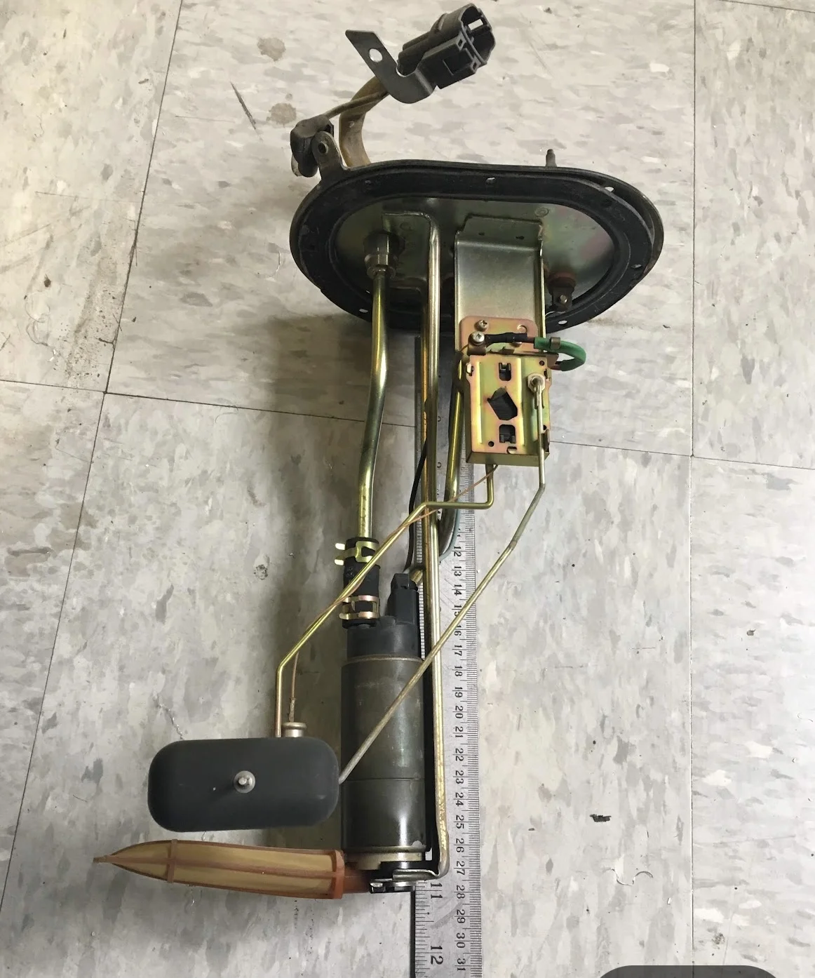

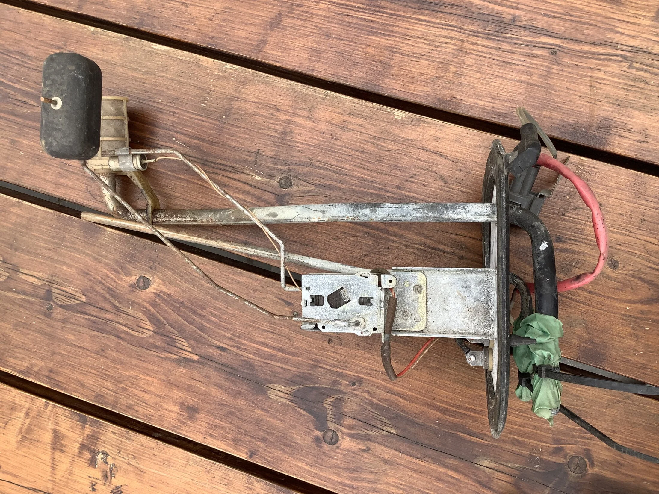

Bryce, you can use a gas pickup and modify it. Cut off the 8 mm intake pipe, redrill it to 1/2” and attach a 12mm/0.5” pipe bent to shape, weld a fitting and bolt it with a sealing washer. I used a stainless pipe. I had to do it because the part is not available new anymore.

Oh this is awesome! Thanks for the info! How much would I need to pay you to make me one of these and ship it to CO? Im doing the install of my tank in Colorado with my dad at the end of the month hahaha

Why don’t you pull the one from the current tank? All you need is the two gaskets.
