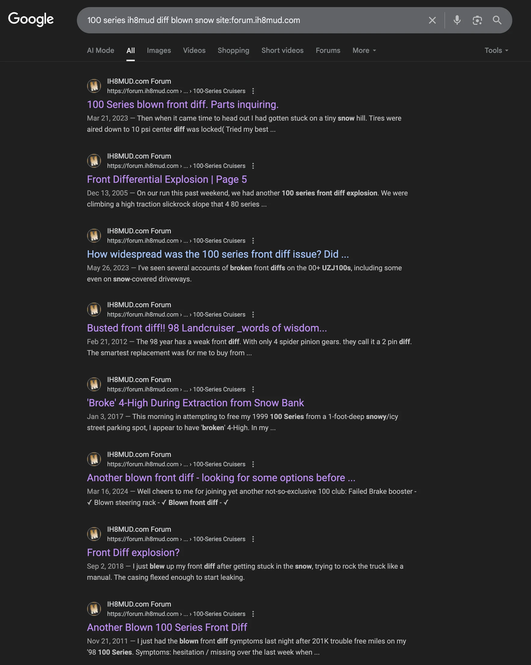

Like @Eurasiaoverland mentioned the front diff is also a weak point. 98-99 had a 2 pinion front diff that was especially weak but I think people have even broken later model diffs as well. Since you mentioned snow driving, that's one of the times when people break diffs - basically in mixed traction environments, not even on the trail - like if one front wheel is spinning and the other gets some traction, the sudden shock to the system breaks parts in the front diff.
The solution is either be careful how you drive it, or upgrade to an ARB locker in the front. Just look up "100 series diff blown" and there's plenty of reading.
Good info here as well:
