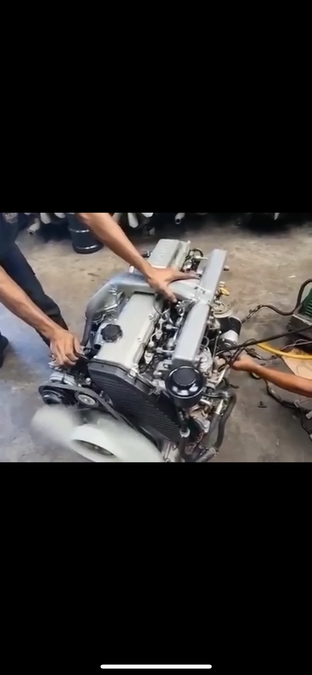

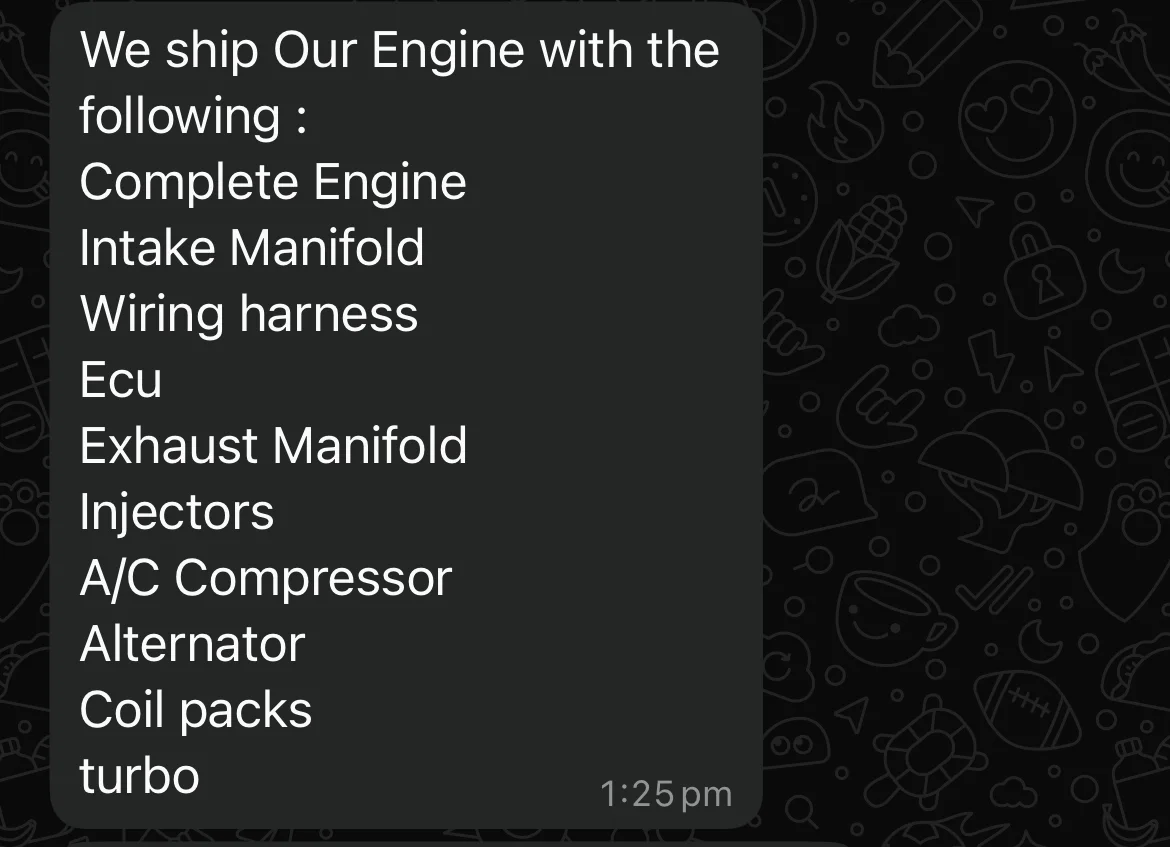

Below I have listed what will come with the engine + a photo from a video of the engine running. Not sure if i can post videos on here.
Is that engine seller overseas from where you are? Just the screengrab of the video makes me think it's fake. AUD 4.3k for a 1HD is ridiculously cheap. Be very careful.
yeah it’s a Japanese import motor, i have second guessed the legitimacy off of it but have purchased many other things through the same platform (including items over 5k AUD) and have never had an issue. They offer PayPal and all payments are made through the app which comes with a trade assurance that offers protection from scams.
