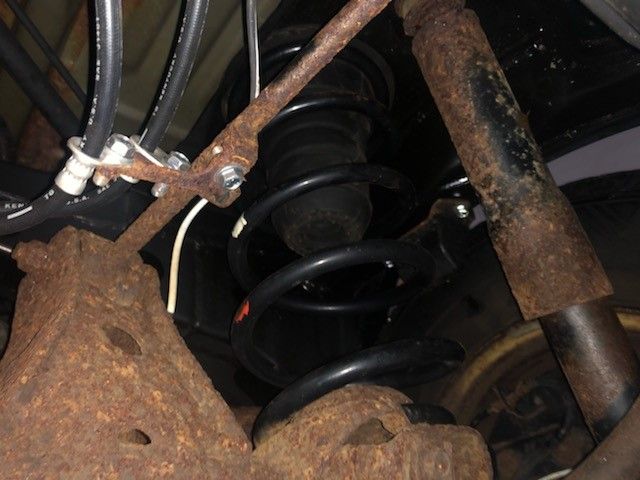

This is obviously for those of you in the salt belt. Curious as to how to evaluate a Sequoia (or Tundra) that had the frame replaced under the recall. It is an extensive job (see attached list) but they obviously do not do everything. Is it even worth considering a truck like this -- all other things being better than equal (great condition otherwise, low miles, very good price, etc).
Has anyone purchased one with the frame replaced and, if so, what was your experience? Thanks!

I am in near New Haven but Valenti in Mystic did the work per the specs above. It is roughly the same as the 07 deal you describe. Appealing low, 98k miles for an 06 1st gen Sequoia SR5. They did do alot of work but I cannot tell if what they left is so rusted as to make this not worth it.
