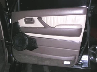

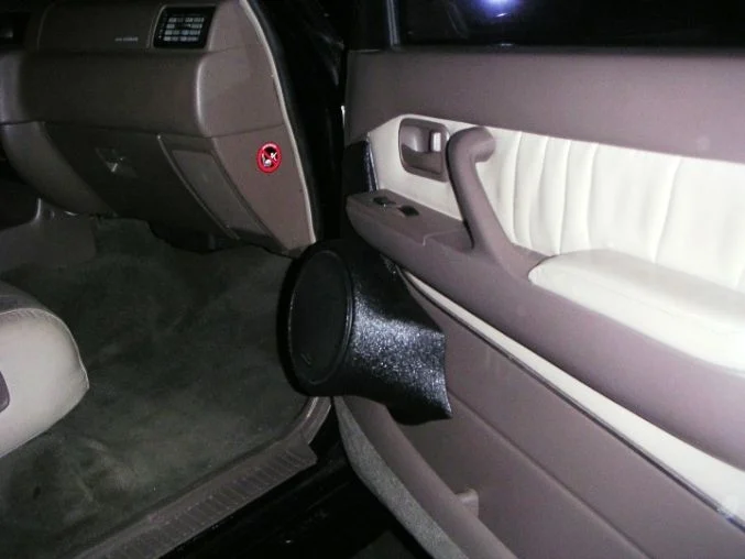

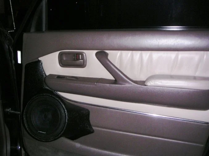

I did 6 3/4" audiobahn separates in the front had to make a pod for the mid and placed the tweeter in the dash factory tweeter location.

I could do kick panels but dont really care for them....ah, might do that. id like to do what mmw60 did with a slight spacer to add some depth but not quite that advanced.
