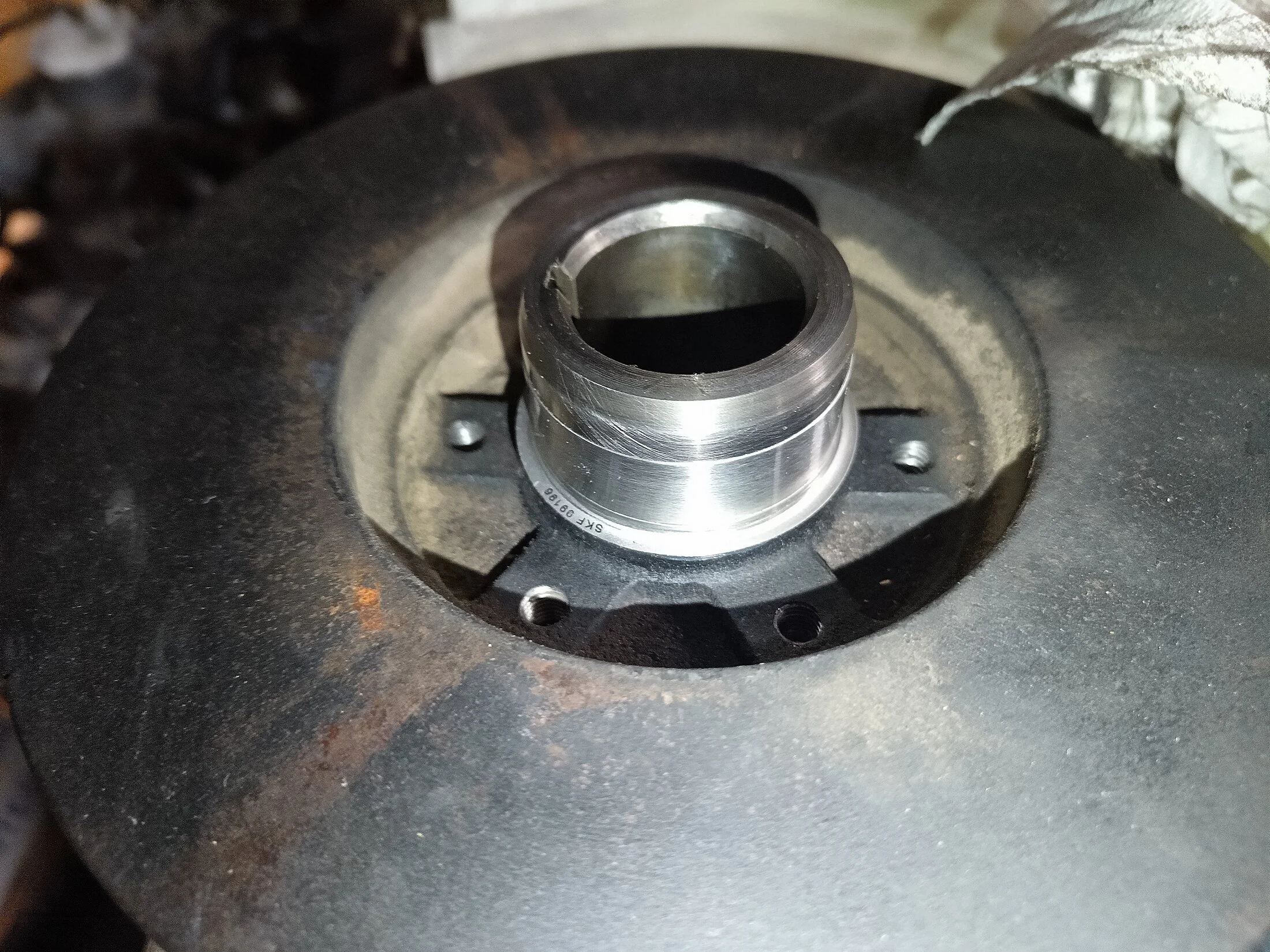

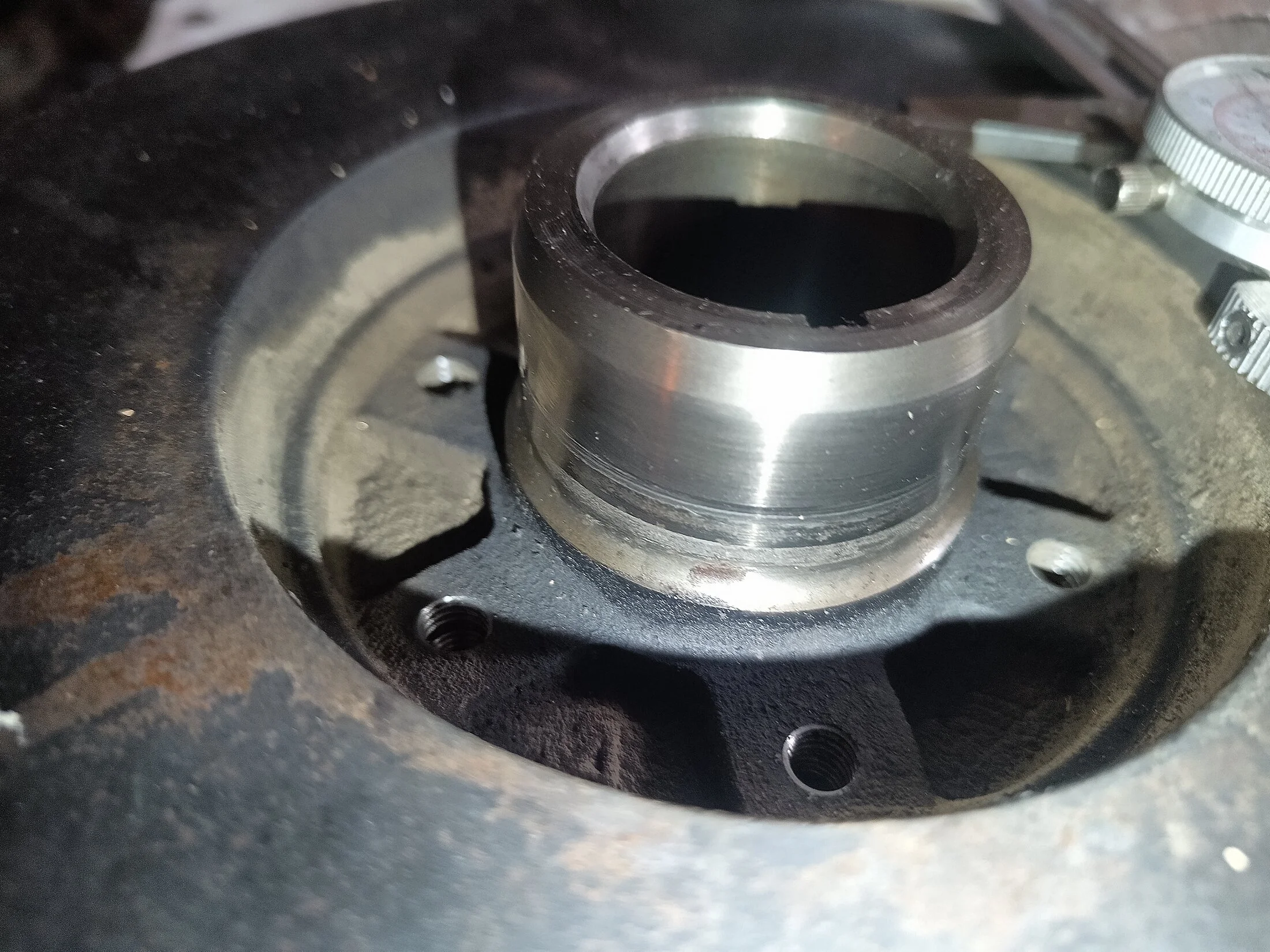

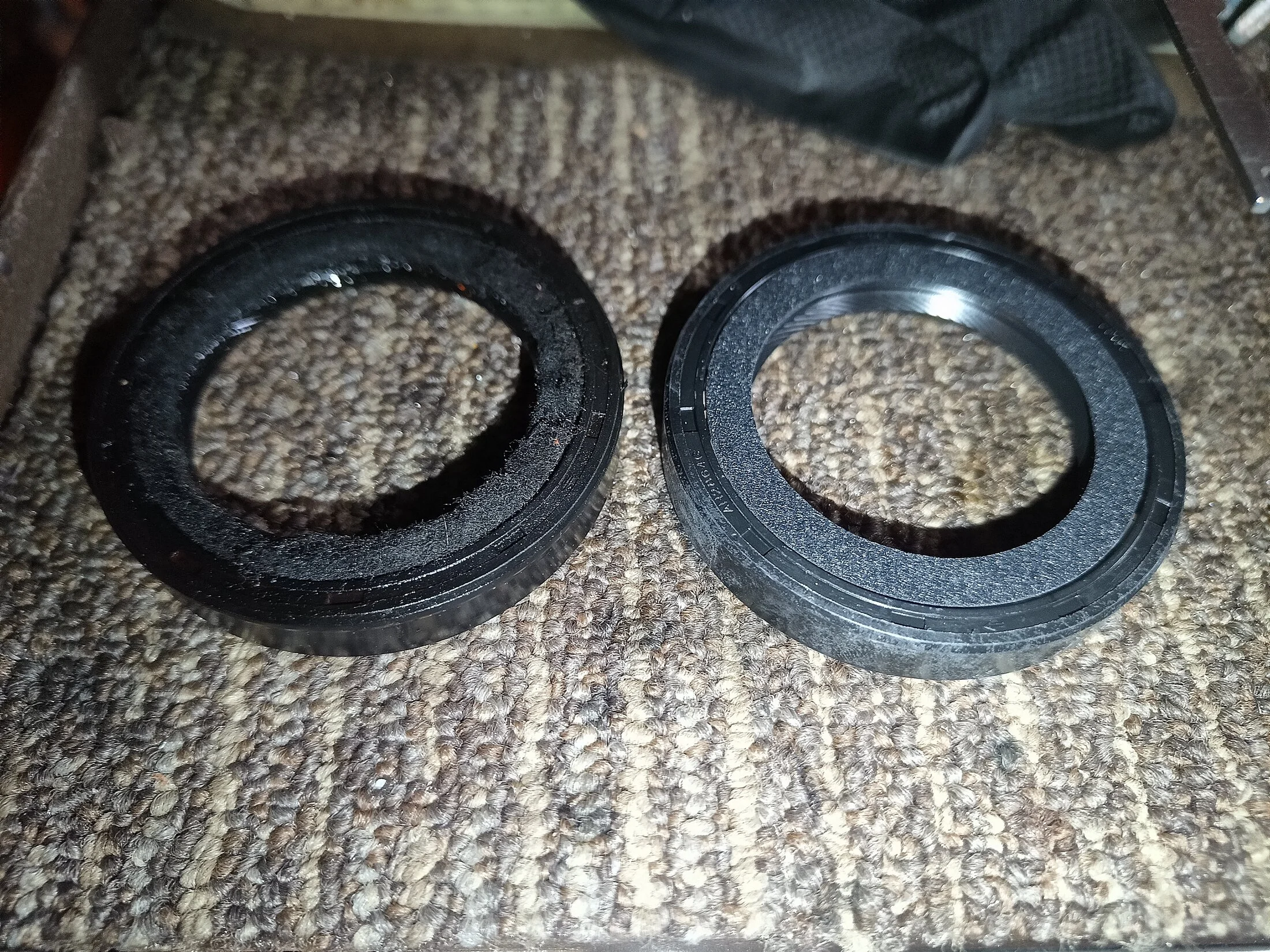

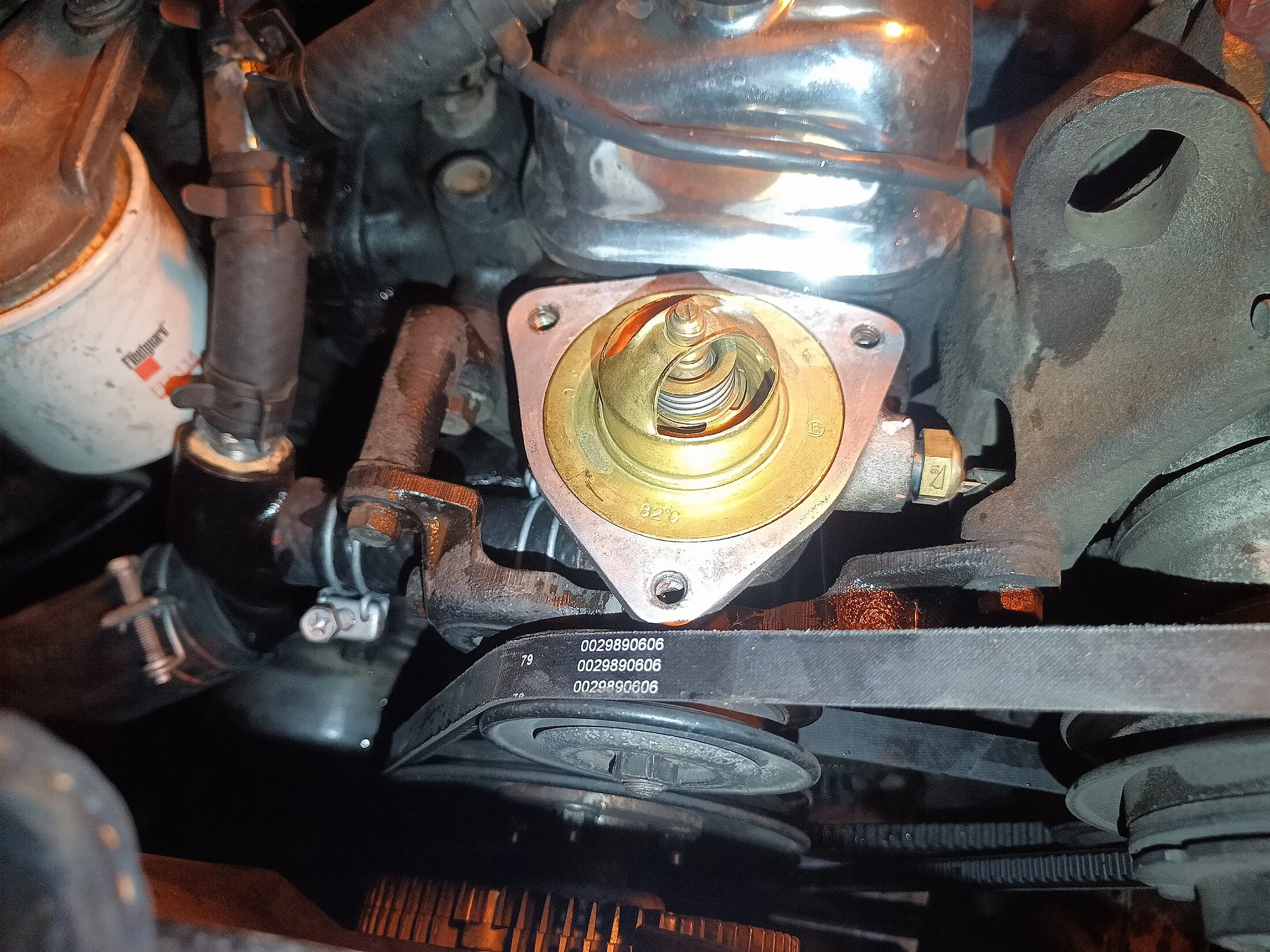

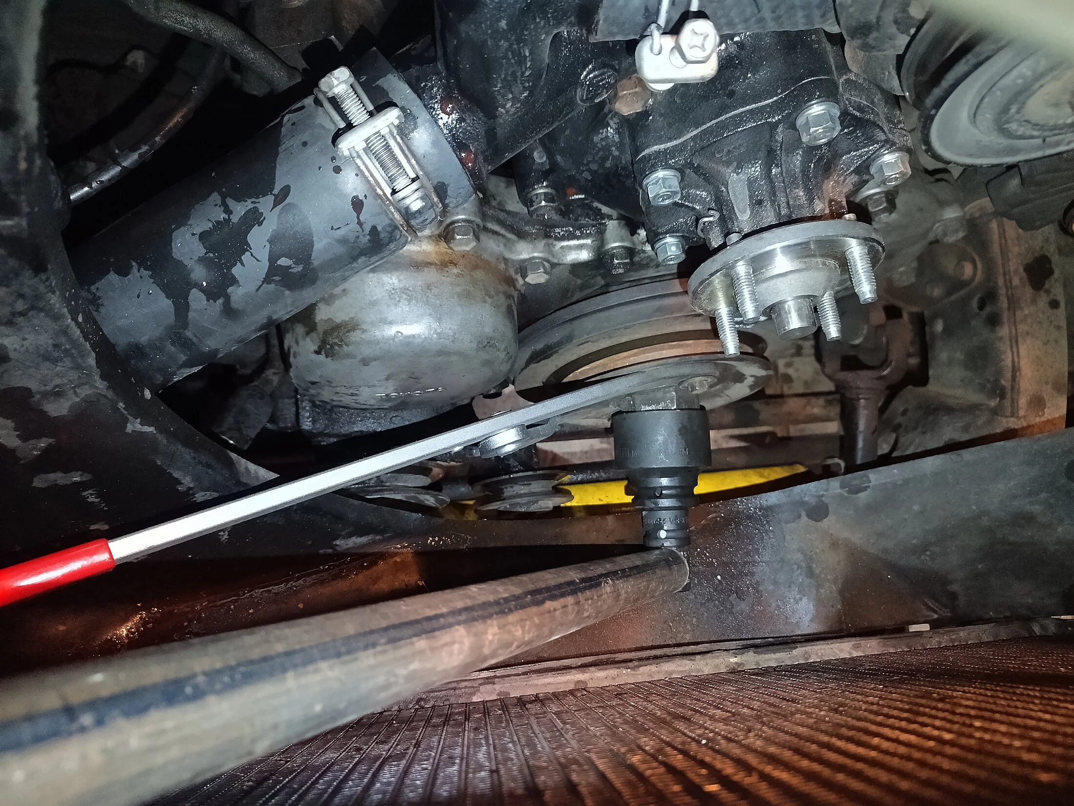

I replaced the front main seal finally, along with installing a speedi sleeve on the crank pulley. I also went back to an 82C thermostat down from a 90C. I had installed the 90C to try to get a bit more power and efficiency, but that was before I had decided to go the turbo route.

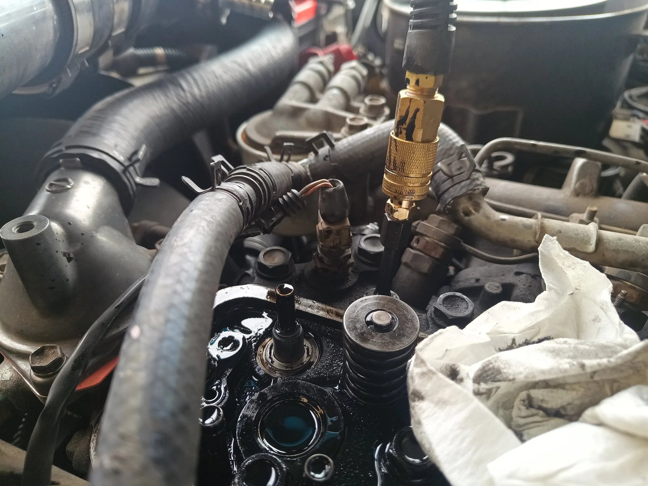

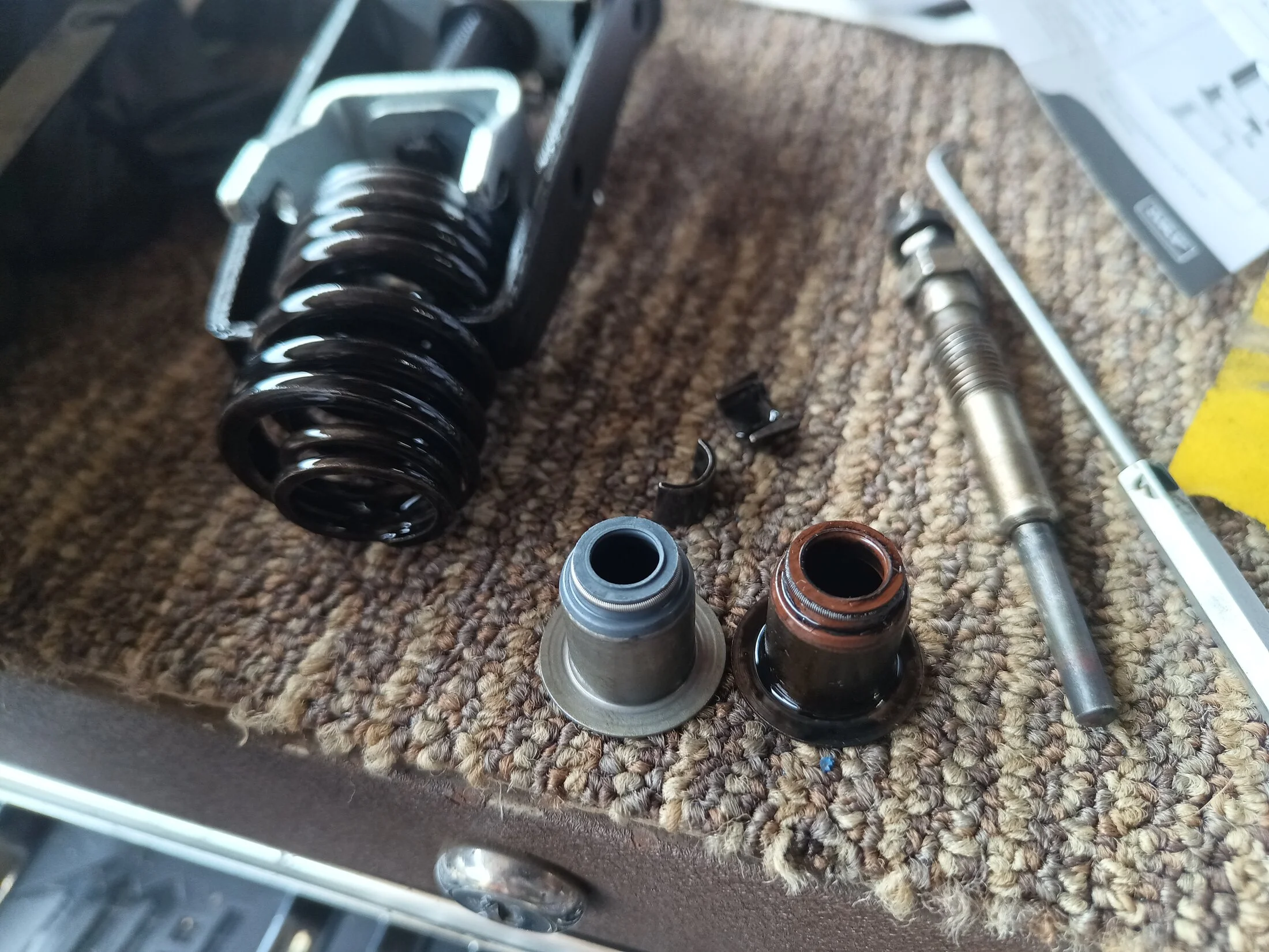

I finally had some time to do the valve stem seals. This was surprisingly straightforward and pumping each cylinder through the glow plug ports in turn with air kept the valves from dropping. The only spring that gave me trouble was the back most against the firewall on cylinder #6. The valve stems measured 9mm OD, the old valve seals measured 9mm ID, and the new valve seals measured 8mm ID. I'd say the old ones were done... Now I just need to find a steep grade to coast down.
I also scrubbed the carbon buildup on the glow plugs before I put them back in.

Not much going on on my cruiser. The front main was still leaking after the speedy sleeve and new seal. On a hunch, I removed the catch can and lo and behold the leaking stopped. Arg. I took the can apart and found the sintered bronze filter element. I thought this might be causing too much restriction so I reinstalled the can with the filter removed. It still leaked out the front main seal, albeit less. Drips on the driveway is still too much. Off it shall stay.
