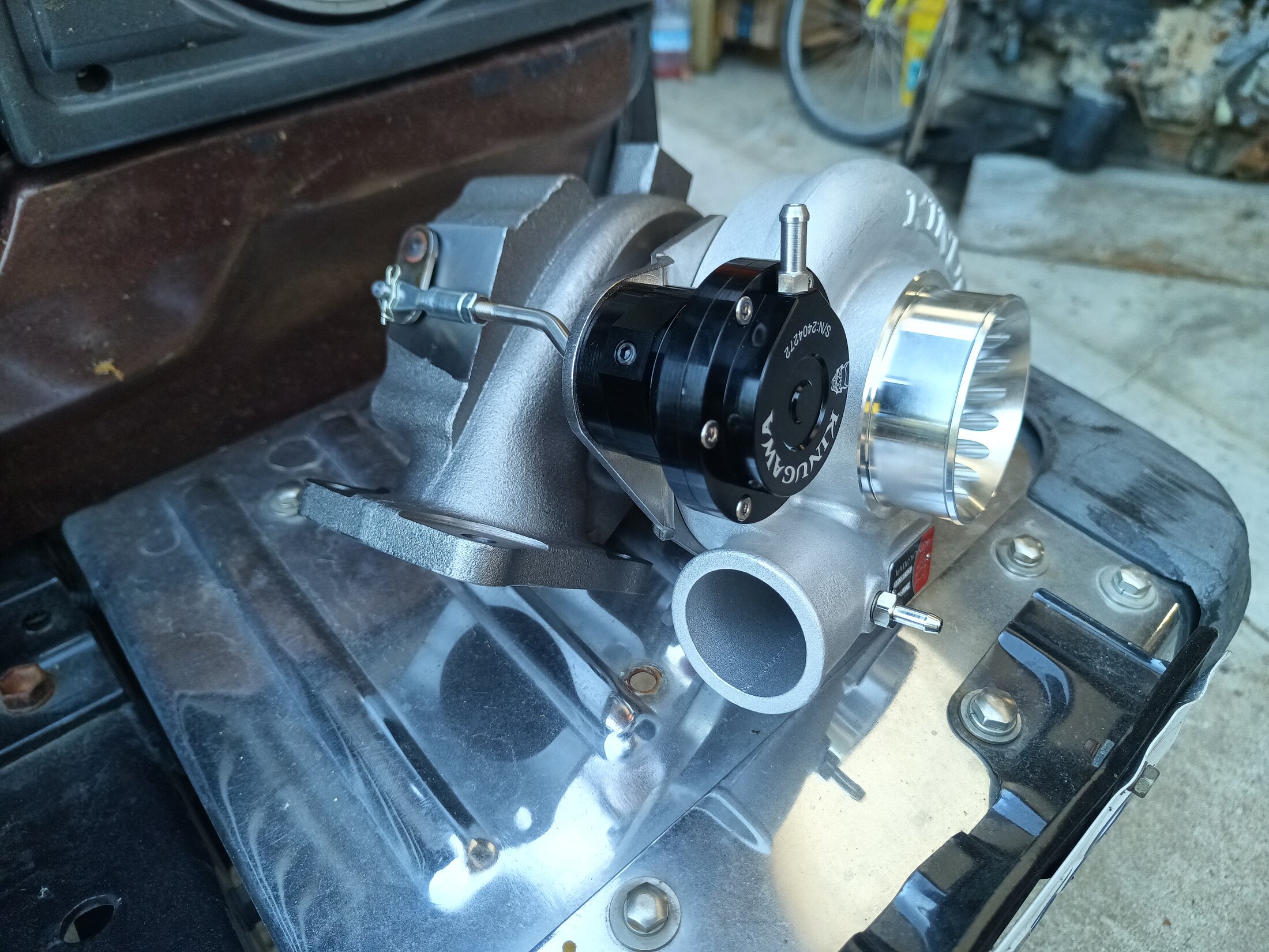

I also built a stand and got my spare engine ready for turbo mockup. An easy out that actually worked (with lots of Kroil), huzzah!
Manifold, turbo adapter, valve cover and rod cover are off to get ceramic coated.
