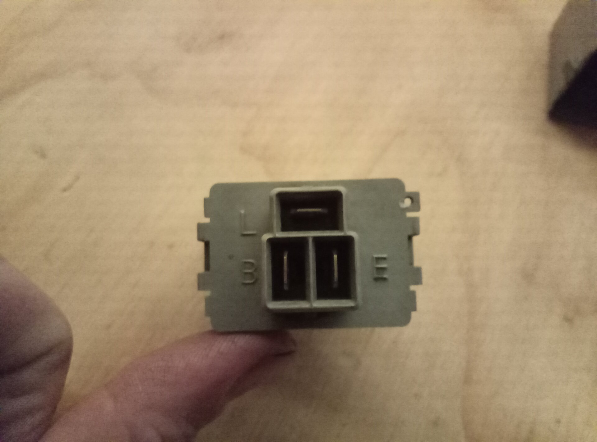

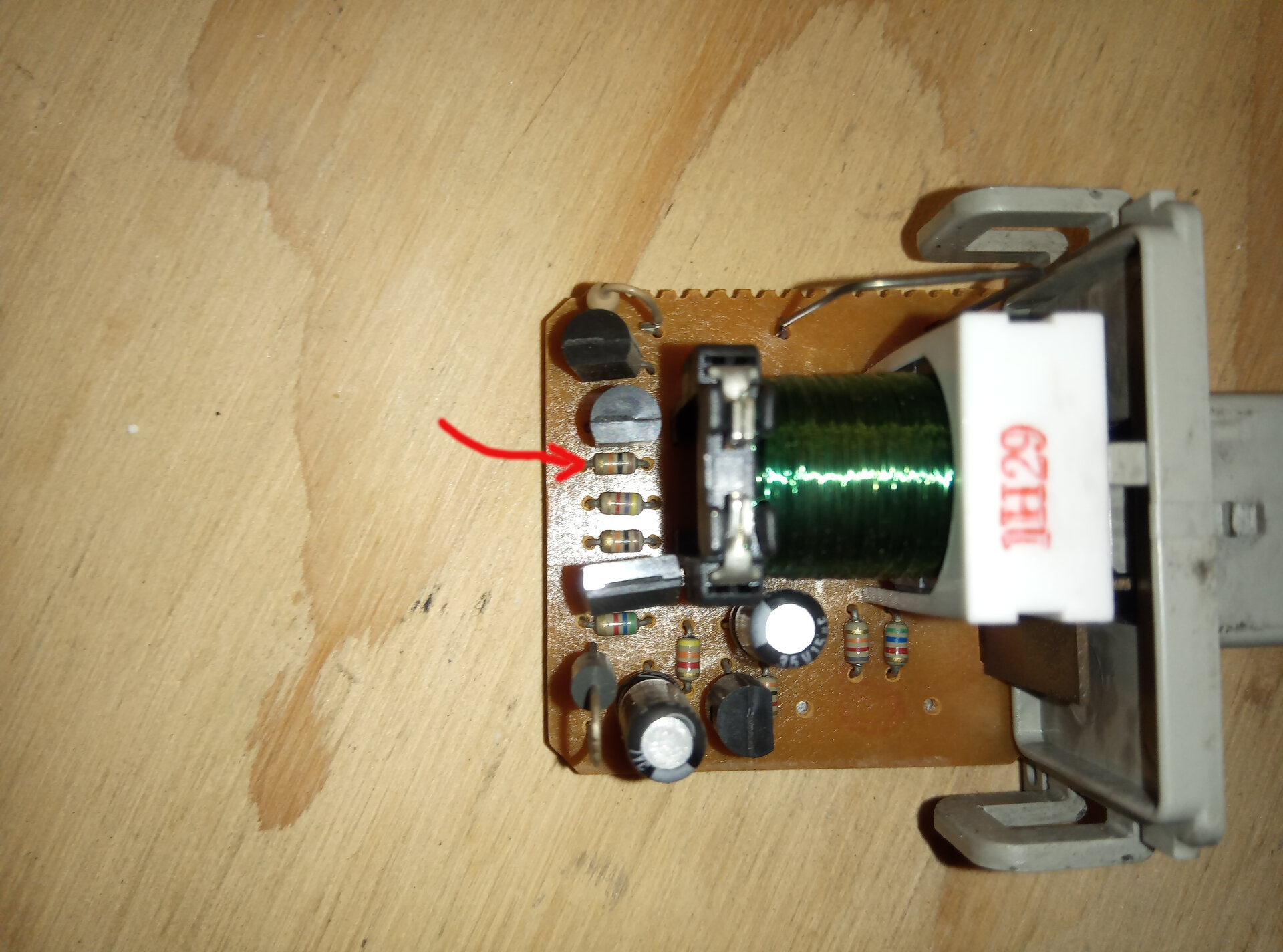

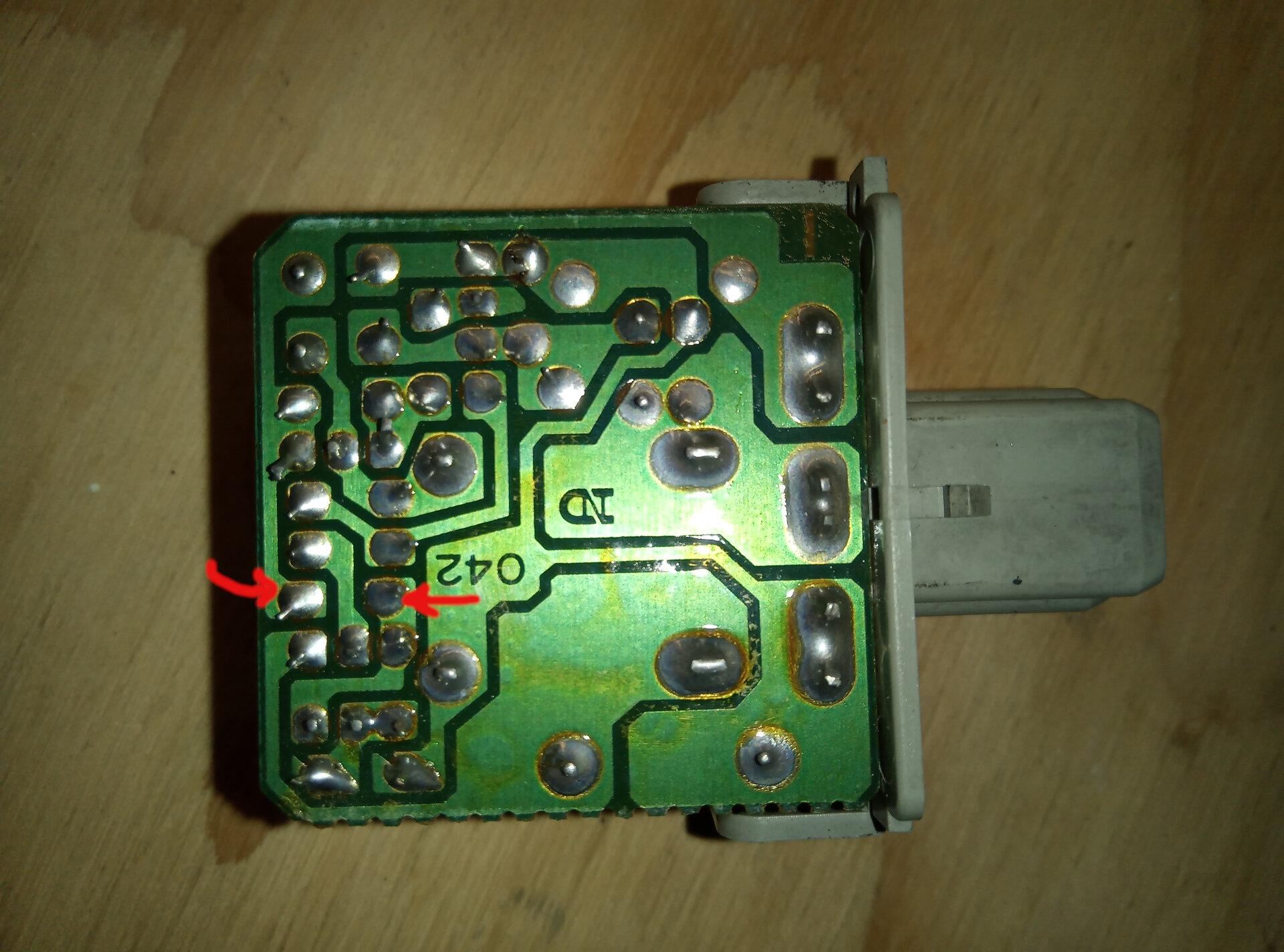

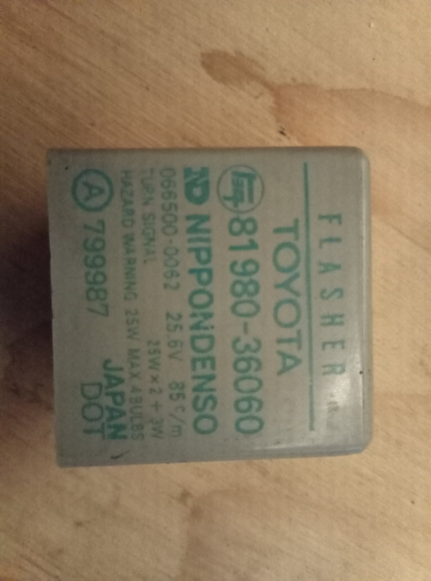

My cruiser is 24V, so my flasher of course is different! It's been 12+ years since I muddled through the few EE courses I needed.
I shall display my ignorance and take a guess that it is this one that I need to remove, indicated by my crudely drawn red arrows, correct?
View attachment 3217678View attachment 3217677
That looks like the correct resistor (same value/color banding). To be sure, if you're good with soldering, just remove the resistor, test the flasher & if it works, you're good to go!
That's the ticket, thanks! The turn signals and emergency flasher now flash at a reasonable rate with the LED's.
It should be noted that this seems to have disabled the 'missing bulb fast flash' function.
