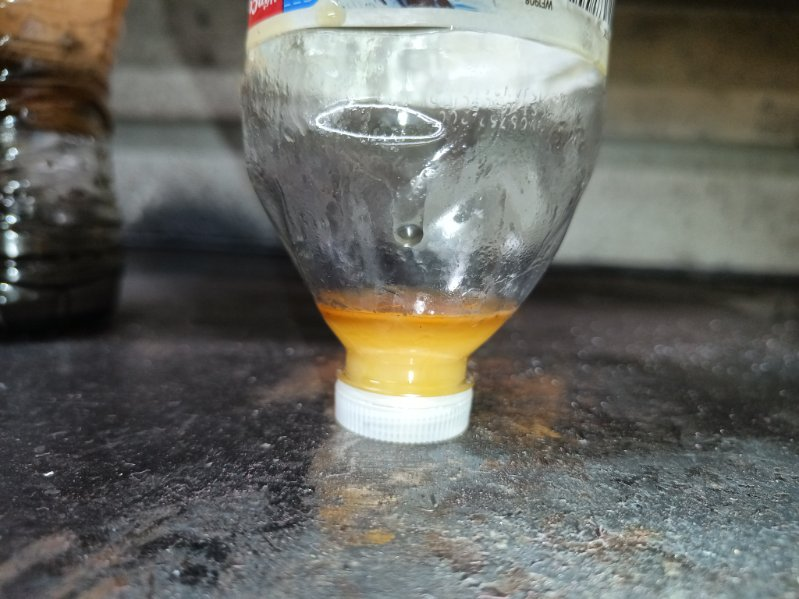

I checked my PVC catch can and found a mixture of oil and something thinner, like water.
Putting it in a clear container, the mixture separated with the black oil on top and the clear yellow liquid underneath. I put some through a coffee filter and ended up with a brownish liquid.
What could it be?
Diesel? Sure smells like it.
Water? Some say catch cans will gather condensation from the crank case in colder weather.
Coolant? It does not look or smell like coolant (I use Toyota Red).
AT-205 Mechanic in a Bottle? (I put some in my oil after my oil leak started to at least slow it down).
I decided to a do a simple scientific test to see if it burns!
...it did not.
After that inconclusive test, I decided to add water to it. It instantly turned an opaque yellow color with a thin film of oil on top. This makes me think it isn't water, as I would have thought it would have simply diluted the color more.
Anyone have any insight or ideas?
