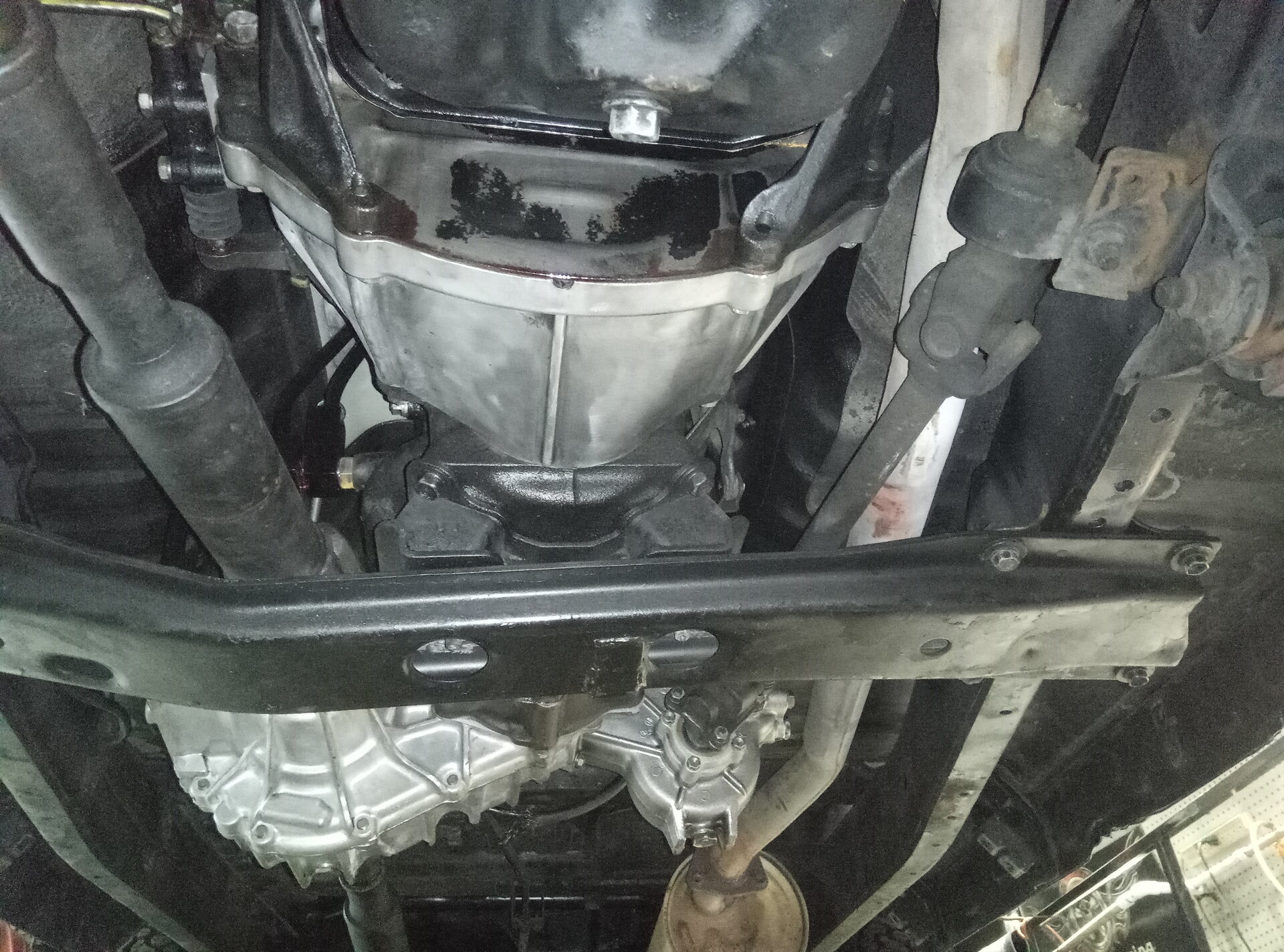

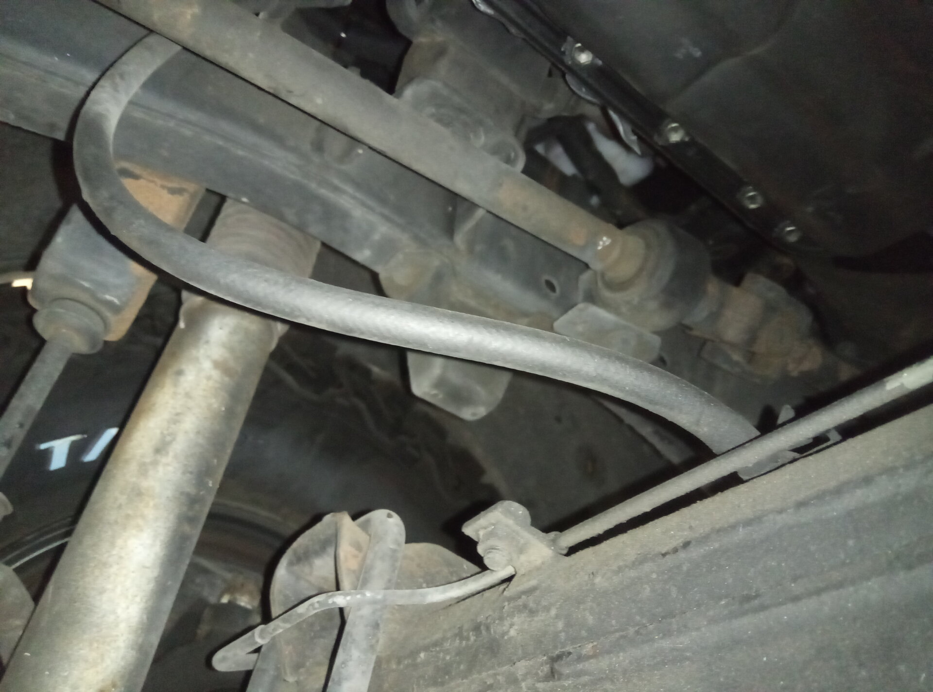

In retrospect, I should have just bought a full rebuild kit instead of a seal kit, only to find a bunch of other worn out parts inside. When I rebuilt the VF1A in my 4Runner at 258,000 miles, there was nothing noticeably worn out besides the seals. But then again, I am the second owner of the 4Runner and the original owner kept very good care of it, always had it serviced at Toyota, and had the complete service history. I have no idea how many owners the Cruiser has had.
Oof, the H55F is a monster compared to the R150F, but I got it back in. In the rain.
I put a little bit of oil in it last night as one last leak test for the welds, and lo and behold, there was one eeny weeny tiny little pinhole leak... It didn't even drip on the floor.
Hopefully a bit of JB Weld will do the trick, or else it's a good excuse to get a spool gun for my MIG.

Driving with the 10% overdrive gearset is just fine, with 5th cruising nicely at 100 to 110 kph on flat ground. RPM's are about 2250 at 100 kph, from about 2500 previously.

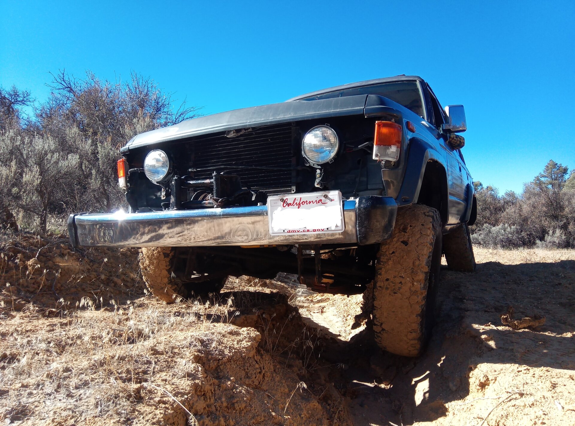

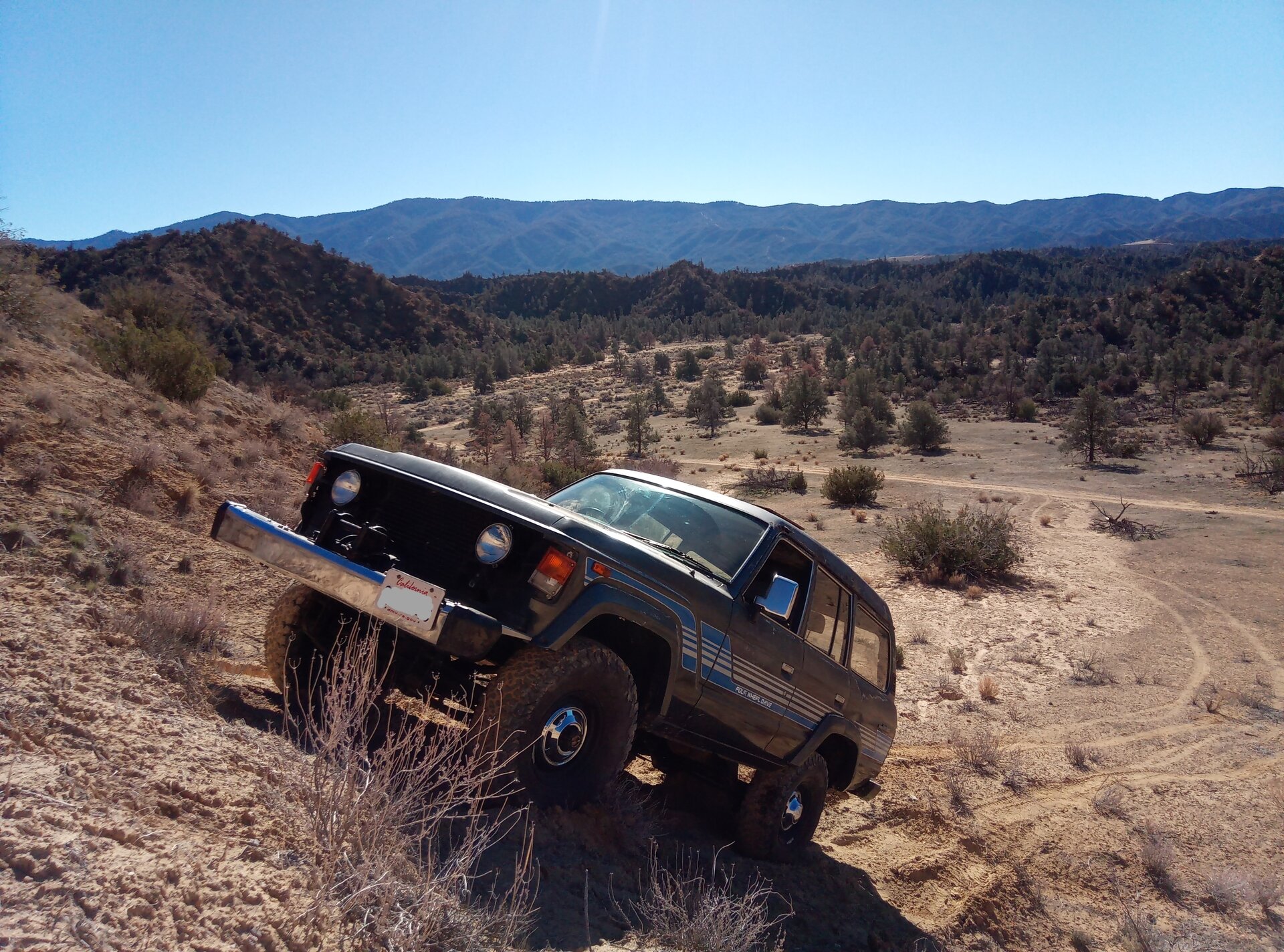

Out for a quick trip up in the hills since all my Christmas chores were done. I tested the four wheel drive and low range, both worked fine. I had trouble shifting from 4 to 2 once, but I just rolled it forward a foot or two and then it shifted fine.

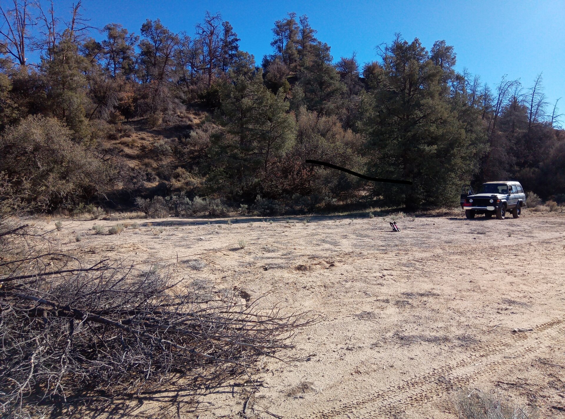

I also tried out the PTO winch on a dead pine tree partially blocking a trail. Pulled it like it was nothin'.

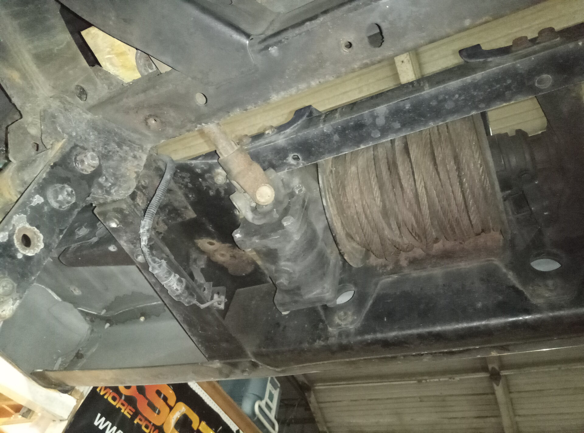

Most of the core support came out without too much fuss. and the left hand inner fender isn't as bad as I though it was, still having all three holes to work with.
Today I will sawzawl the body mount portions of core support off and pull off the front bumper and winch.
The old core support came out without having to remove a fender, but I will need to remove one to get the new one in. One of the battery trays is going to need some work too. The replacement core support I have I had powder-coated so hopefully it will last a tad longer... Also staying away from beach sand and salted roads might help.
