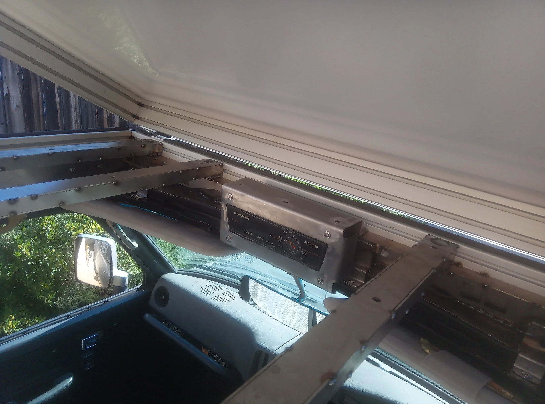

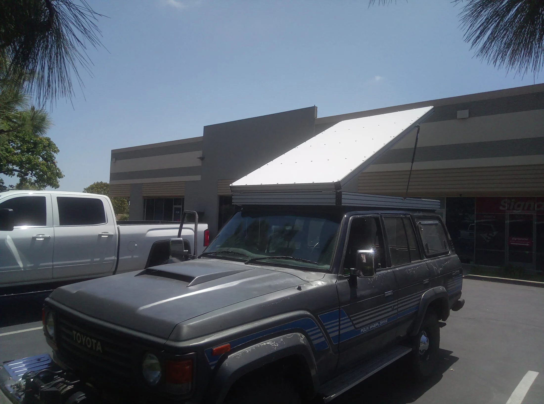

The sign shop finished my roof panel. Everything lined up and it installed without much difficulty.

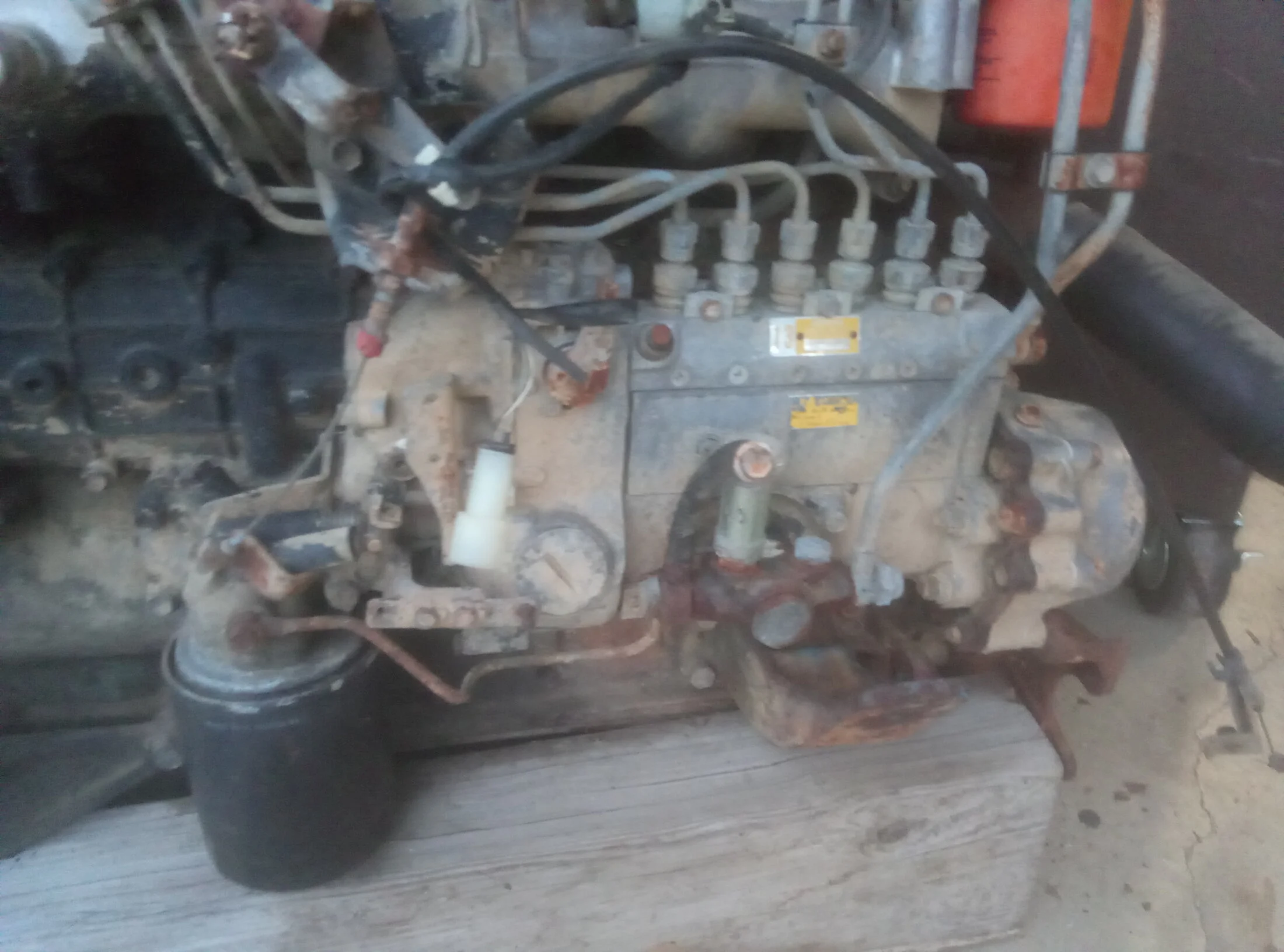

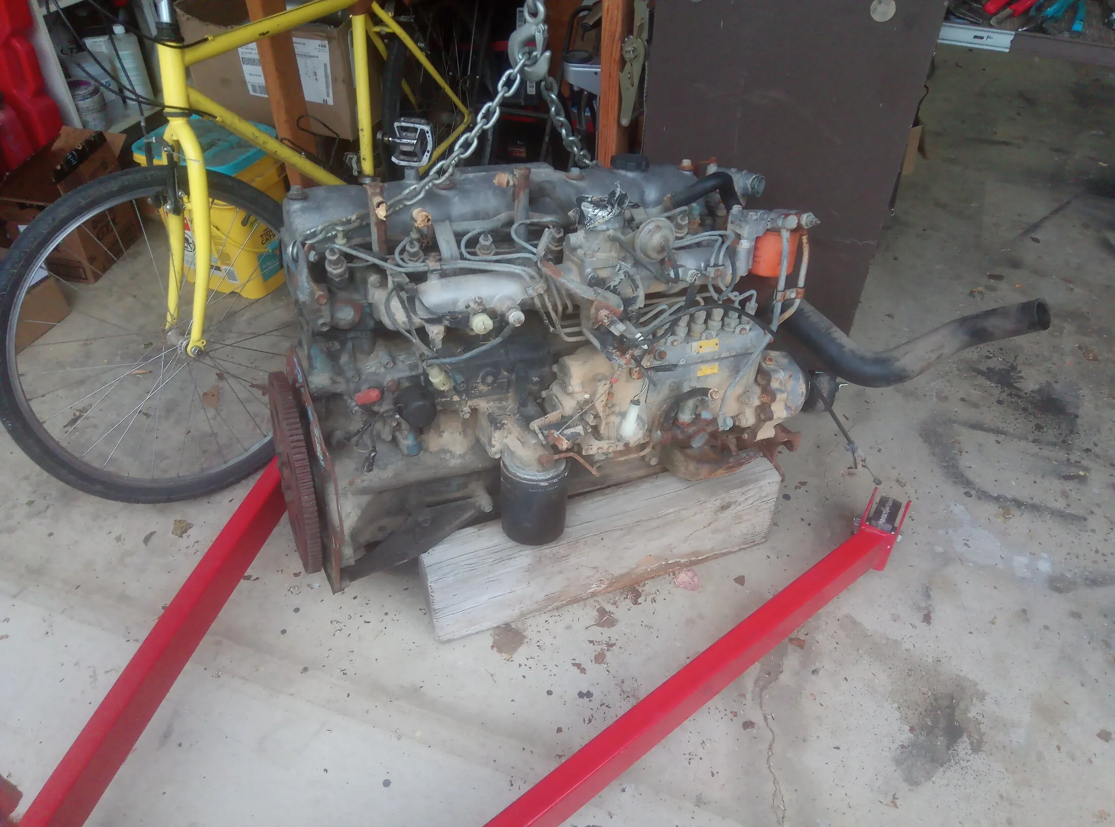

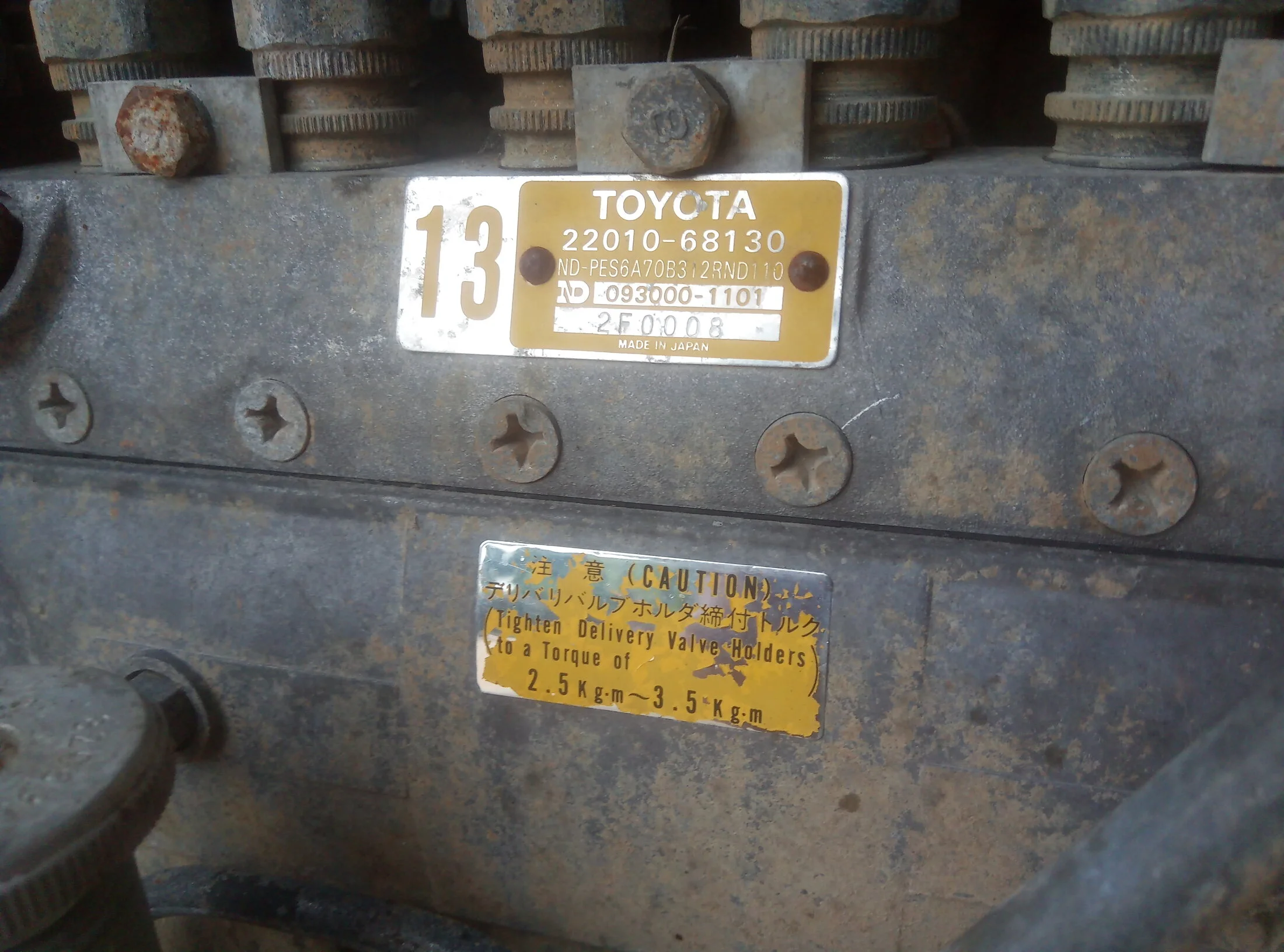

This 2H popped up on craigslist somewhat locally so I went and nabbed it as a spare. It's supposedly from an HJ60 from Canada that had 386,661 km's before it rotted out and got chopped up (It came with a gauge cluster). It has been sitting for awhile but I was able turn the crank by hand until I hit a compression stroke. It's from an automatic truck so the injection pump has a different governor.
@duncanrm is there any advantage to running the governor off of the automatic truck vs the pneumatic governor?

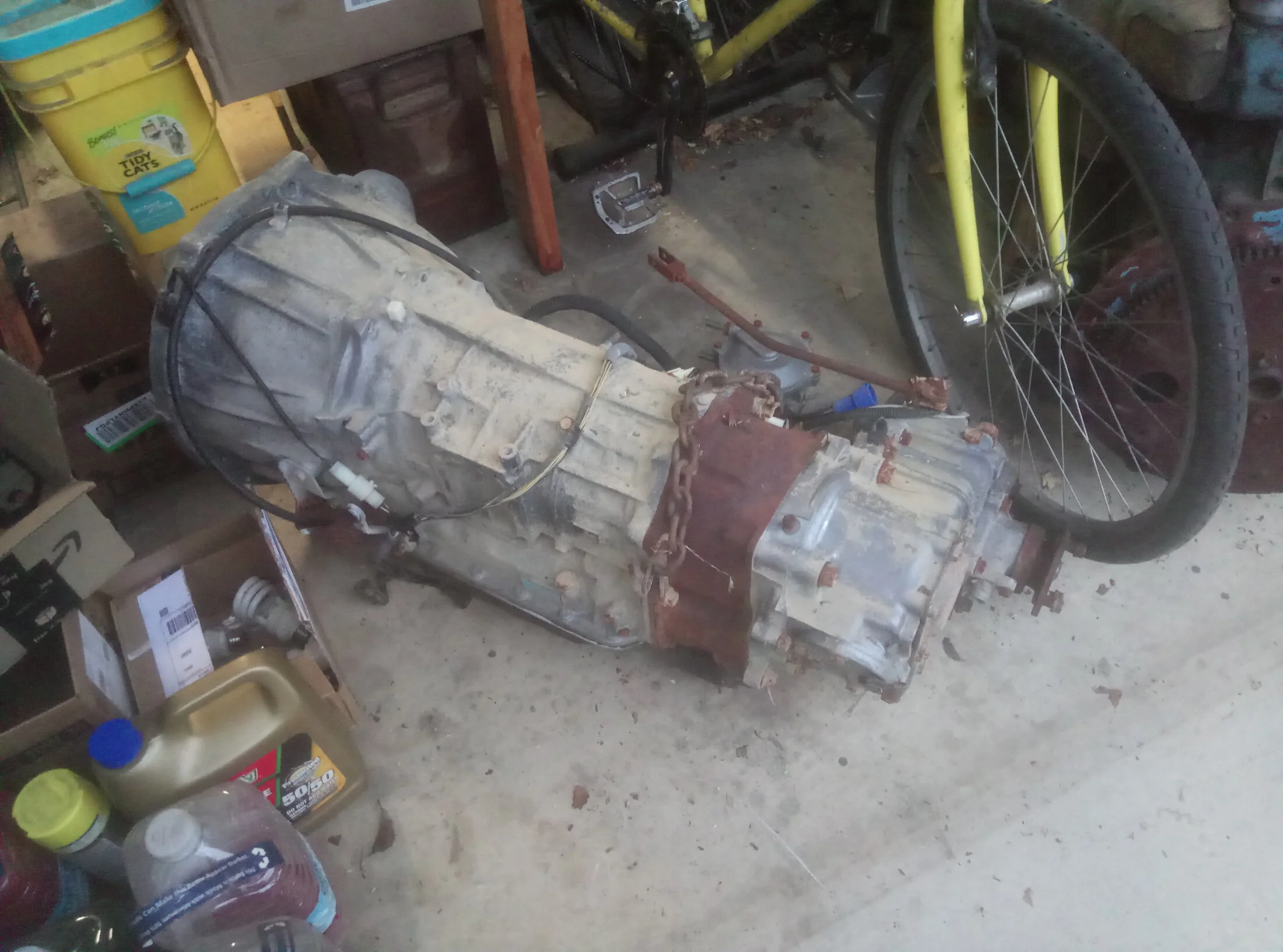

It also came with the automatic transmission, vacuum shift transfer case and an assortment of bits and bobs that I hope to pass on to other cruiser heads.
I cant think of any advantage that this pump offers.. I am unsure what the implications of running it on a manual are, its an interesting question!
On the auto tranny 2H, it looks like the "throttle plate" is only used for engine shutdown, activated by a diaphragm with a VSV. The governor appears to have a manual stop lever on the side as well. If so, the engine could be shutdown with a pull stop cable and the "throttle plate" could be removed for slightly better air flow. This seems like it would suit a turbo build.
It would also remove the diaphragm as a maintenance item, but I don't know if that is a big deal since I haven't done mine, or if it adds another maintenance item elsewhere.
I understand the 2H Auto pump and throttle body are pretty much the same as the 12HT. A stop cable can work on the 12HT pump so you're all good there.
Thanks! This is me thinking far (hopefully) into the future. Harumi only has 270,000 Km's on her so the 2H that's in there should last awhile longer.

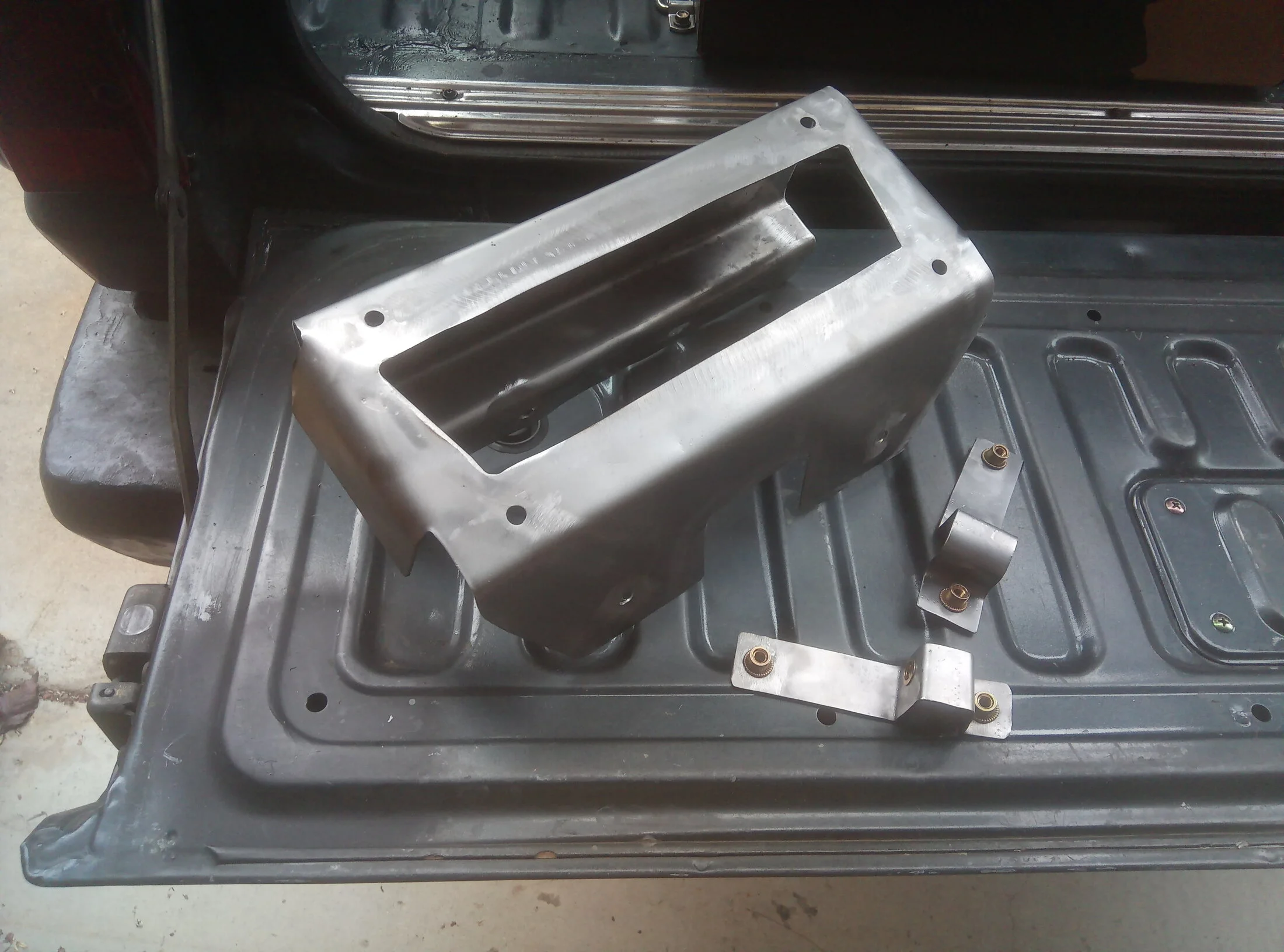

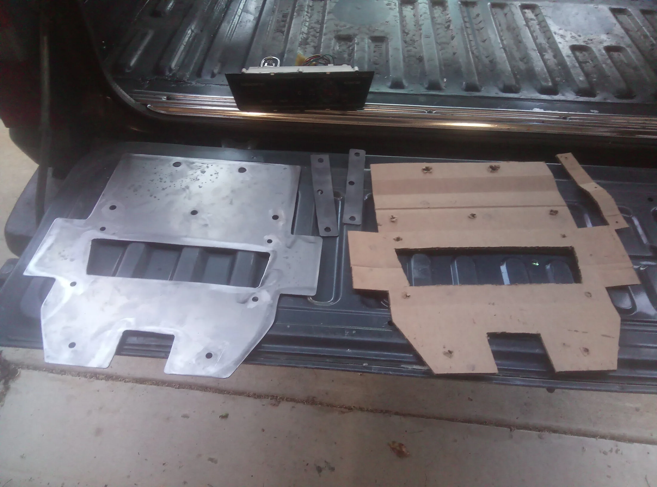

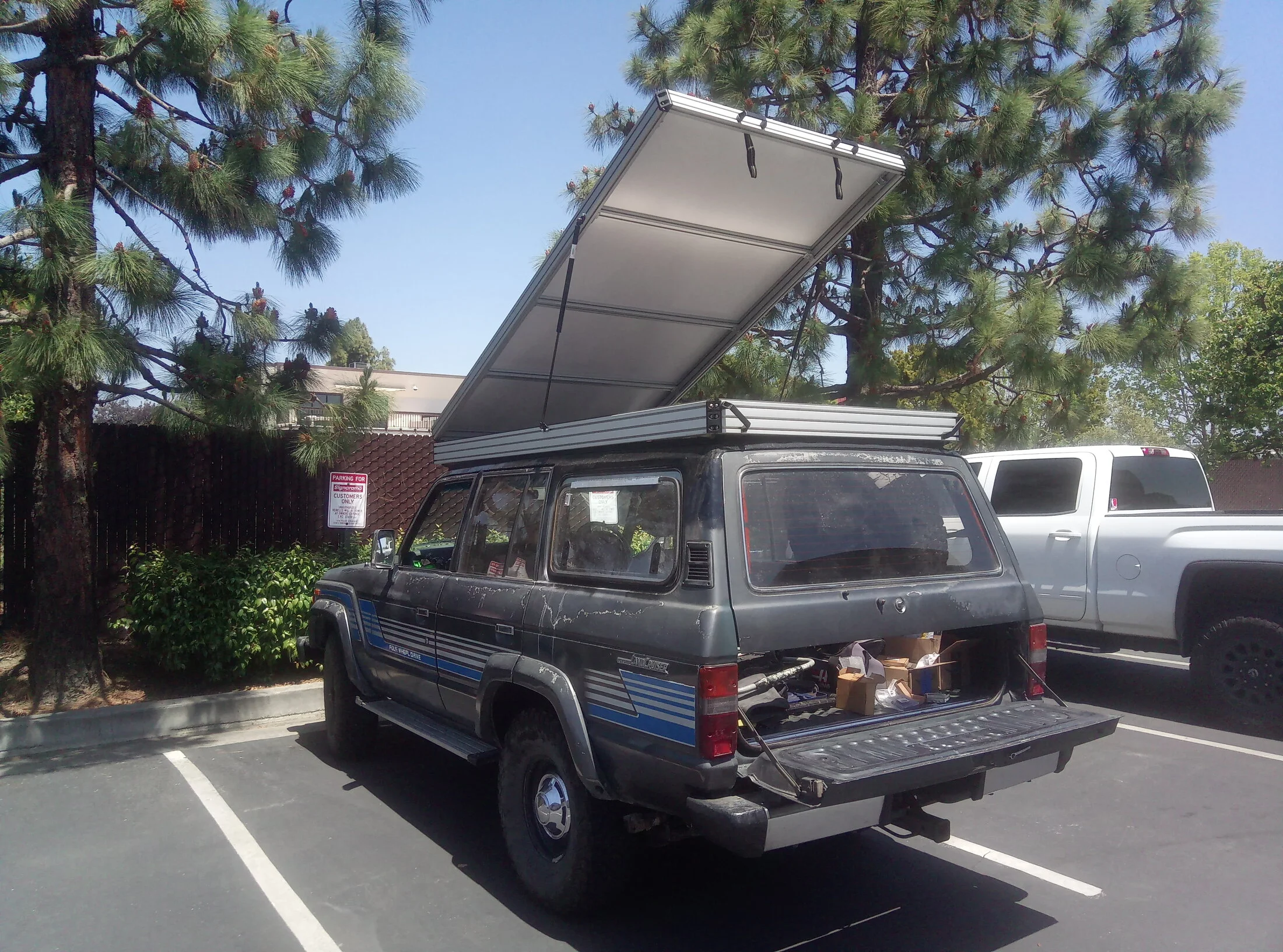

Fantastic write up. I know the time it takes to take pics, post them, write about them and all that. Thats why I never do it.
For the more complex pieces (like your overhead gauge pod)....is that cut at 'work'?
Did you design and extrude the tent mounting walls?
What are you using to sand and smooth all of those welds? Especially in the corners/hard to reach areas?
What are you doing for the underside of all the welded areas? Some places you can't paint after closing them up.
