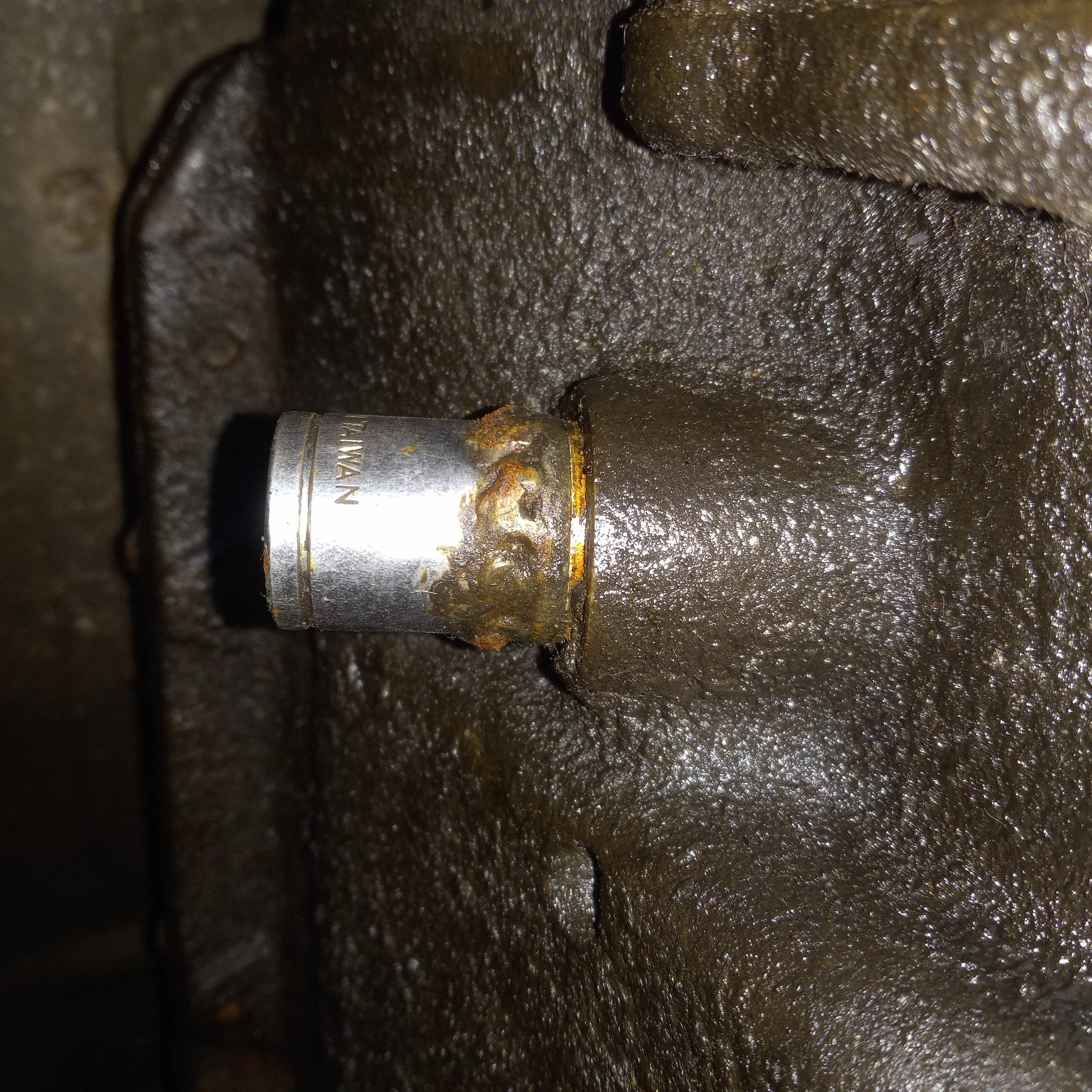

This issue has taken a bit of a turn. I crawled under the land cruiser this afternoon to start checking oil levels, and noticed that I seem to have a leaky rear seal on the transfer case. Oil has been spraying out of the transfer case, all along the underside of the body in a pattern that seems to correlate with that seal. Then, when I went to check the oil levels, I couldn't turn the transfer case check plug. Even better, the manual transmission's plug had been, ahem, altered. Someone, (in their infinite wisdom) had welded or braised a socket head to the check plug for the manual transmission. I'm a little nervous about messing with it, and right about then I started to run out of daylight so I called it for the day. Sometime within the next week or so, we're going to fit a ratchet to it and see if we can turn it. I've attached a picture of this latest little redneck engineering. Has anyone ever seen something like this? Back to the probably leaking seal, I'd be curious if any of you would care to rate how complicated that fix might be. I've attached a photo of that spray pattern too. If you zoom in, you can see just left of center of the picture, exactly where the spray pattern ends.
My guess is you have the common issue of the seal failing between the transmission and the transfer case, yielding in the transfer case getting overfilled. First thing I'd check the level in the transmission via the hillbilly delux engineering solution:). Once you have confirmed and filled this to the factory level. Move onto the transfer case and do the same. Drive the truck for a few hours and then recheck the levels in both. If you have more in the transfer case, this will confirm the seal failure. One can remove the transfer case in situ and do a rebuild. @cruiseroutfit has rebuild kits which are first rate. Easy job if you are comfortable with basic maintenance. I'd also plan on replacing all of the drain plugs and crush washers while you're in there too.

No, I'd just remove it via the current socket but go easy and be prepared for the potential of stripped threads or a different thread than factory. Either way you need to asses how much fluid is in the transmission.
Thanks for all of this. Checking that trans fluid was already task #1, but especially now with this additional information. We're almost certainly just going to drain the old fluid and replace it all anyway; that's an overdue task. I also did finally find that thread about "best transmission fluid" options. I'll be going with Redline for this refill. Depending on what I find, might just go ahead and do the rebuild while I'm at it.
