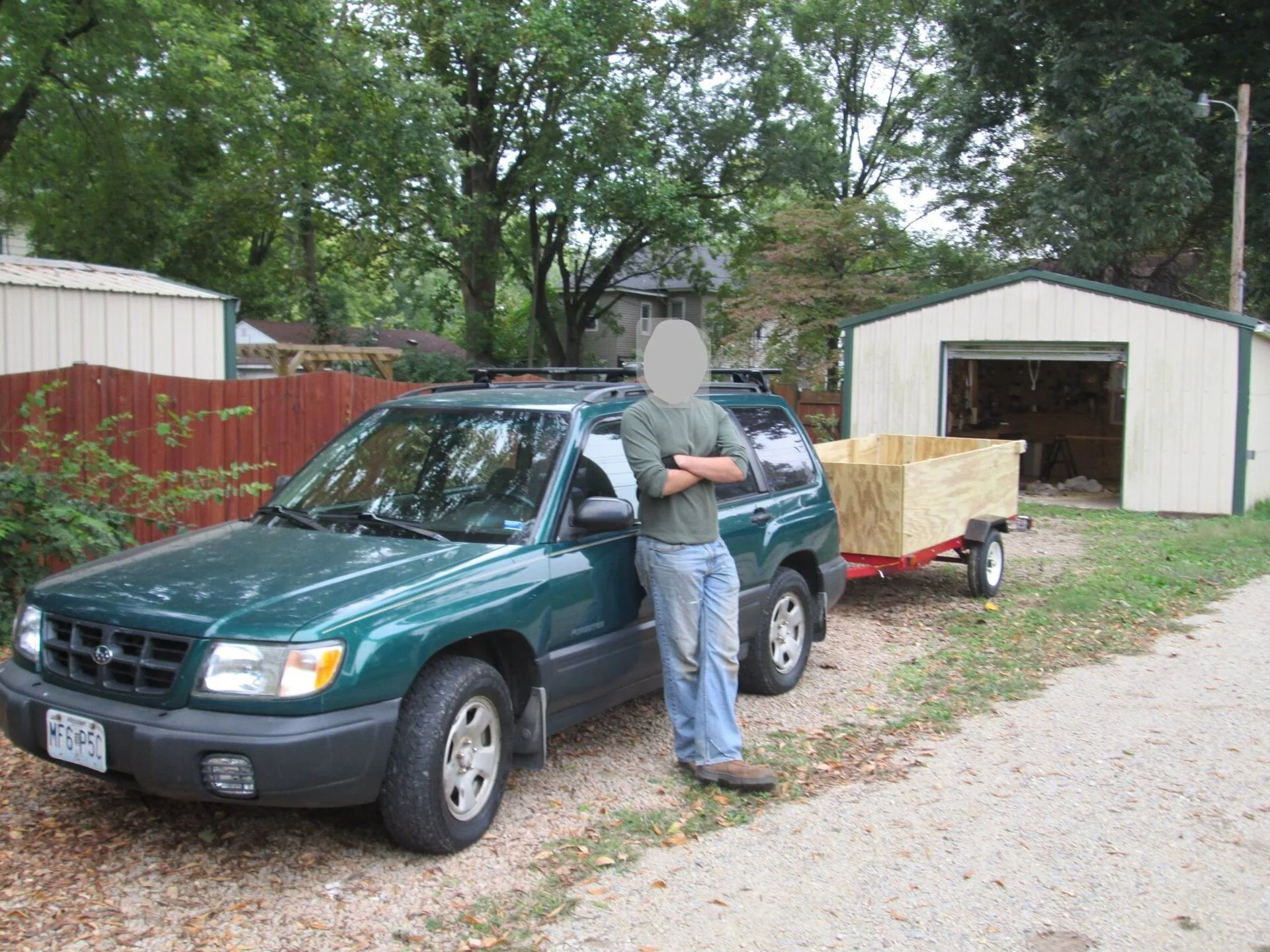

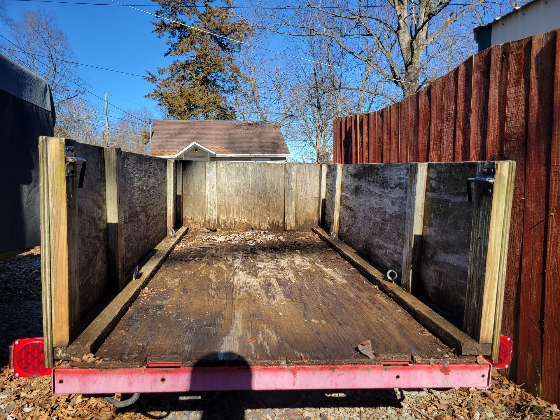

I bought this little trailer all of the way back in 2015 to pull behind the Subaru Forester I had at that time. It was $250 from Harbor Freight and I spent around $250 more to put 3/4" plywood beds and sides on it. Since then we've made hundreds of trips to the city yard waste disposal area (leaves and limbs), trips home with appliances, trips hauling tools for other projects, and many other little trips with this trailer. However, using it for yard waste meant that sometimes it would sit outside for a month plus with leaves/yard debris in it. Needless to say, over the past 8+ years it slowly rotted out (and treated lumber kind of sucks these days).

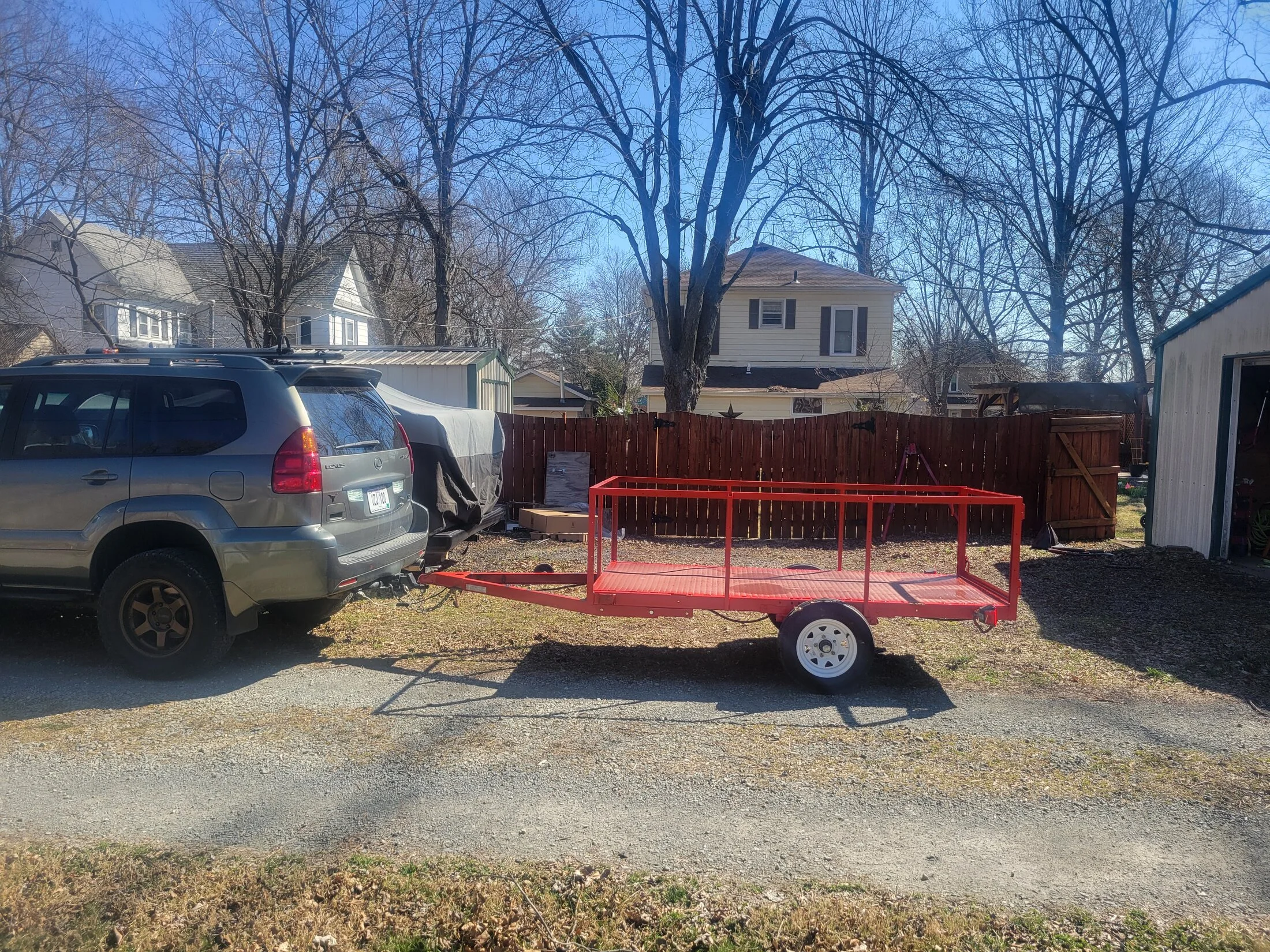

The current state is below. I ordered just shy of $400 in steel today to re-do the deck with diamond plate and re-make the sides using an angle iron frame and plywood. I could have bought a new trailer ($2K), but I really like the size of this one as it's super easy to move around by hand. Also, with the solid sides and bottom, I've successfully hauled thousands of dollars of tools inside the trailer in the rain and kept them dry by putting a tarp over the top of the trailer and holding it down with roofing nails.

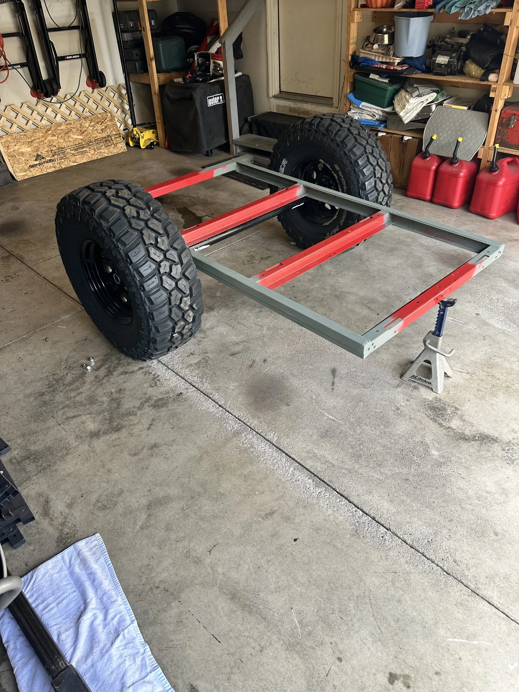

Cool. I’m currently welding my frame and extended it to 6’ with the original tongue and bed frame rails! Got an 11’ 2x2 tongue to weld on then building a wood box and rack around the whole thing! 3500lb axle and 33” tires.

Where’d you position the 2x2 main tube? Did you pierce the cross members, or weld it on underneath?

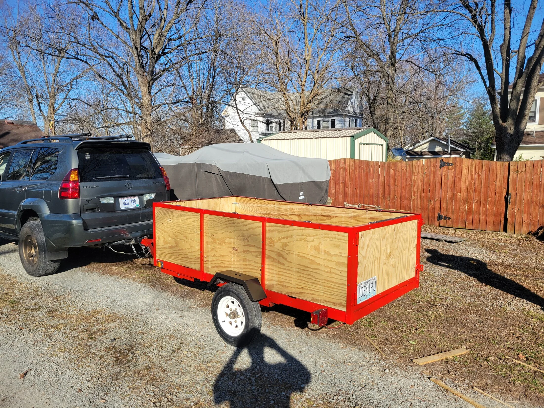

Here is the end product. It was OK. I rebuilt the whole tongue and added diamond plate in the floor.
A few weeks ago I used it to haul about 600 pounds of steel stock home, cut in 10-12 ft lengths, and stored diagonally. This seemed to warp the bed a little bit. I probably should have reinforced the frame a bit more underneath. Or built a new frame from scrap. The frame in these - 1/8" C channel - is just too weak and flexy. I'll bend mine back down with the bucket on the tractor.
It has been a very handy trailer for lumber yard and dump runs.

I put the frame right on top of the 2x2 and just welded it at the seams, where it touched from front to back. I had to notch out the frame in a couple of places where the 2x2 didn't quite touch and I added a couple of crossmembers for my shocks.
I reinforced the whole frame with old steel bed frame rails, they worked out great and made it super rigid.

I’m surprised that the 3500 lb axle and suspension you upgraded to isn’t enough for how you first loaded it up. I went with a 3500 lb torsion axle, but was toying with the idea of having the axle derated to 3000 lbs when I was putting the axle order together to improve the ride with light loads. I did rough calcs on my anticipated loaded weight, which came out to around 3200. So I decided to go with the full 3500 to give a little cushion. I’m planning to set the fenders 5” off the tires with the trailer empty to make sure there’s always enough clearance to keep them from rubbing. The axle builder provided a suspension travel chart, which helped figure out the fender spacing.
I’m also planning to use angle iron to reinforce the existing frame. But I’m going to run the angle on the bottom to give the axle something more stable to mount to.
