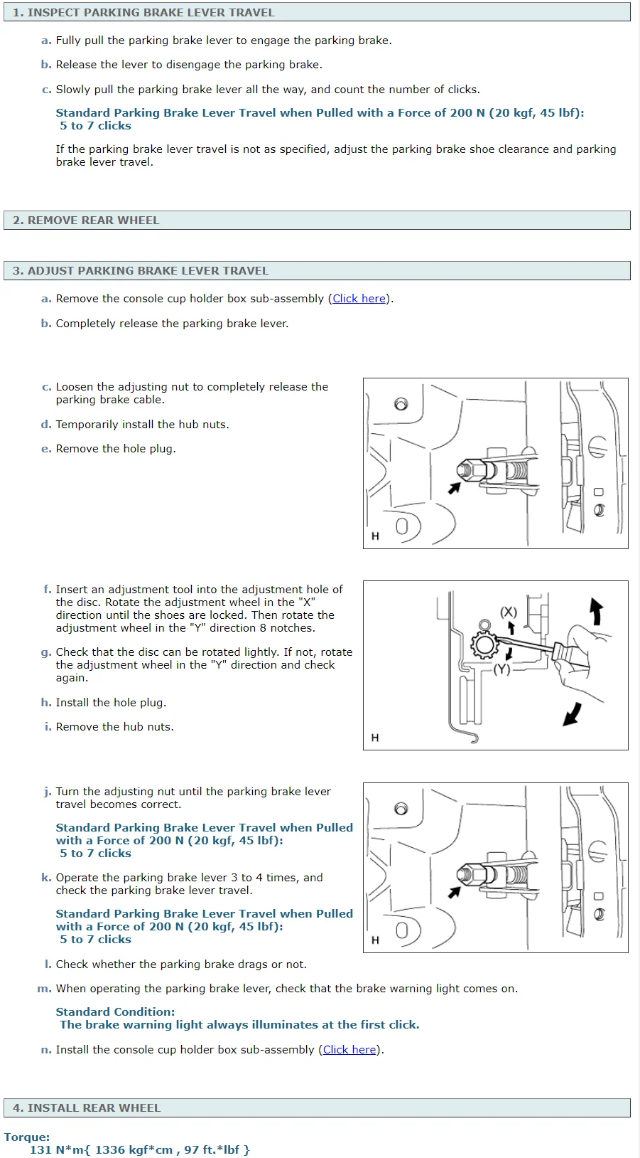

I purchased my first LC last Fall and have been loving every second of it. I just tried to use the hand brake for the first time (parked on a steep hill) only to find that it did not work. When I lifted it up, it would not stay in place and just went back down to the original position. Obviously, I wish I had checked this when I purchased the rig, but hindsight is 20/20. Any thoughts on what might be going on and a possible fix? Thanks in advance for your help!
In can be two things:
Not enough tension on the handle-in that case you can pull out the cup holder (just yank) and there is an adjustment wheel.
Or it’s the parking break themselves. They are inside the drum part of the rear disk. They are adjustable without removing the whole assembly. There should be a wheel on the back you can spin to adjust.
If that doesn’t work it’s easy to pull of the disc and see what’s going on. I had to replace mine at 100k miles.
the local inspection office tried to fail me for similar.
As long as you have sufficient e-brake pads, the rest can be adjusted. It’s in the FSM or a competent mechanic can adjust.
It's a simple adjustment. Something that needs to be done manually on occasion and not a sign of something inherently wrong. It's a very old school type of adjustment for anyone that's familiar with star wheels on drum brakes in cars and trailers.
I recently adjusted mine after it got my attention parking on a slight slope with 8k trailer in tow and not holding well. The instructions may look more intimidating than it is.
As I've adjusted drums many times on other vehicles, I'll say I cheated with a shortcut and turned the star wheel on each side up two clicks, and tightened the lever 3 clicks, and all was golden. They grab evenly on both sides, don't drag, and most importantly brake confidently when set. For those new to this, I'd recommend following the FSM which asks to completely release the brake cable first.
Thank you all for the help! I will hopefully be able to try these methods soon to fix the problem. Much appreciated!
