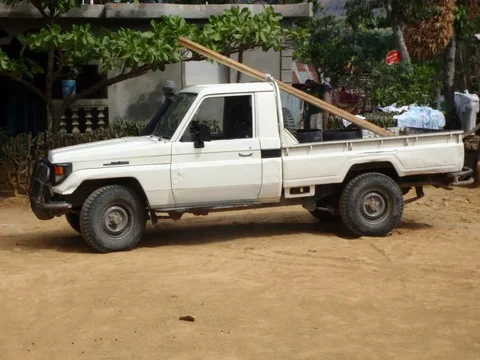

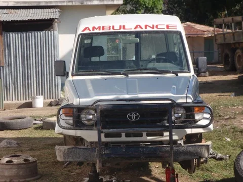

WELL WE STARTED IN THE DOMINICAN FOR THE FIRST NIGHT AT A MEDICAL STUDENTS APARTMENT. WE CAUGHT A BUS THE NEXT MORNING TO THE HAITI BORDER ( ABOUT 4-5 HRS). WE WERE PICKED UP AT THE BORDER BY THE LANDCRUISER THAT NEEDED REBUILDING. I POKED MY HEAD OUT OF THE WINDOW AND LOOKED AT THE FRONT END WHILE WE WERE UNDER WAY AND SAW WOBBLE WOBBLE.
I AM NOT GOING TO HAVE ANYTHING TO REBUILD! WE DID HOWEVER MAKE THE 5 HOUR TRIP BACK, 90 PERCENT IN 2ND GEAR DUE TO ROAD CONDITIOENDNS.
I ORDERED MY PARTS FROM 4 WHEEL AUTO IN CANADA, GREAT PEOPLE! IVE ORDERED FROM THEM SEVERAL TIMES.
ANY WAY I GOT TO REBUILD THE FRONT END ALONG WITH THE HELP OF THE LOCALS. ONE OF THEM DROVE A KING PIN RACE IN BACKWARDS WHILE I WAS NOT WATCHING BUT WE GOT IT OUT UN HARMED. WE ALSO REPACKED THE REAR BEARINGS AND CHANGED FLUIDS. I WAS REAL HAPPY WHAT WE GOT ACOMPLISHED THERE IS NO WAY THAT THE CRUISER WOULD HAVE MADE IT MUCH LONGER MUCH LESS TILL THE MEDICAL CREW GOT THERE.
