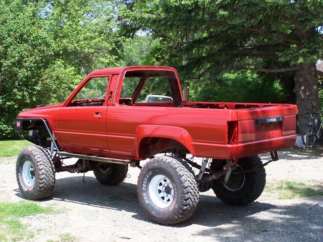

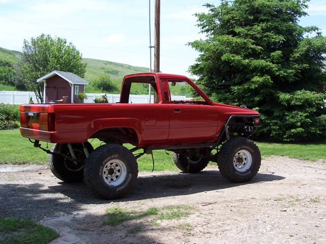

Finished my rear fender triming and sprayed a second coat. I was able to roll a new bead on the cut part of the rear fenderwells and weld it all back together so it looks real sanitary and clean...
Looks slick! You may not wanna wheel it. NOT!!
I'm totally diggin' the 2wd fenders and tooob too. May have to adopt that idea for my junk. :D
Hurry up!!!! :p
Don't worry I'm going to wheel it every chance I get. :)
The entire front setup makes it pretty bonkable. I made those fender bars a few years back after I layed the pickup (it was a '94 truck) over in a ravine and couldn't open the passenger door after. They work good so far. Got rid of those pesky park lights too. Body damage is one thing but it should take a mild flop or nudge a tree and everything should still work! I need to make some good armor for the rear corners before I do anything big. I've been enjoying building a clean rig with the trail in mind instead of making everything an afterthought.

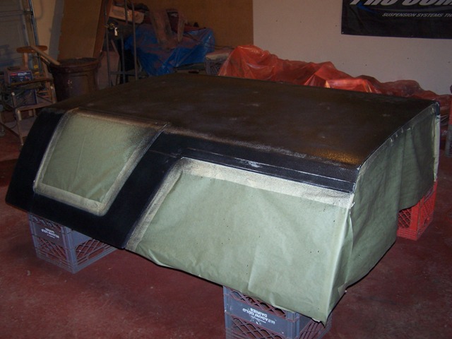

The top is in good shape but some of the texture was worn off and the white was showing through in places. I sanded it a bit and re-textured it with a can of that anti-chip stuff you spray under your paint on rocker panels and such. It dries alot harder than undercoating and the texture is alot finer than bedliner type products. Looks just like the stock texture...
Next is a quart of satin black.

Paint update...
It has been out in the sun, rain and snow, though and there is no fading whatsoever. The cat and other impacts have shown it to be very scratch resistant. I will update the thread when I get it out in the world but so far I am pretty impressed. I think it's necessary to use the hardener to get these results though as without it would be little better than rattle cans without.
