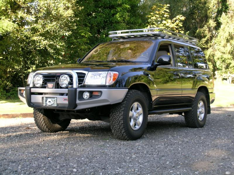

same light with clear lens and yellow bulb on my 100's
Daniel Stern Lighting Consultancy and Supply
yes yellow bulbs help in the fog and in the rain....but to me the reason I really like them is people SEE them and anything that makes the idoits on the road see YOU better is a good thing.
