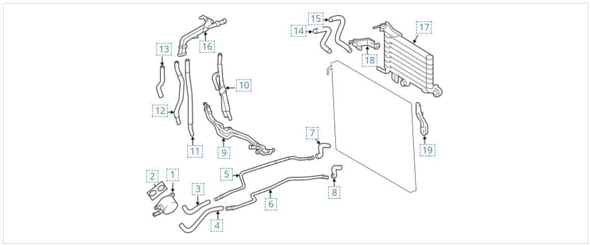

I'm set on installing an external oil cooler for the car and am between a couple options. The two main installs I'm seeing are the OE oil cooler and the hayden one. The OEM cooler is very pricy with all the parts, but It doesn't' seem to route any differently than the universal kits through from what I'm seeing. Part number 9 in the diagram seems to be a hardline that is more or less used in the same-ish manner as a sandwich plate in an oil cooler and routes the lines away and back to rad outlet, right?
The OE oil cooler also seems a bit small compared to some of the other ones I've been seeing. Is there something I might be missing with the OEM oil cooler setup?

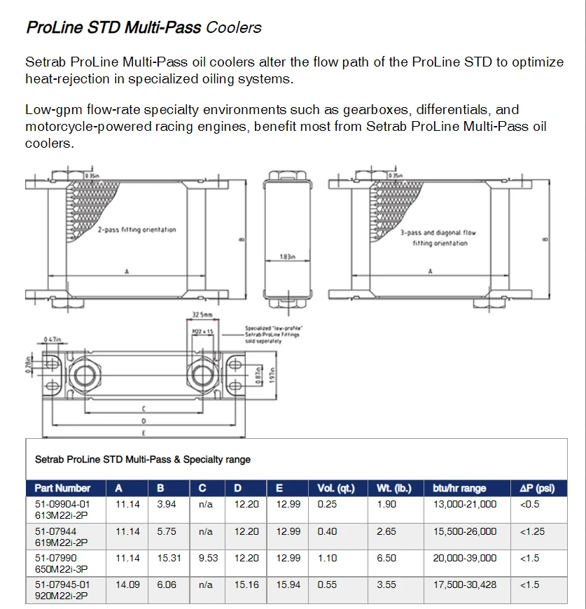

Setrab seems to have a multi-pass 11in x 6in cooler that looks very promising. Might be able to throw it in without having to relocate the horns.

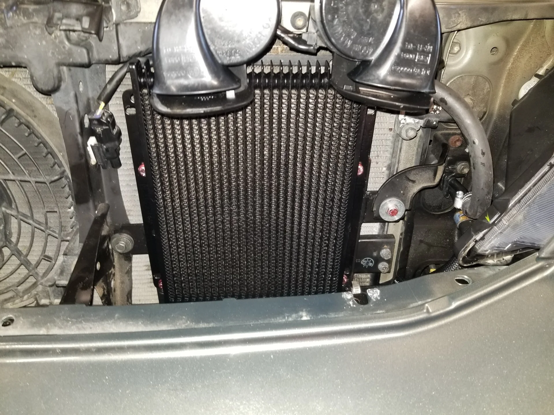

I have a 470 but upgraded the tiny OEM cooler to a Hayden 678. I fabbed a custom bracket and installed it using the OEM mounting points. The quality has been fine with no issues. We've been towing our 3500# wet camper and the temps seldom rise around 170. It does over-cool in the winter so i made a rubber cover that blocks 2/3 of the airflow through the cooler.
