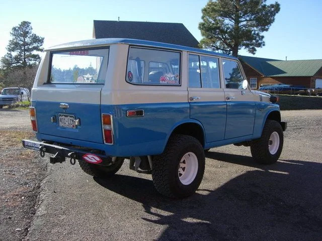

mostly it will look like a stock restoration pig, but with some power under the hood, different drivetrain and some mods like ac, ps, auto, etc, etc. let me see if I can find a pic, color will be the baby blue with white.....

thanks to whomever these pics are?? will look like this but with stock rims and hubcaps and some other minor changes probably, here ya go....
The build is coming along very nice great job, and the blue pig above is awesome. :eek: The painted chick was a bonus.:D

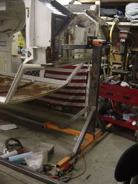

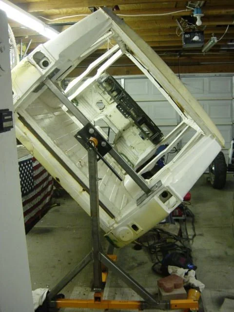

Some quick updates. I finished up my rotisserie for the 55 body this weekend. I am really stoked on the way it came out. Super stable and beefy. You can basically push and pull the whole body around the garage and spin it with one person a full 360 degrees. I got really lucky as I cut one of the supports too short and by complete chance placed it on the rear stand. The top rain gutter just barely rubs on it. I guess when I paint it will require a bit of touch up paint if I hit it, no biggie. It is going to be so much nicer to work on the rust and cleaning issues this way. Underneath the top and under the body crud removal will be much easier. I can basically turn it any way needed and lock it in for work. Rust panel work will be much easier now too.
