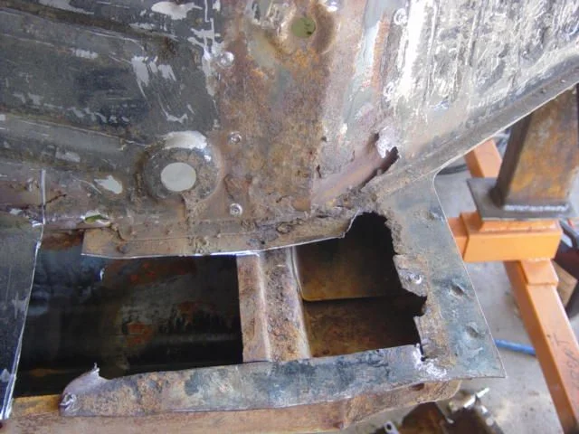

for a pig, the rust is minimal, still I have yet to see the extent of it. Next step is to strip the rest of that undercoating, wire wheel everything and clear off the bottom 1 foot all around the truck, most of the rust is all on the bottom portion, the top and rails are amazingly in perfect shape. So I got bored with the undercoating removal and started cutting into one corner where some rust is. Pulled some of the PO's crap ass rust repair apart, see pic, went down to harbor freight and picked up a saber saw cuz it was impossible to get into some of the small spots with an angle grinder. I was quite amazed at how clean the inside of the rockers are, good clean metal. Hopefully I can fix the patch areas fairly easy.
pic 1 - what I started with

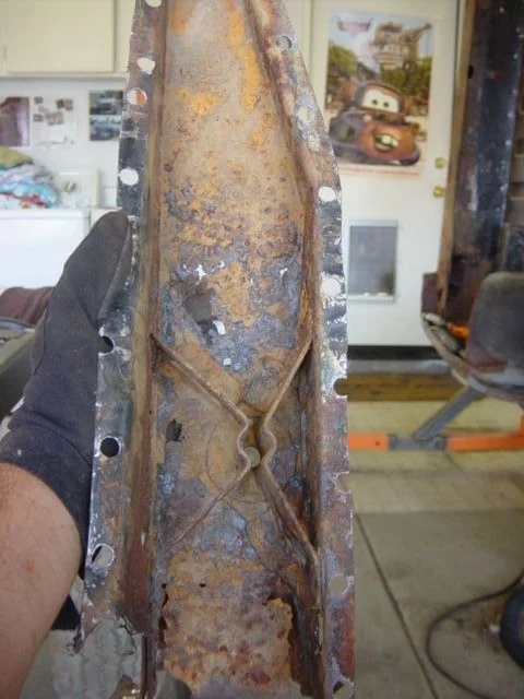

pic 2 -spot welds cut out, pulled this brace
pic 3 -inside of brace, interior bracing completely gone, am going to try to recreate using some tubing and some 1/4 strip. I think I can patch this piece back together.

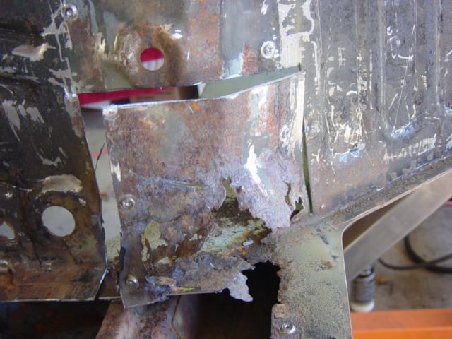

pic 1 - peeled back some of the interior rocker paneling and was surprised to see the interior rocker fairly in good shape minus the front and rear of it.
pic 2 - interior, of pig, directly on other side, some PO's crap ass weld jobs, pryed that s*** off.
pic 3 - after this piece comes off pretty much what I am left with.

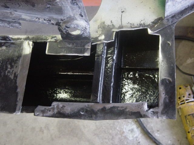

started doing some metal work finally, underbody is all striped of the undercoating, that was a PIA!, also cleaned up the roofline and the old headliner material

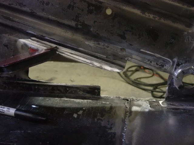

basically for the metal work I made templates out of cardboard and traced to metal and then slowly tacked them in using .024 wire, my first time doing this so I think the end result although not perfect I am happy enough with, it is strong and will hold up well long term, this is not going to be a show piggy, I plan to seam the welds with por putty to fill in any small pinhole leaks. The interior of the rockers were sprayed down with phosphoric acid to kill all the rust and then I let it sit overnight. I then wiped it down with tri sodium phosphate (tsp) and sprayed with zerorust thickly. Rust should not be a problem there ever again.

one other spot that I welded some new metal in....
