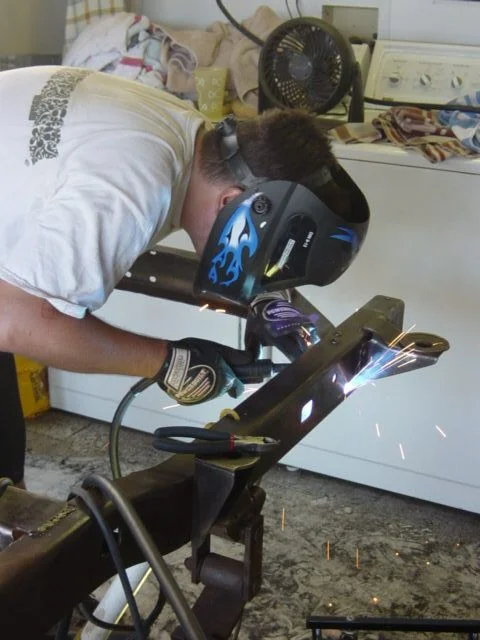

Well, here's an update. Got the frame scrubed down, sanded and zerorusted, came out great, very happy with it. I wish though now I had just somehow sent the frame out to be sandblasted, many hours of wire wheeling, :). Before painting I welded up some bad areas on the frame and cut out a bunch of crap from the PO where they tried to make a towing hitch. Also, 2 of the rivets had been cut down on one side so I decided to lay a weld down to reinforce where the rivet attaches. Slowly moving along, I think I will get more excited once I have the rebuilt axles with discs on the clean frame. Here is some pics, my next post I have a bunch of questions on the rear axle and conversion, so if anyone can help please do. I will ask them here first and if I don't find the answers I will probably start an individual post. Thanks! Noah
