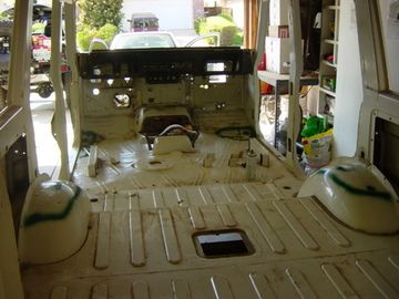

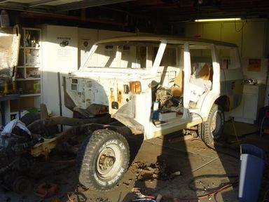

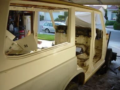

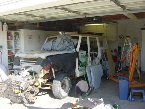

Here's a pic of what I started with, basically a shell and a pile of parts. The dash area was a pain to take apart and the body bolts and steering linkage was even more fun. 100+ heat in the garage and I am sitting there with a torch and a BFH and some PBblaster, lots of fun!
Noah
some more pics, after the teardown and the marking of the spots on the body (green paint) that need some work. I went over the whole body last weekend and was happy to find that on ly a few areas had bad rust, the rest of the upper areas of the body are nice and already have had a bunch of body work done. Some bondo, but not bad, not thick, just to smooth out some dents and the metal is good underneath. It seems that the previous owner sent the body out to be worked on before it came to me.
Noah

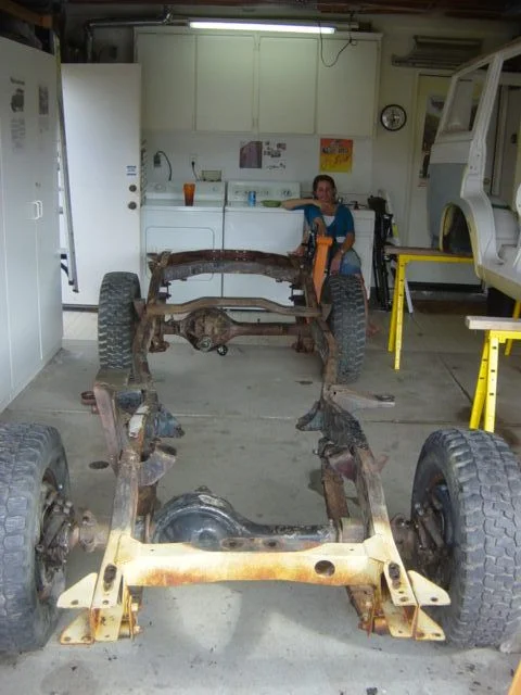

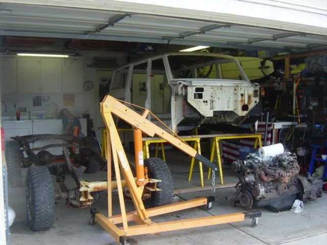

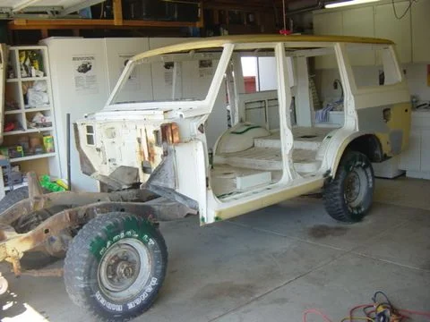

made a little progress / not much
thankfully I was able to get some friends over today to help pull the body off of the project and onto some stands. Powerwashed everything, including the frame. Next step will be to clean up the frame, paint, redo axles and hang the axles and new supsension. To my surprise, everything fit nicely in the garage with plenty of room to maneuver.

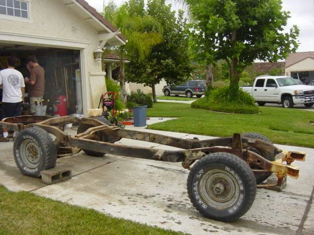

1973Guppie said:
Some final pics of where I am at now. I am going to purchase a pressure washer this week and clean it up before having some friends (hopefully) help pull the cab this Sunday.....
Noah
