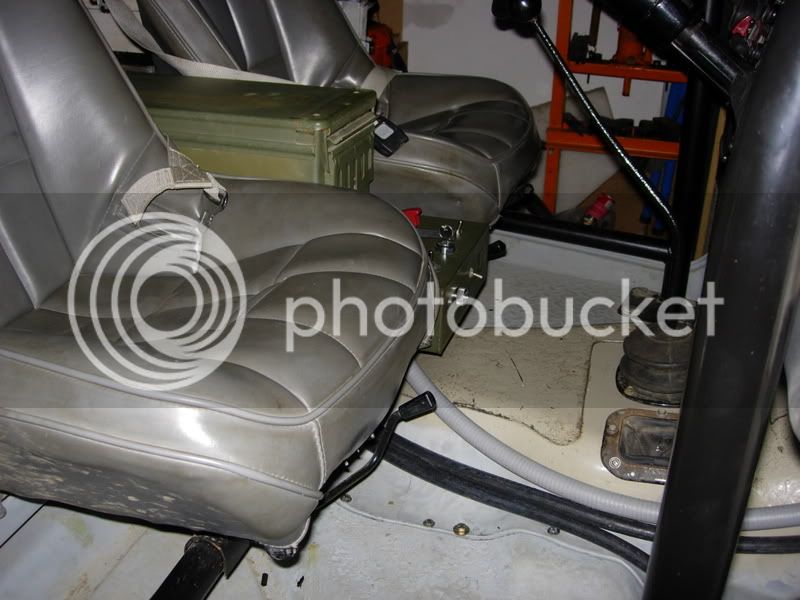

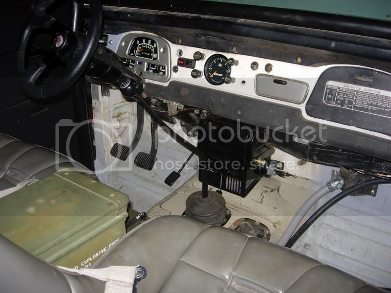

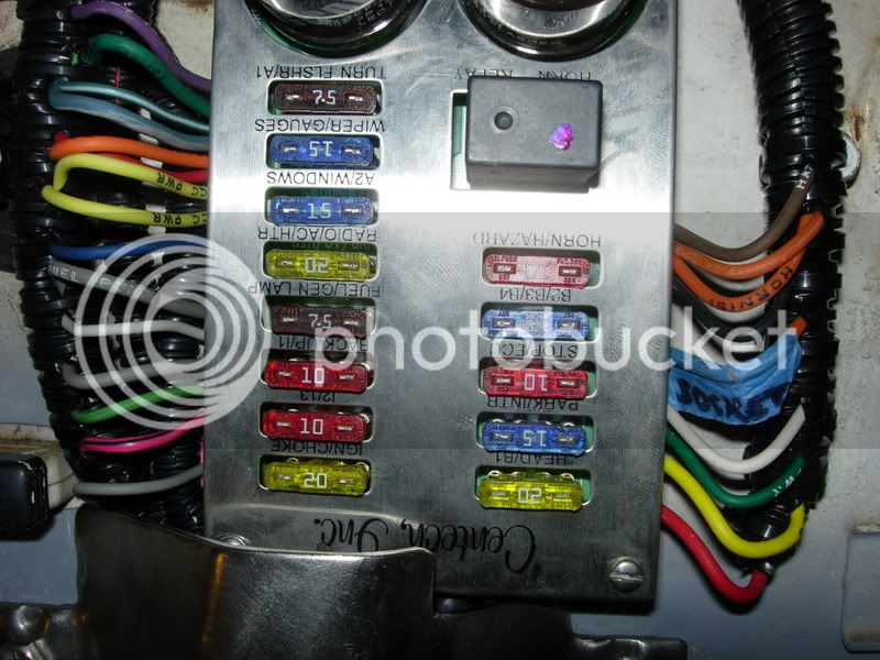

In more positive news... the wiring is complete :bounce:
You can see my stainless kickplate/bracket in the lower left of the above photo and the upper right of the photo below... to give an idea of where the fuse panel is (that panel plus wiring took a LOT of real estate!)...
The grey watertite 3/4" conduit carries all wiring to my console controls (igntion switch, starter button, winch controls, compressor enable, locker controls (pre-wired for future use), and rear heater fan switch (OH! and eventual heated seats :grinpimp: )...
The black heater hose is only just attached & looped back to the rear heater (not plumbed yet); the rear heater is under the console (freeing up rear floor space). I still need to work out a heater (water) control valve: the spare one i have from the 78 doesn't wanna fit on the 70's cluttered firewall. I'm currently planning on simply using a 1/2" ball valve inline.
You'll also notice my shiny heater core: i boiled it out w/ muriatic acid (thanks Tom! :cheers:).
Originally I planned to use the nicer spare '78 heater box, but it wouldn't have fit without relocating my cowl vent knob/mechanism AND rebending my shifter to clear the box's vents.... so back to the '70 box.
It turned out I had to use the spare '78 core in the '70 box cuz the PO installed a cupholder on the heater with sheetmetal screws... right through the heater core! :doh: I learned that the only reason it didn't leak before I boiled it out was because it was SO clogged that no coolant flowed in or out of it anyway. I welded shut all of his screw holes on the heater box & gave it a quickie paint job.
I still need to find hose for the defroster ducts which I'd like to have functional. It's about 2.25" in diameter. It'll be dang tight on the driver's side w/ the hi/lo range lever in the dash! I also need the square rubber boot in the (early) air duct if anyone has leads on this: mine's dry & cracked.
My heater ducts are flex tube from a "retired" PAT bus. Look fine, work well. I'll try to remember to take a pic and post it.

fuse box looks nice just get all of the fuses right side up!
