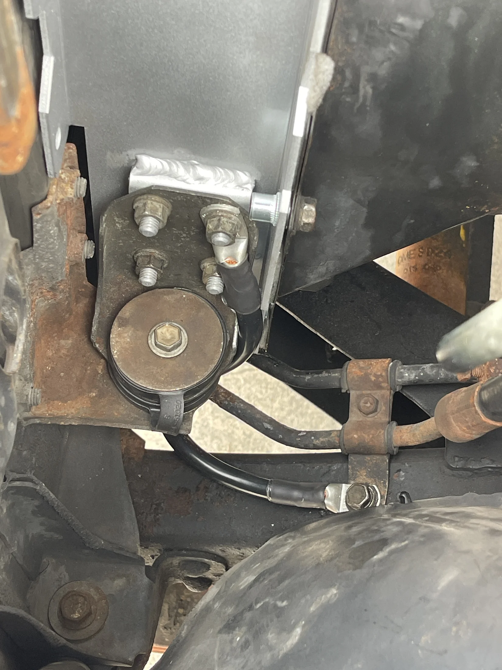

Is this a proper ground for an aluminum radiator in a 62? Just making sure it’s ok over both those brackets.

Just make sure the frame is grounded well if you use that spot because frame grounding is a 3rd class citizen on these vehicle. Body ground is king.
The radiator ground wire could be 18AWG and it would still be oversized. Its purpose is to prevent electrolysis. The current flowing through it is not even measurable.

Agreed, I ran ground straps between battery, frame, body and engine

Ahh I see so frame isn’t the same as say the body fender? I saw those spots in another members photos so I just kind of went with it without thinking much beyond they are both metal. I’ll take a peak around and see if theres something else convenient. I don’t think the radiator shipped with a strap, or if it did I didn’t catch it.
