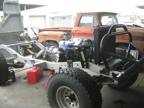

I am at the rebuild portion of my 68 fj40. I am dry fitting everything before the final stage of paint. I have a 350 to an NV4500 and a split t case assembled and mocked up where I want it. My question is: I would like to lower the engine/tranny/tcase to help out with my drive angles and lowering the trucks center of gravity due to the soa, but dont want to lose to much ground clearance with the t case hanging below the frame rail. as the way it sits the engine is level and my t case sits about 2 1/2 inches lower than my frame rail. any words of wisdom before I make the plunge. DSCN2211.jpg

If you are SOA and concerned about driveline angles, the common way to address that problem is to perform a cut & turn on the front and rear axles. Once that is done, and the pinions are pointing at the TC output yokes, you install new drive shafts of the correct length with double cardan CV joints on the transfer case end of the shaft. I would think lowering the whole drive train could lead to other issues like oil pan interference with the front axle or fan alignment with the radiator, etc.

both front and rear axle housing cut and turned, thought about the cv rear axle, but sure is costly. I am running an electric fan, and doesn't appear to be any clearance or space issue with the 350 and the front drive shaft. my frame rails measure 22.5" from the ground and my lowest point is the t case at 19"

new 4 core radiator, the frame is just primered right now once everything in in place and welded, I am going to paint the frame with the por 15 chassis black.
