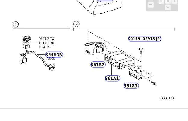

I have not tested, but assume not. From my understanding you are disconnecting the USB port when you install the GROM. There are 2 plugs that get left hanging after install. I assume at least one of those is the plug for the USB. The GROM uses the USB audio input on the 2010-2011 (maybe more) models to push audio through the factory stereo. I assumed it was going to use the AUX input but that is not the case.

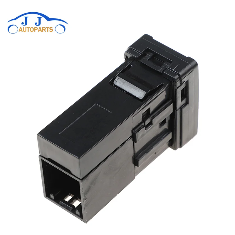

After looking into this further It appears pretty easy. You can pry the OE USB out - thanks to this thread LX USB Port Not Working - https://forum.ih8mud.com/threads/lx-usb-port-not-working.1162585/
With that in mind an Amazon review stated the following -
"In my 2011 Lexus LX, I had to remove the console between the front seats to get to it. On the back side of the usb/aux plug there is a wiring harness that runs towards the rear and splits. Follow that harness to a brown plug below the cup holders, disconnect the factory cable and the PAC USB-TY2 clicks right in."
I enjoy wireless but if my passenger ever wanted to connect quickly I want them to be able to just plug in a USB.
Car-Auto-Part-USB-AUX-Interface-Adapter-86190-60040-For-Toyota-8619060040-High-Quality-NEW.jpg
