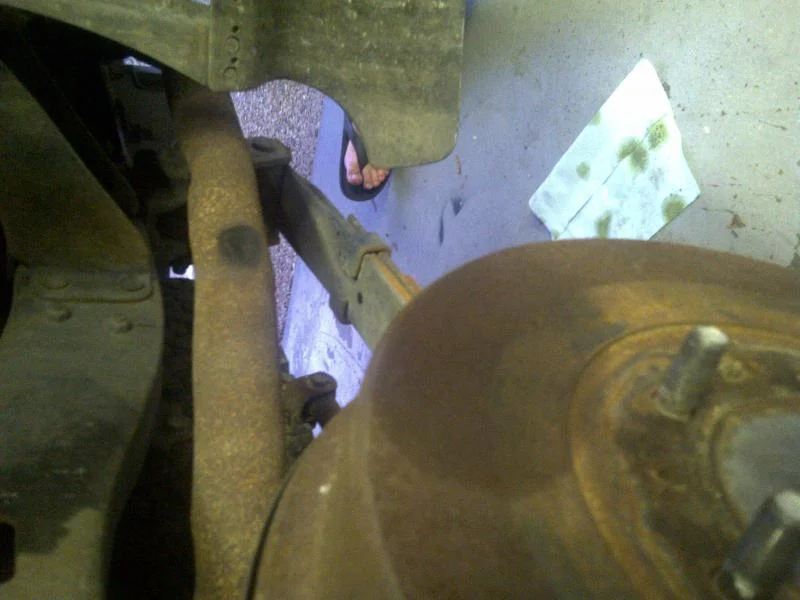

So, we were getting ready to do the rear bearings (since we decided that since it was not the front bearings it must be the rear), and as we were looking around I noticed a spot on the mufler pipe running by the wheel well that was worn smooth. Hmmm .... so, we pulled the mufler pipe to the side (temporarily tied it with some bailing wire), test drove it and .... problem solved. I guess we will still do the rear bearings since after 170k miles it can't hurt (and it is a good thing for my son to learn to do now while he still not relying on it as a daily driver).
As you might recall, the problem started right after we put new (slightly larger) tires on the truck, so, naturally this makes a lot of sense ... we just could not find it before.
So, thanks to everyone for their help. Funny how simply things sometimes are ... and how easy it is to mis-diagnose something and spend many hours doing a bunch of other stuff.

https://forum.ih8mud.com/attachment.php?attachmentid=513283&stc=1&d=1303181990

Bought sight unseen except for 50 or so pictures ( I know I know). Anyway all was as represented except for this rubbing noise while turning. After reading this post I crawled under her and low and behold. Rub marks on the inside of that brand new BFG AT on the drivers side rear tire and a rub mark on the exhaust pipe.
