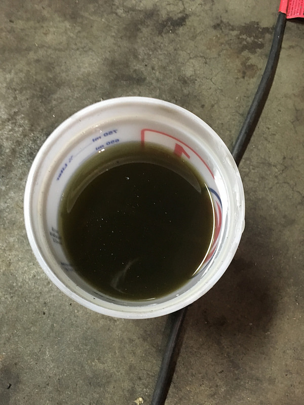

Well, I tried to bleed the brakes yesterday and ran into a couple hurdles. I used a "Motive" brake bleed system that worked great (if you also used speed clamps to keep the lid on the MC).
Rear cylinders bled just fine.
Then I moved to the LSPV. This is what came out :eek::
Not sure what that means, if the valve is rusty and not even doing anything? Really bummed about that nasty fluid and surprised as the cruiser is not really rusty or bad underneath.
Going to look into replacing the system with a Wilwood proportioning valve. But for now I will run it as is so we will see how bad the brake balance is.
Then I moved onto the front calipers..... Front left caliper would not bleed. Nothing worked. I removed the bleeder screw (with 15psi of pressure still in the system) and nothing. I could see corrosion/gunk in the hole. Bummer as these are new remans from Toyota. Good news is Onur is on it and shipping me a new one ASAP. :cheers: Front right caliper bled just fine with nice clean fluid.
So in the end its one step forward and one step back! I'll get this beast back on the road soon! :rolleyes:
When I was cleaning up all of the parts on the underside of my '89 FJ62 to swap everything over to my '86 FJ60, one of the filthiest parts I ran across was the LSPV. I took everything apart and cleaned it up real good on the outside, but didn't flush out the innards. I just finished installing all of the fuel and brake lines along the PS frame rail yesterday, so I have everything for the brake system in place, except for the axles. After seeing this, I'm curious as to what I'll find when I get to the point of bleeding my system.
I'll keep my fingers crossed yours is clean! The LSPV is discontinued so I think the only option is the wilwood or a questionable used LSPV.
I've found that normal driving without it is fine, except for hard panic stops where I lock up the rears, I have discs though so I don't know how that will go for you.
I'd delete it for the sake of simplifying and eliminating several feet of brake line. I made a thread on which fittings to plug how I did it.

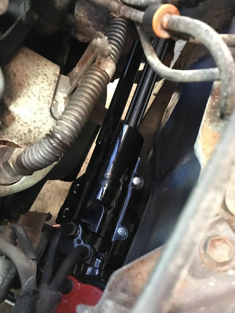

Put on the powder coated steering shaft protector. Shiny!

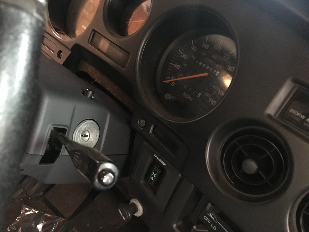

New steering column cover. Makes the rest of the dash look like crap.
