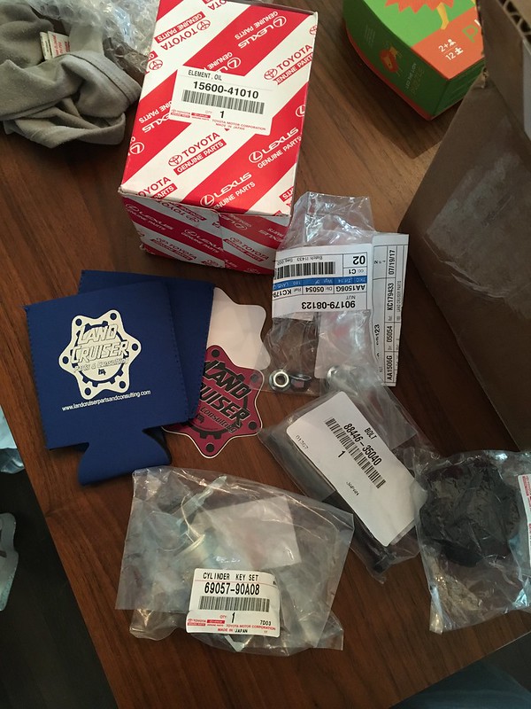

New AC components on there way thanks to @Coolstream in AZ. Getting a 14x26 parallel flow condenser to compliment the r134a. New compressor as well with new 134a compatible oil and a drier. I am not looking forward to tearing into the dash to tackle the HVAC!

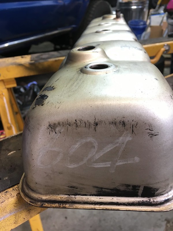

I don't know the history of this cruiser before my wife bought it so any little indications of its previous life intrigue me.

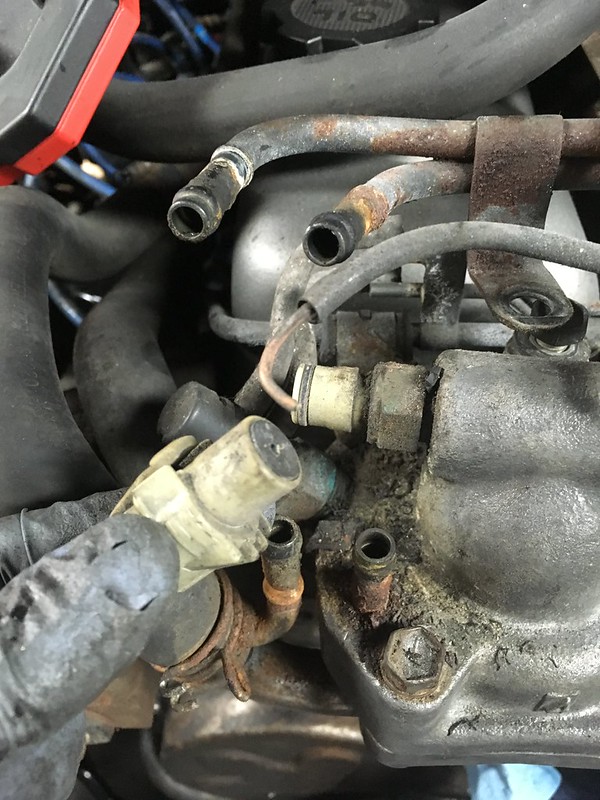

Found this number written on the back of the valve cover. Any ideas as to its origin or anyone else ever found a number written on the back of their valve cover?

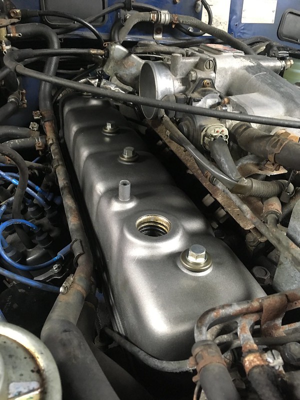

Painted and all buttoned up with all new parts courtesy of @beno

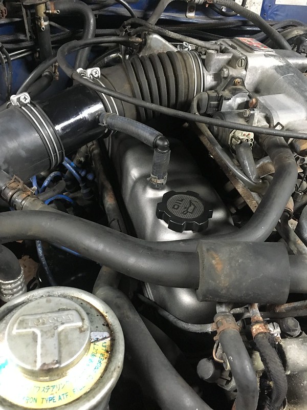

Buried under tubes

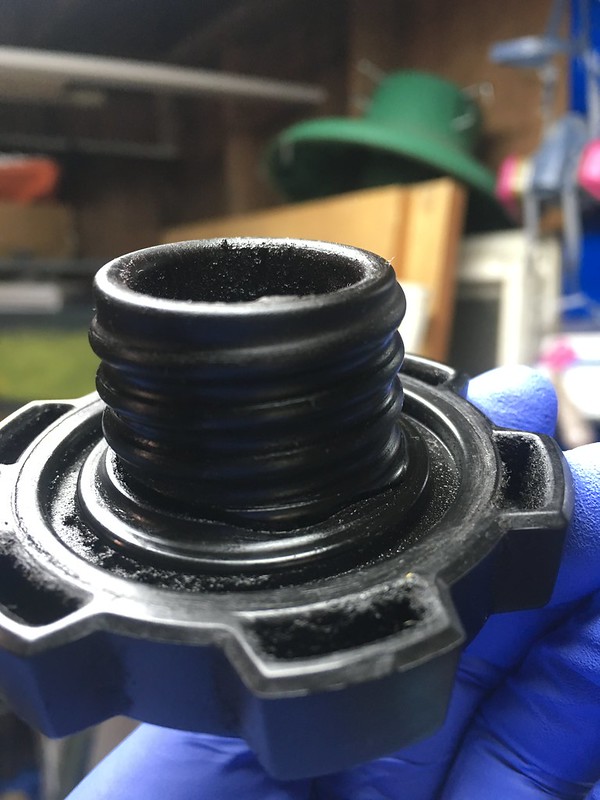

Also figured out I need a new oil cap! No gasket and a huge crack! I made a cork gasket to work in the mean time.
All the 3FEs I've taken apart have had those numbers on there. Both of mine were in the 400 range.

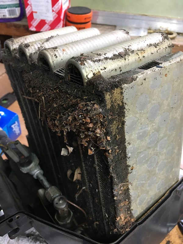

Had a little bit of time yesterday to get started on the AC refurbishment. Taking out the evap box was definitely a fine game tolerance but it made it out. Scared about trying to put it back in. All in all the system definitely needs new foam seals (ordered).

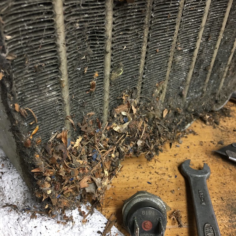

Opening it up revealed what I was expecting: years of dust, dog hair and leaves collecting:
The housing will get washed, foam patched and there is one small hole in the case that looks like someone hit it. That will get internally sealed. New evaporator, and switches will be installed as well.

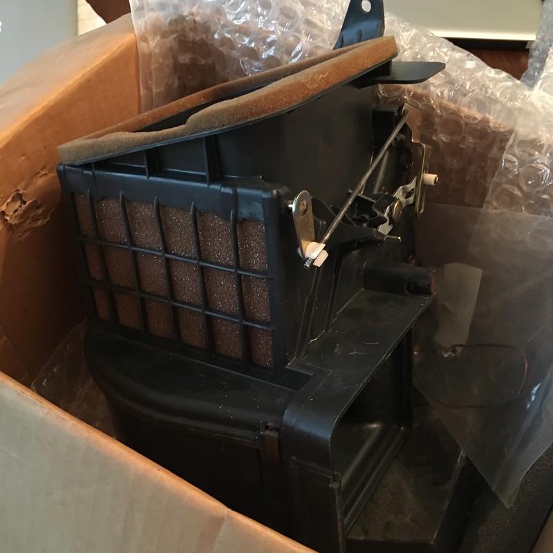

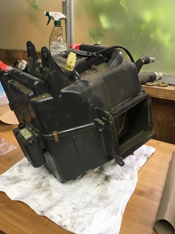

While the AC housing is out I am going to throw in this little gem: a NOS complete blower housing. The one in the cruiser needs to get refurbished. Need to replace the original foam seal at the top but the flap foam is in surprisingly good condition.

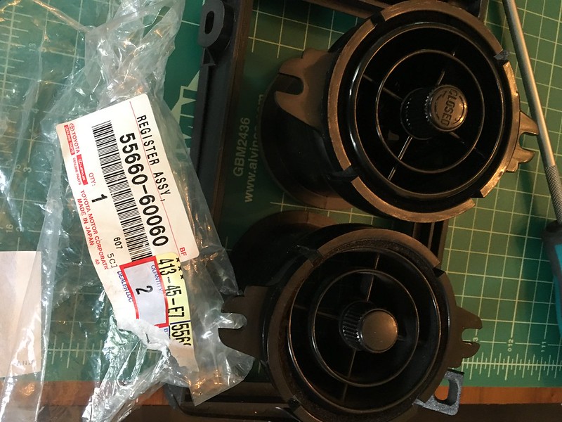

Been busy trying to finish it up whenever I get a free moment. Completed refurbishing the heating and cooling system. Front heater core was cleaned and pressure checked. The little o-rings were eliminated and the pipes were brazed to eliminate any future failure. All new foam throughout (Heater and AC system re-foam. What types work and where ) and all the AC components are new. All heater and cooling hoses were replaced, new water pump, clutch (fj80), thermostat, gaskets, grommets, bolts, belts, idler bearings, stainless steel hose clamps from @Racer65 , and stainless steel thermostat housing bolts from @davework . Cleaned up the crappy old radio wiring (hopefully I didn't screw it up). Replaced the fuel gauge and swapped in LED lights throughout the dash cluster. New adjustable vents from @beno as well as many other parts I had been hoarding for this project.
Vent:

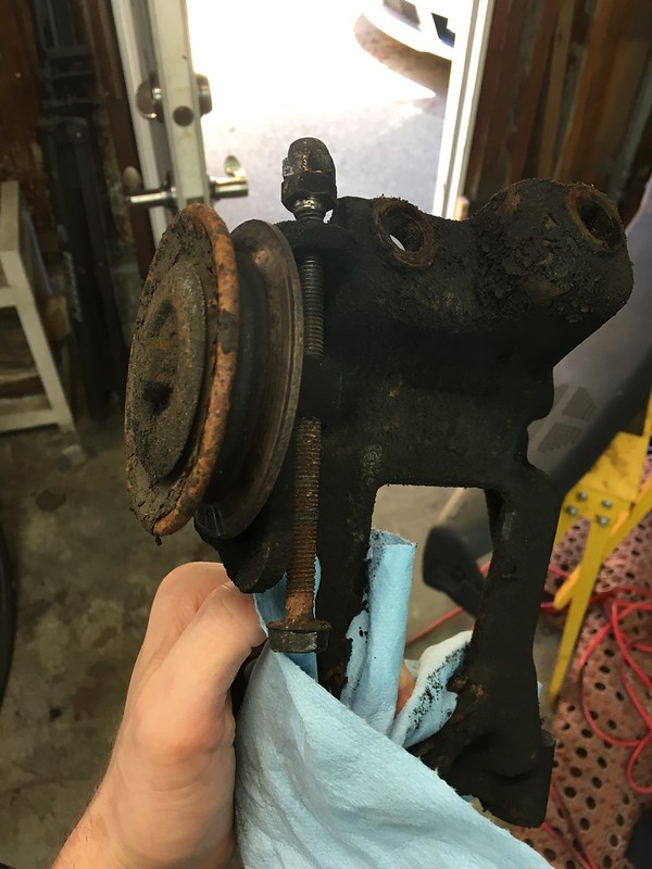

Crusty old pulley:

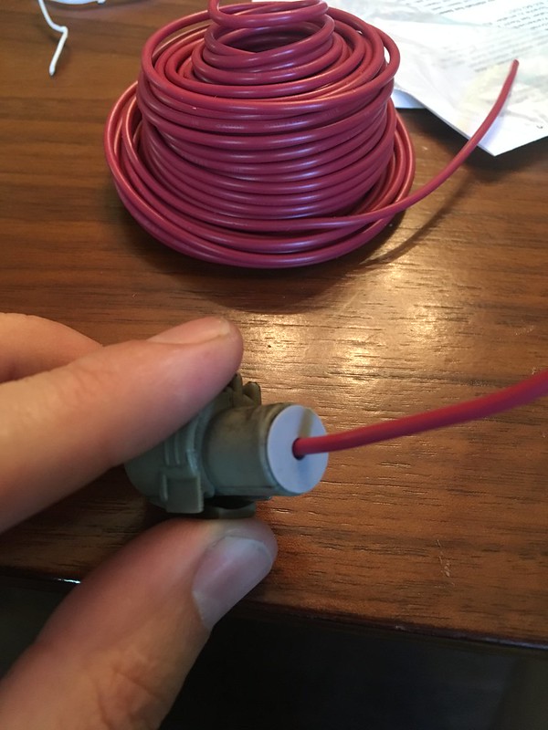

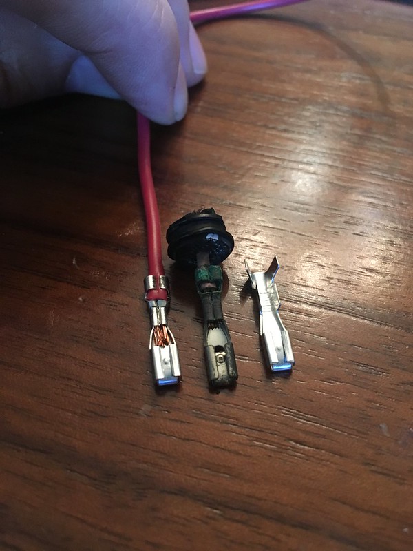

Want to give props to @Coolerman for helping me out big time. One of the wires on a temp sensor was brittle and snapped right at the connector:
I PM'd @Coolerman and he was willing to help and sent me the parts to repair the connector! :cheers:Great guy and he has more of these terminals if any other FJ62 owners need them:
Back in business!
