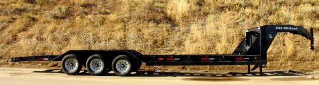

I've been looking around for something in the 24 to 28' range, preferably dovetail, around 10K + capacity, something loosly like the one in the pic. What are those of you with similar set ups using, length, load capacity, name brand, etc? Any advise is much appreciated.

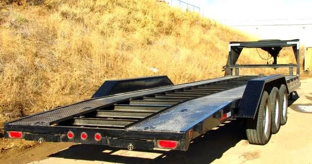

I just had a 30ft low boy car hauler made. Three 7k axles (8 lug) with brakes on each. It has a open center with steel runners where the tires go. Dove tail with stow away ramps.
I am really happy. It weighs about 4200 lbs. Before I had a all steel deck 36ft trailer that weighed about 6500 lbs. It was a lot of trailer to lug around. The weight savings on the new one was well worth it.
I would get a low boy with drive over fenders. The lower center of gravity makes a big difference.
I had the trailer custom built in OK and had the whole think powdercoated. I will takes pics tomorrow.

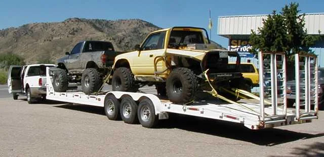

Here is a picture of the old setup. The POS Ford is gone too.

That is true. Between fender clearance is 83". With the new trailer (will post pics tomorrow) the fenders are made from 1/8" diamond plate and re-inforced, so you can drive or park on them if need be.

Poser, that's a hell of a tow rig. What's the length on the 5th wheel trailer with the maroon FJ40 and rock buggy on it, being towed by the Dodge 2500, something a good 6-10' longer would be great, I'd think.

Here are two pictures of mine. Cost was about $5500 couple of months ago (read high steel prices). The whole trailer is powdercoated instead of painted. Last a lot longer. Build to spec exactly the way I wanted it. I goofed some of the positions of the tie-downs on the rails, but I can fix that. I also had them add those receivers in the front that accepts a cradle mounted winch for towing dead trucks onto the trailer. With 3 x 7k (8 lug) axles, and a weight of $4200 lbs, it can carry way more than what I need to put on it. I speced the axles like that so in a pinch I can swap wheels with my tow truck. Runs the same size tires (245/75/16) in a E rating.
I bought it from Terry's trailers in OK. They are much cheaper than anyhting I have been able to locate here in Denver. Not much of a website, but really good to deal with. I have bought about 6 different trailers from them.
http://www.terrystrailers.com/
I have no requirements to load equipment and such. Just 4x4's so that I why I had it built this way. It is very stable. I tow with a 04 Chevy DMax Crew Cab short box and have no problems. Brakes on all three axles.
