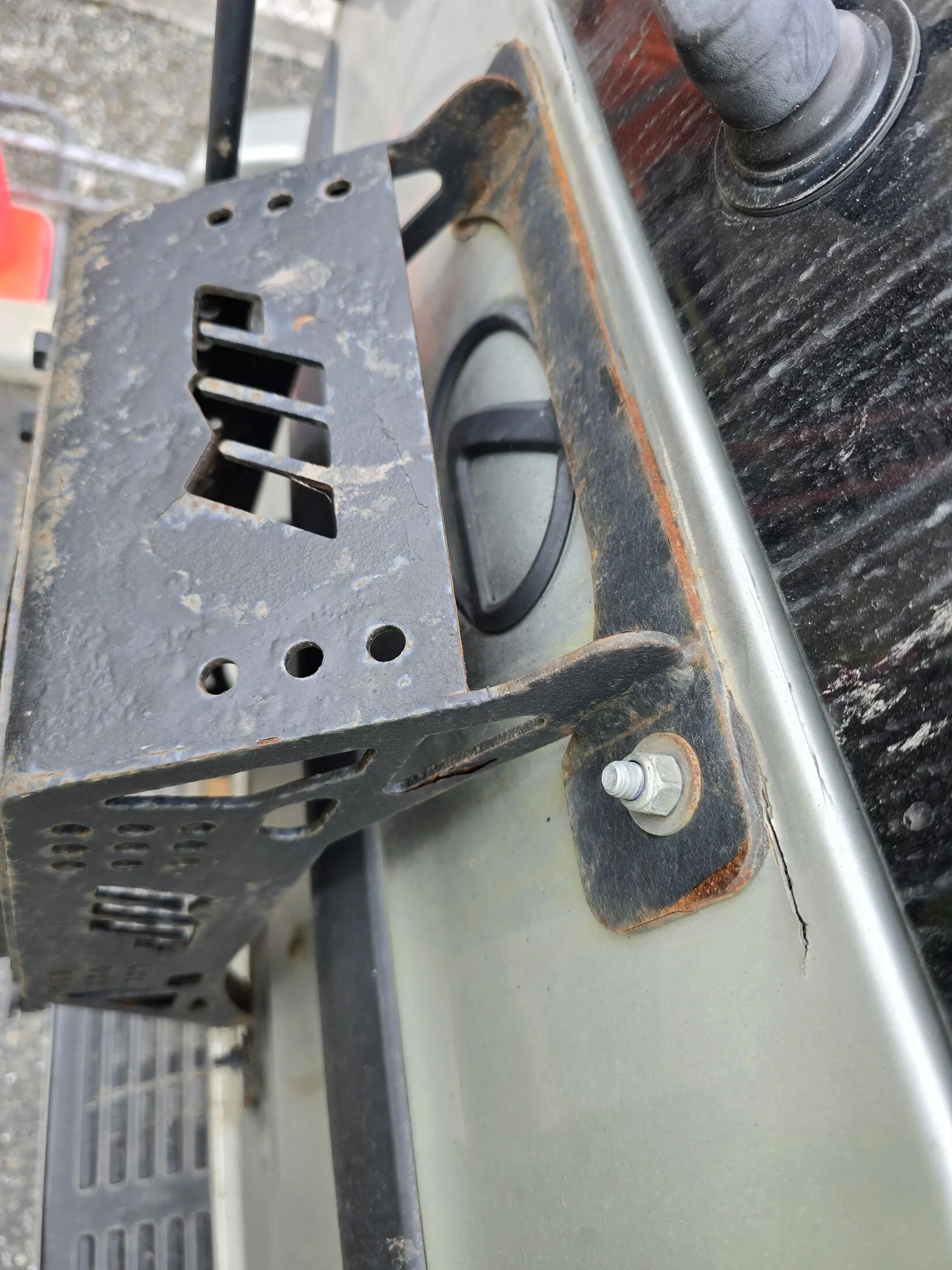

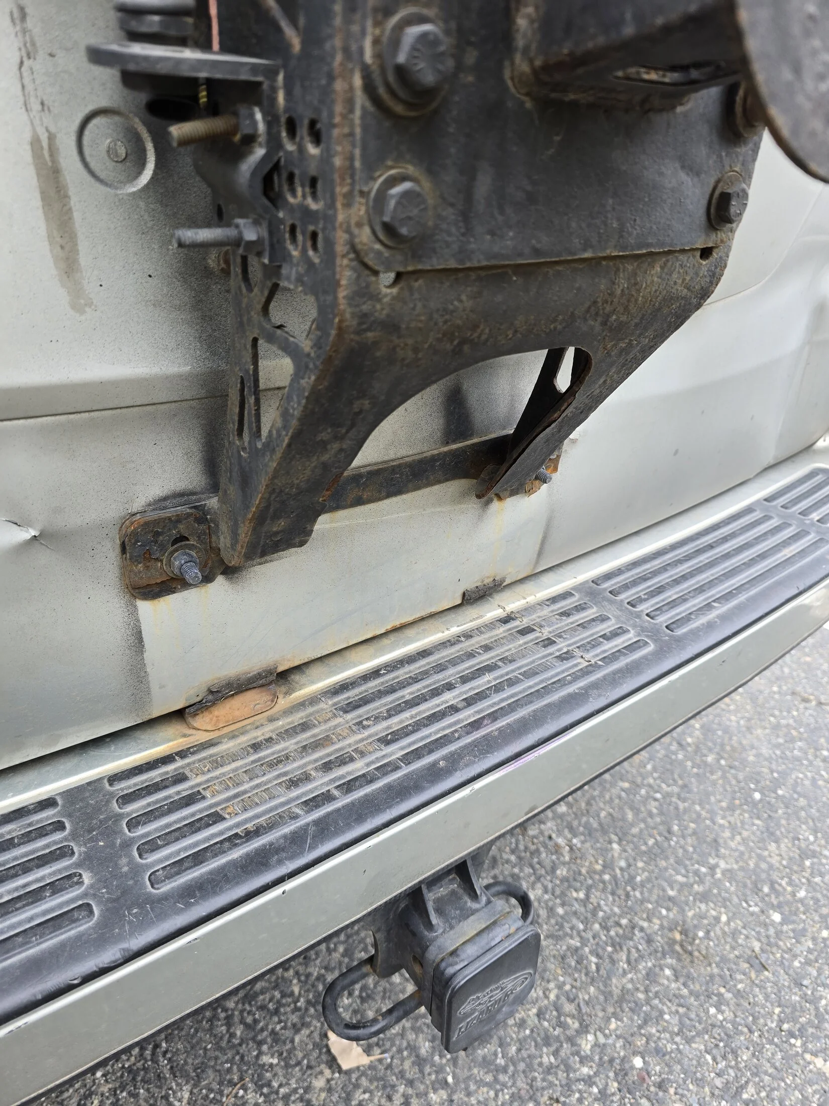

She's done now. The lower tab finally sheared off. The door is trashed, tearing apart at the top connection and smashed in at the lower section. I've got a new door in the shop, I won't be doing a door mount tire again.
I have the same carrier and have had it on a year now. Did your kit attach to both the inner and outer door skin or just the outer? Out of curiosity what size tire were you running?
I wanted door mount tire carrier for convenience but always worry about this. I end up building my own spare tire carrier and glad I did it.
Caught mine early. Just installed their bumper mounted swingarm. A little more inconvenience, but there is no more weight on the door.
Thanks for posting. I was pretty sure I'd go swing out but this confirmed it.
I'm running 265/70s and have the newer kit with the additional bracing so I hope it doesn't meet the same fate but I will keep a closer eye on it now. Is this the factory powder coat or did you paint it yourself?
Factory powder coat. It peeled off in a bunch of places in a couple years, I wire brushed it in spots and rattle canned it
That's pretty unacceptable if you ask me. I got it raw and painted it myself. I hope my DIY back yard paint job holds up better. I don't think I will purchase anything else from them considering your experience.
