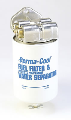

I am working on parts for my fuel delivery. My question is on fuel filters. My idea is to run a large canister fuel filter/water seperator as a prefilter before a Master E8153 external electic fuel pump and then into an inline filter. Will the pump be able to pull through the canister prefilter? I want to run this to hold some extra fuel before the pump. What setups is everyone running?
Here is a pic of said filter PRM-81794:
