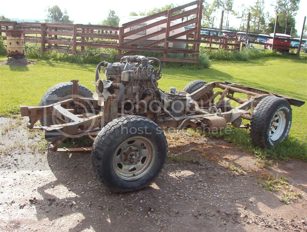

So...take a look at this original setup. This was a standard glow system (late 1980 / 1981 model bj42) like mine.
Notice the waterpump pointing driver side - and the thermostat housing pointing passenger. THIS is exactly how mine will be in the end, with 20.5v glowplugs.
Sorry... to clarify, that is a perfect example of the pre1981 MY Spec BJ4x. I say that because the Top Rad hose goes right (vs. left) from the thermostat to the rad. The lower hose on the water pump is always on the left side regardless of year, but there is a difference in the bypass IIRC. In this case, it is a 1981 MY buts still has the 1980 spec stuff on it. Sometime between 11/80 and 2/81, they made the changeover on my JDM.
