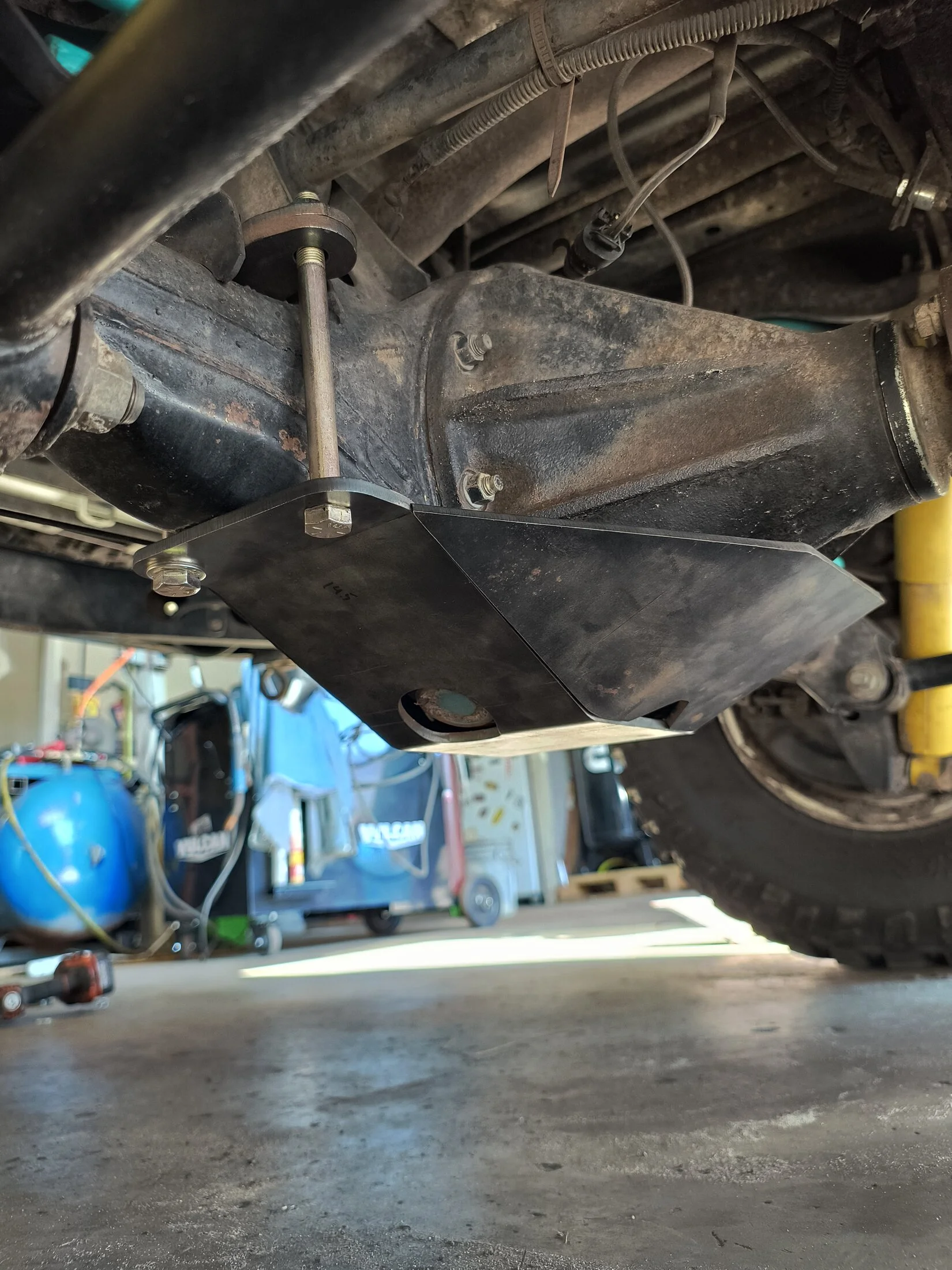

Working on a couple prototypes for bolt on front and rear diff armor. Made out of 1/4" steel. These are good insurance pieces. Easy to install, still have access to the drain and fill plug, works with the factory drag link and sway bar.
I'm waiting on some ubolts to come in for final fit, still playing with design ideas too. Open for suggestions, comments. What say you!?

I’m in! Be interested in seeing them fully installed with the bolts.
I would take a set !
One suggestion is if you can incorporate a pinion guard into the rear diff skid, i always seem to find myself putting that right next to rocks.
@GGM any updates yet on these?
I’m sure it doesn’t need to be said but designing so you get the smallest reduction in ground clearance possible. 👍
