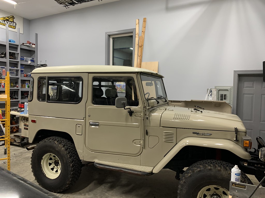

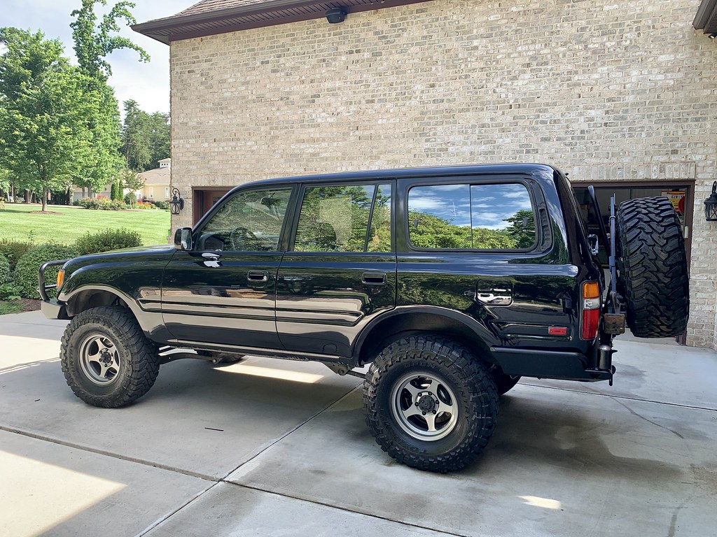

Awesome I appreciate it. I’ve also heard of the add-some-foam route. Looks like where I am heading. What are you driving around Denver in ?? I’m down McConnell road by Webbs Chapel church
Westport... Just around the corner from you. Lake Shore Rd. S.
Nice. I see A few 80s and 100s around town and one other LX450. (Now my buddy had one too). Definitely a family that drops off kids at Rock Springs that has at least 2 Cruisers (maybe you guys). Nice to know someone is close
